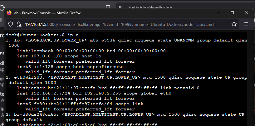

      I got 3 Vlans ( Vlan30 (192.168.2.1 - 192.168.2.100) - Vlan40 (10.10.5.1 10.10.5.100) - Vlan50 (10.10.2.1 - 10.10.2.100) and my LAN (192.168.1.1 - 192.168.1.100)
      The proxmox server is on my LAN (192.168.1.5 static IP)
      One CT is a ubuntu server on Vlan30 (192.168.2.7 static ip)

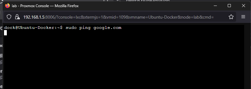

      when I enable the rules the ubuntu server (Vlan30) cant ping google.com but i can ping 8.8.8.8

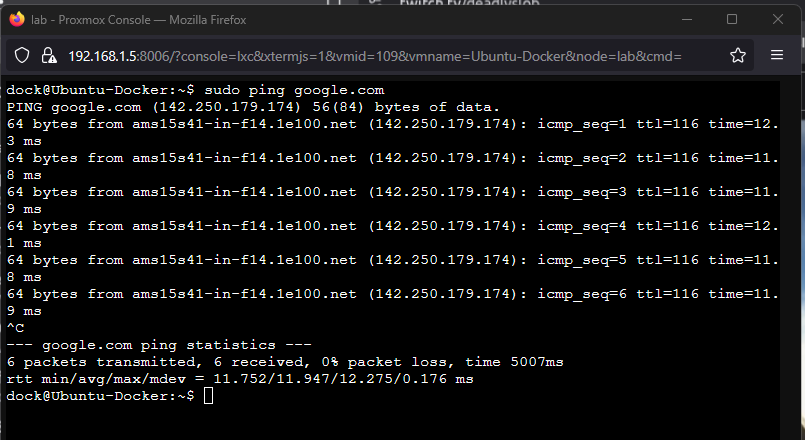

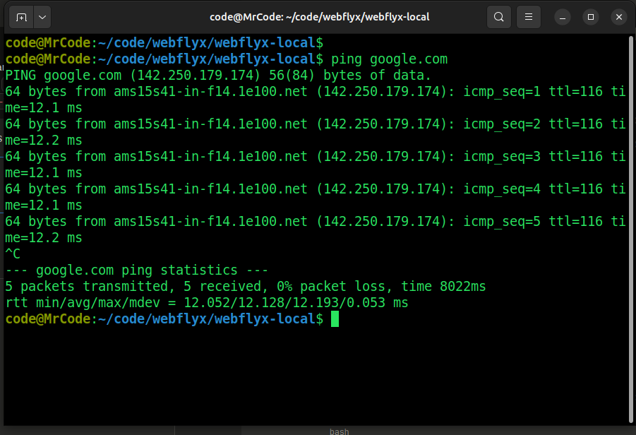

          If i disabel the rules in the firewall
          Yes the ping the same IP or resvole to the same ip
          Server ping google
          Server IP

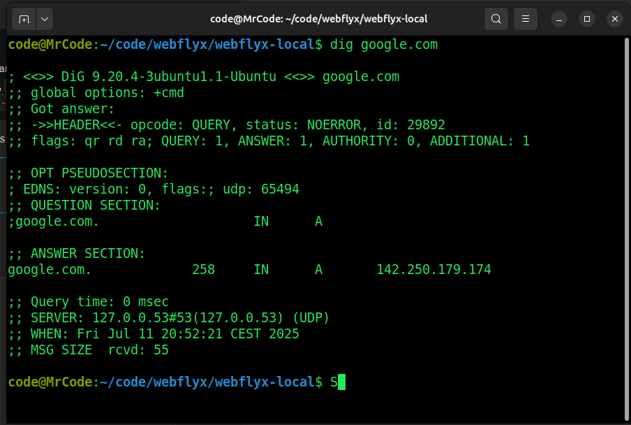

          Client ping google
          client ip
          Server IP
          Server IP
          Client IP
          client ip
          Rules
          With firewall rules
          Server

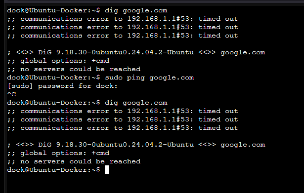

            I'd expect, that it at least resolves the host name, but it presumably can't.
            Maybe it uses another local DNS server, which it is not permitted to access then.
            Try dig to verify.
            dig google.com
              John_McNoob @viragomann
              @viragomann
              From the server
              Server
              From client
              Client

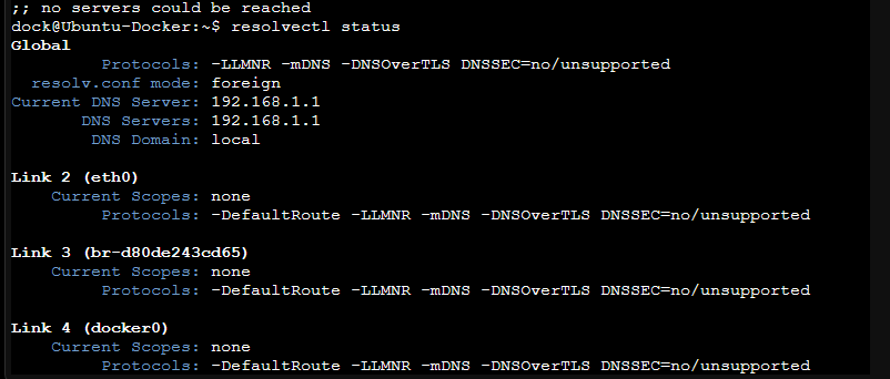

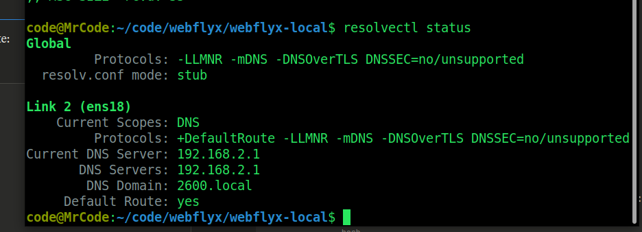

                John_McNoob @John_McNoob
                @John_McNoob
                I found the issue ( or i think so)
                Client DNS
                Client
                Server DNS
                Server
                Then i have to find out why they diffrent DNS
                Tnx so much for the help :)
