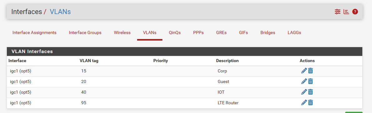

        Second, if the question is whether you can create a port on a pfSense box that can process multiple VLANs as separate subnets, the answer is yes. For example, I have a physical port, igc1, carrying 4 tagged VLANs and an untagged one between pfSense and the downstream switch fabric. pfSense routes for all of them.
        The four tagged VLANs are all tied to igc1 (so, igc1.15, igc1.20, etc.) under Interfaces>VLANs as shown in the first pic. A pfSense Network Port is created for each. Once created, each can be assigned to an Interface and configured with subnets and addresses under Interfaces/Interface Assignments, have DNS, DHCP, Firewall, etc., just like a physical interface. That's the second pic (black boxes to reduce the distraction of the box's other interfaces). So, 4 tagged VLANs plus 1 untagged on a single port. The untagged interface is igc1.
