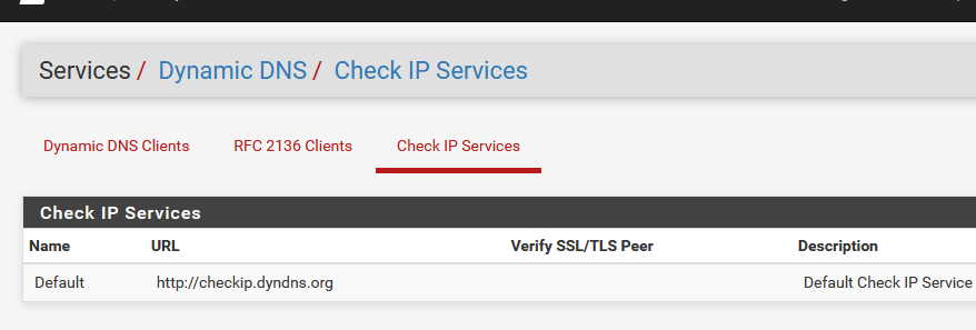

          What pfSense does at that moment : it visits the URL : you can see it here :
          even better : you can use this URL yourself and see what it shows :
          and the IP shown should be your WAN IP. It's the server that creates "the web page", that sends back the page request to the IP known by the server, your WAN IP.

                Or, the other favorite problem could be : your LAN device, where you use "http://checkip.dyndns.org" in a web browser, it shows the IP as the browser on your PV could use another DNS server, which is not pfSense.
                The best test method will be : console or SSH into pfSense, use menu option 8 and then
                [25.07-BETA][root@pfSense.bhf.tld]/root: curl http://checkip.dyndns.org
                <html><head><title>Current IP Check</title></head><body>Current IP Address: 82.127.xx.108</body></html>
                which tells me that pfSEnse has a working DNS, as it has to resolve "checkip.dyndns.org" before it can connect to it.

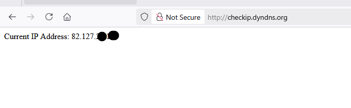

                    @Gertjan I used a browser to go to "http://checkip.dyndns.org" and it came back with the correct IP assigned by my ISP.
                    I then ssh'ed to the pfSense, and ran "curl http://checkip.dyndns.org" from the cli. It also came back with the proper IP address.

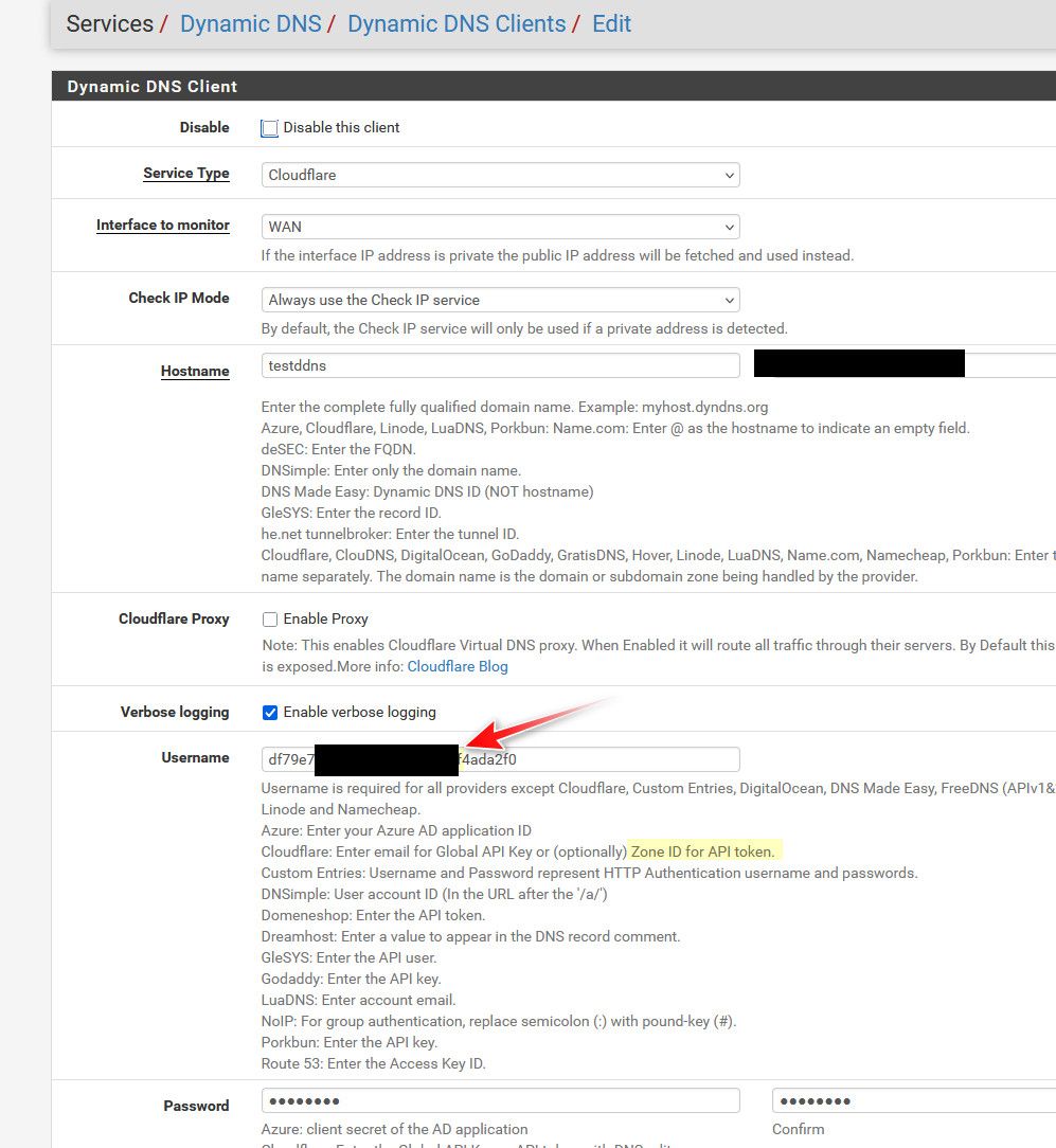

                      • GertjanG Online
                        Gertjan @70tas
                        @70tas said in Dynamic DNS (DDNS) fails to obtain public IP:
                        Ok, so pfSense 'can' check if needed.
                        Some reasons why it could fail :
                        Check the exact moment when "/services_dyndns_edit.php: Dynamic DNS (ingress.70tas.us) There was an error .... " showed up
                        Now check also the Status > System Logs > System > DNS Resolver log.
                        Do you see any "notice: Restart of unbound 1.23.0." and "start of service (unbound 1.23.0)." at or around the moment of the "services_dyndns_edit.php" ?
                        After all, an URL has to be resolved first, and if DNS is not present at that moment, you have your issue explained.
                        Same thing : check the system log. Was the WAN interface going down and up at that same moment ? When the WAN is temporary down, it will fail.
                        7 1 Reply Last reply Reply Quote 0

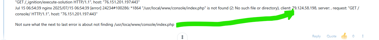

                            Not sure what the next to last error is about not finding /usr/loca/www/console/index.php
                            Look two lines up, you posted yourself where that request came from :
                            Who is this 79.124.58.198 ? you've Bulgarian friends ?
                            Did you really open up the WAN interface ?? [ 😢 ]
                            Same thing for 198.135.51.111, 96.126.104.20 etc dono what the entire Internet is doing against your pfSense GUI, consider that as 'bad' practice.

                              Yes I did open 443, so I can get in. 76.151.201.197 is my assigned IP. I can get it via curl and use it to connect temporarily. 76.151.xxx.xxx is my current outbound NAT.
                              79.124.58.198 is 4vendeta.com a Communication provider, which looks like I am currently hopping from. However, I am still concerned that it cannot find /usr/loca/www/console/index.php. Any ideas?

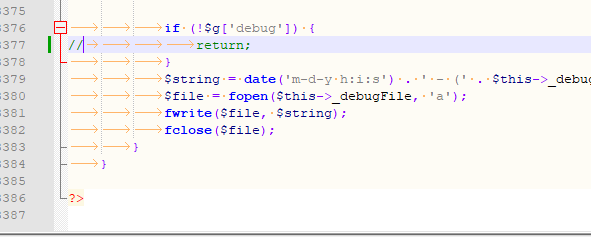

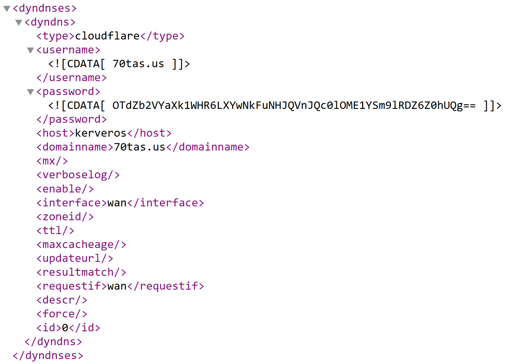

                                  • GertjanG Online
                                    Gertjan @70tas
                                    more logs available as to where the (dydns) service is failing
                                    You checked : Services > Dynamic DNS > Dynamic DNS Clients > Edit :
                                    Plan B :
                                    According to the documentation there is a debug mode.
                                    See here : the source.
                                    Go to line 3377.
                                    Place '//' in front of the return; statement.
                                    Save.
                                    From now on, according to line 239, there will be a log file here /var/etc/, the filebname starts with with "dyndns_" that will contain the debug info.
                                    Don't forget to remove the '//' when your done.
                                    • 7 Offline
                                      70tas @Gertjan
                                      @Gertjan Thanks for the help. A '//' on that line, which is the end of the conditional crashed the app. I placed a '//' on each of the lines in the conditional, but I do not see any log files in the stated directory. I will have to read the script again to try to figure out where it puts the output; however, I'm a bash guy, so we'll see.
                                      Thanks again.
                                      Tas

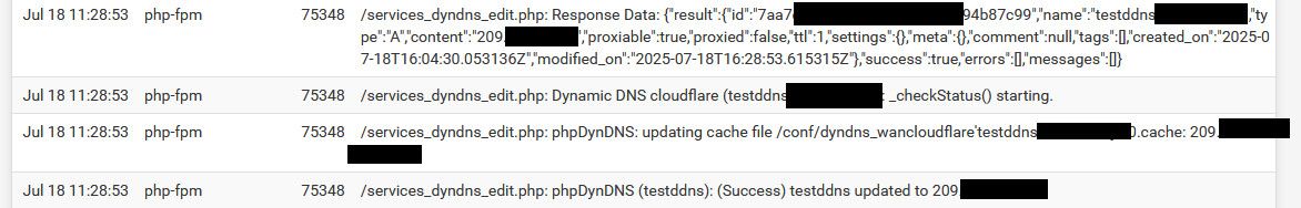

                                        I did found a log file now :
                                        but not very helpful - it contained just one line :
                                        07-17-25 03:15:27 - (6013287) - [freedns2] - 82.127.26.108/1752758073
                                        let's say that's ok because "all went well".
                                        edit :
                                        bash ? That' way to complicated.
                                        This is PHP, which is somewhat comparable to BASIC.

                                          Ok, so the equivalent line on my 2.8 is 3369.
                                          No errors this time, but I can't find a log file. I searched the entire file system.
                                          Tas
                                          • GertjanG Online
                                            Gertjan @70tas
                                            @70tas
                                            If one is created, its in /var/etc/
                                            If none is created, the the update was deemed not necessary, and was skipped.
                                            You can force an update of course. Delete the 'cache' file, you'll find it in /cf/conf/ - and the file starts with dyndns.... and end with dot cache.
