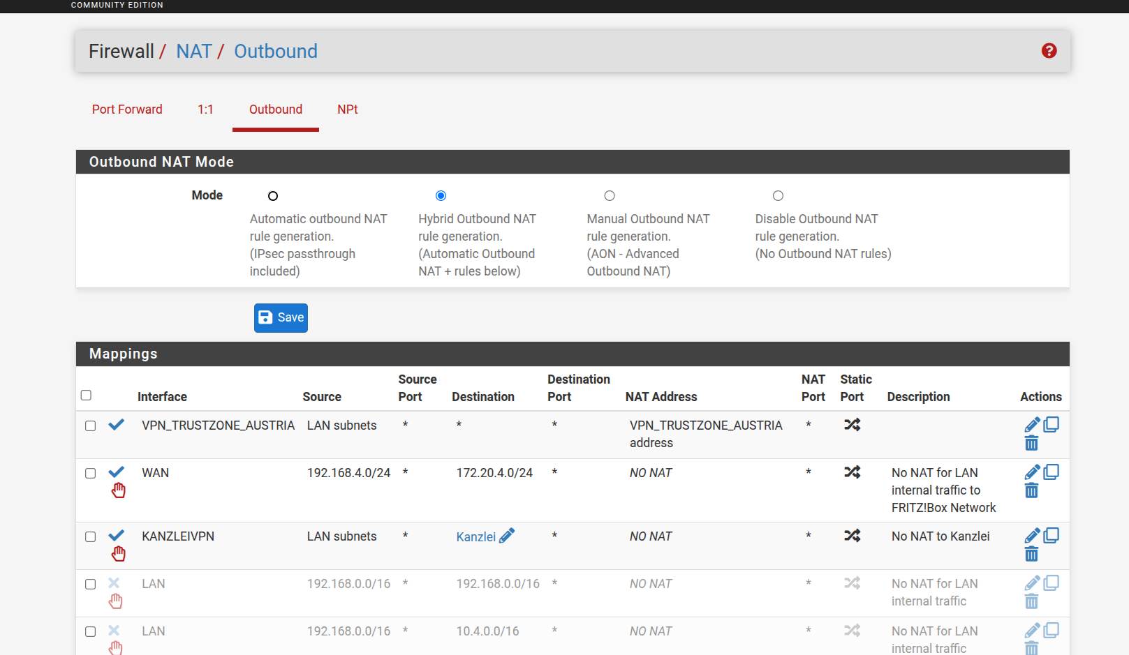

        I have a screenshot from that mentioned NAT rule:
        VPN_TRUSTZONE_AUSTRIA sits on that opvnc4 = openvpn-client
        I didn't write that rule and I can't tell if it's correct or not.
        The goal: everything should go out from that external VPN-tunnel-IP ... it looks fishy to me that way.
