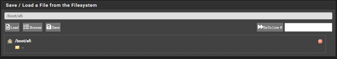

      I was just trying to update to 2.8.0 from 2.7.2 and it failed at the very end. When trying to research the error of not enough diskspace, I came across several posts with this issue for people having problems going from 2.7.0 to 2.7.2. Thankfully I did not run into those when I did that upgrade. However, it now seems I have run into the issue with this upgrade. When I tried to troubleshoot using the methods in one forum post for the 2.7.2 upgrade, I started digging around to see if my /boot/efi/ survived. When use the Edit File tool, I find there is nothing in that directory:

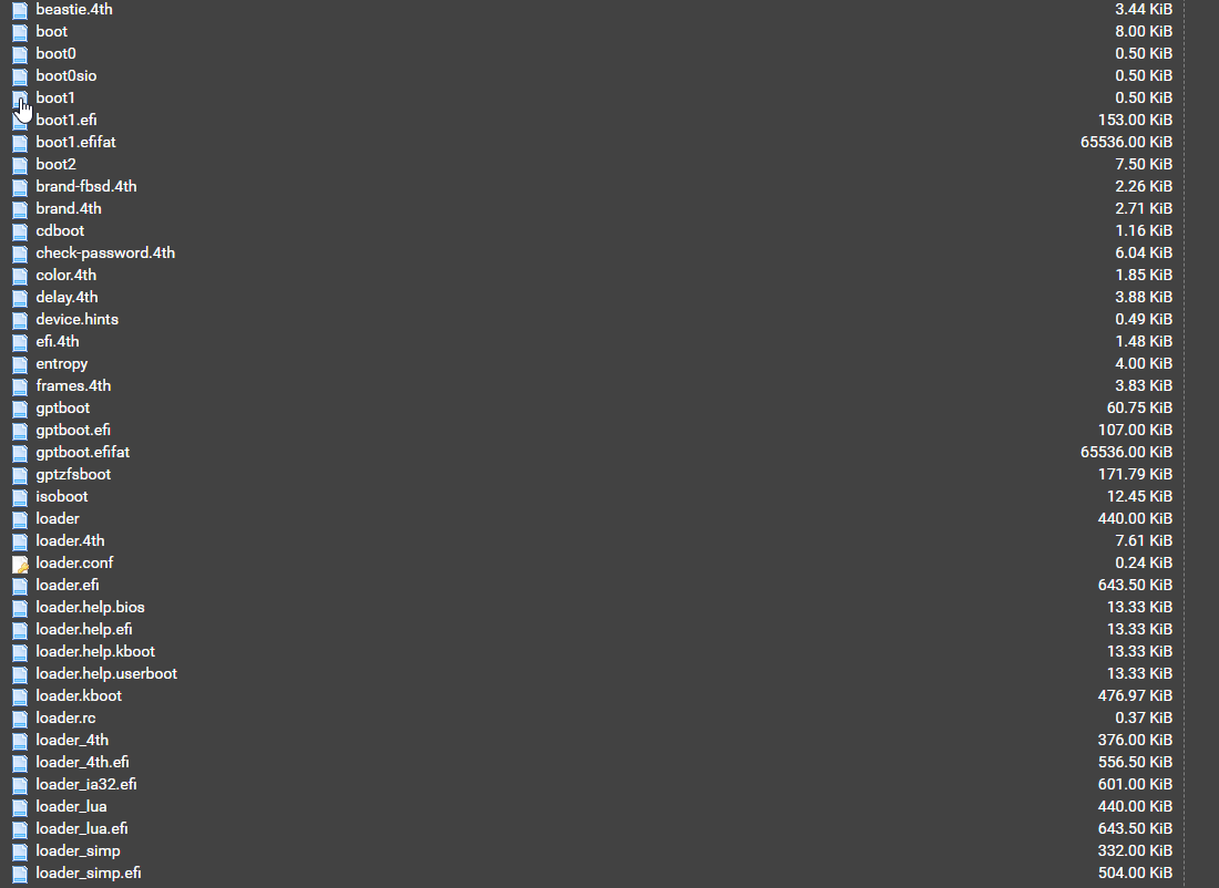

      If I go up one level, I see several .efi files there:

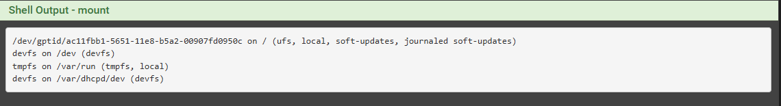

        UPDATE: Looks like the mount point for /boot/efi may not be present. After running the mount command all I see if the following:
        2025-07-19 17_09_57-Baal.localdomain - Diagnostics_ Command Prompt - Brave.png
        Honestly I am not even certain where /boot/efi should be mounted and don't want to start changing things and make things worse.

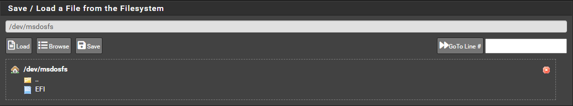

          Another UPDATE: As I have been digging through forums, I keeps seeing a reference to /dev/msdosfs/EFISYS as to where /boot/efi should be mounted. Unfortunately I do not find this on my system. In /dev/msdosfs all I currently see is what appears to be an EFI file:
          This file can't be openedwithin the GUI.
