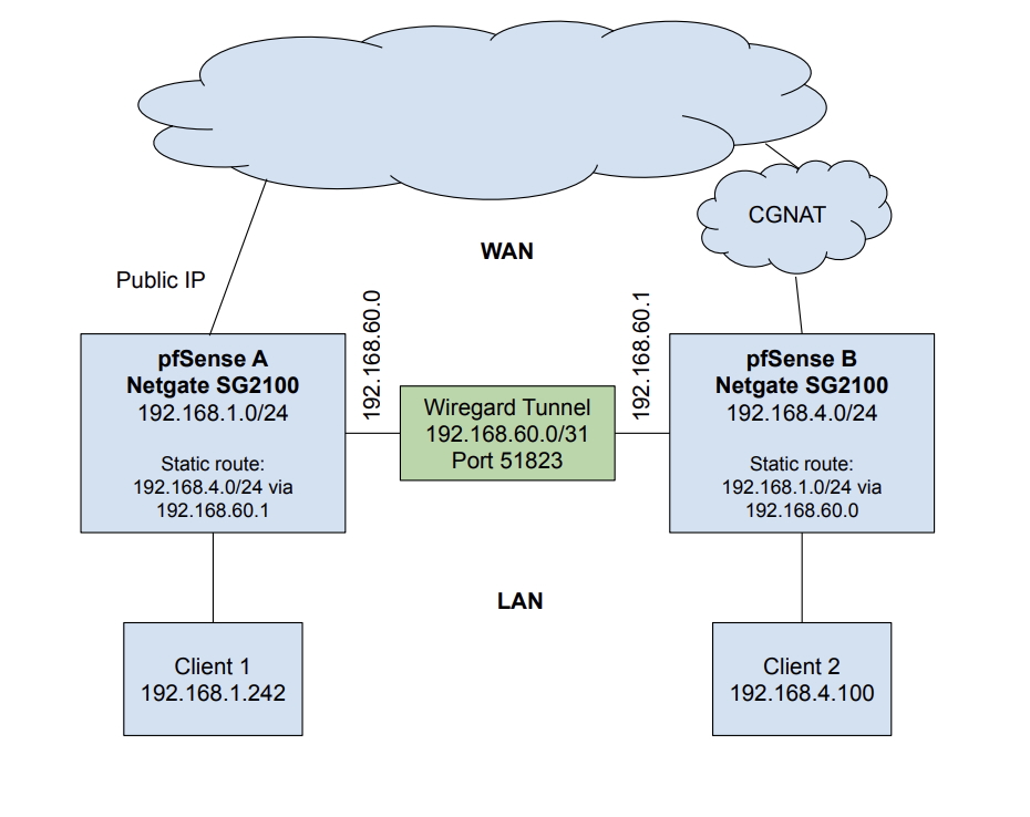

      In the past I have successfully set up a few Wireguard site to site tunnels using Netgate routers but always where both ends have public IPs. For a new site I am working on I am stuck with a CGNAT telco connection on one end. I set up the tunnel as normal and all looks good: the tunnel handshake status is good and I can ping the routers in either direction. But if I try an HTTPS connection e.g. to the pfSense console it only works in one direction.
      Does anyone know a) is it possible to get a setup like this to work? b) if so then what do you think I have missed? My understanding is that it should work but is there something extra needed to get TCP type connections to work through the tunnel where there is CGNAT?
      Here is a diagram of my setup and what I have verified:
      • client 2 can ping pfSense A
      • client 1 can ping pfSense B
      • tunnel status is good from both A & B ends
      • client 2 can connect via HTTPS to pfSense A console
      • client 1 cannot connect to pfSense B via HTTPS
      Network Diagram
      • P Offline
        prot0type @prot0type
        Here is the diagram:
        alt text

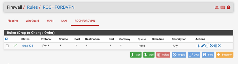

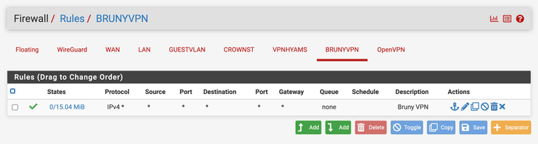

            @patient0
            Yes, have created interfaces, these are called BRUNYVPN and ROCHFORDVPN, firewall settings below.
            When I try packet capture on the tunnel at pfSense B I don't see anything from client 1 but I do see port 443 traffic from client 2 to pfSense A as expected. Any idea how come the ICMP traffic gets through and the TCP traffic doesn't?
