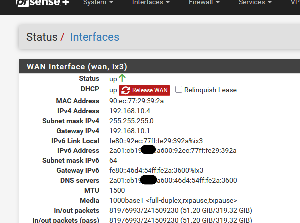

              If this is your WAN IPv6 :
              @jarmo said in Should my dhcpv6 clients also get a /64 address?:
              c::100a
              then the 'c' or ......:xx0c:.... for the LAN can't be possible.
              0c will be prefix number 'c' or 12 out of a 256 range (from 00 to ff or 256).
              So, '0c' is taken for you WAN - actually one IPv6 use out of the 2^64 ( ^^)
              As you said : that unexpected.
              edit : humm, I wasn't typing fast ...
              Normally, at the WAN interface you would have a IPv6 like this :
              '00' means prefix '0'.
              On the tracked LAN interface I have :
              with prefix 'e2'.

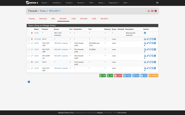

                    Firewall rules for WVLAN11:
                    • JKnottJ Offline

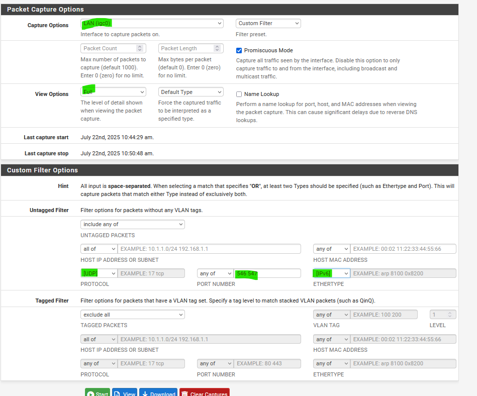

                                I asked my NAS to renew its Ipv6 lease :
                                10:49:34.954022 00:11:32:a7:d5:88 > 33:33:00:01:00:02, ethertype IPv6 (0x86dd), length 129: (hlim 1, next-header UDP (17) payload length: 75) fe80::211:32ff:fea7:d588.546 > ff02::1:2.547: [udp sum ok] dhcp6 solicit (xid=123d36 (client-ID hwaddr type 1 001132a7d588) (option-request DNS-server DNS-search-list) (elapsed-time 0) (Client-FQDN) (IA_NA IAID:849859976 T1:3600 T2:5400))
                                10:49:34.954799 90:ec:77:29:39:2c > 00:11:32:a7:d5:88, ethertype IPv6 (0x86dd), length 207: (hlim 64, next-header UDP (17) payload length: 153) fe80::1:1.547 > fe80::211:32ff:fea7:d588.546: [udp sum ok] dhcp6 advertise (xid=123d36 (client-ID hwaddr type 1 001132a7d588) (server-ID hwaddr/time type 6 time 753711221 90ec7729392a) (IA_NA IAID:849859976 T1:6750 T2:10800 (IA_ADDR 2a01:dead:beef:a6e2::c2 pltime:13500 vltime:21600)) (DNS-server 2a01:dead:beef:a6e2:92ec:77ff:fe29:392c) (DNS-search-list bhf.tld.) (Client-FQDN))
                                10:49:34.955219 90:ec:77:29:39:2c > 00:11:32:a7:d5:88, ethertype IPv6 (0x86dd), length 207: (hlim 64, next-header UDP (17) payload length: 153) fe80::1:1.547 > fe80::211:32ff:fea7:d588.546: [udp sum ok] dhcp6 advertise (xid=123d36 (client-ID hwaddr type 1 001132a7d588) (server-ID hwaddr/time type 6 time 753711221 90ec7729392a) (IA_NA IAID:849859976 T1:6750 T2:10800 (IA_ADDR 2a01:dead:beef:a6e2::c2 pltime:13500 vltime:21600)) (DNS-server 2a01:dead:beef:a6e2:92ec:77ff:fe29:392c) (DNS-search-list bhf.tld.) (Client-FQDN))
                                10:49:35.965351 00:11:32:a7:d5:88 > 33:33:00:01:00:02, ethertype IPv6 (0x86dd), length 175: (hlim 1, next-header UDP (17) payload length: 121) fe80::211:32ff:fea7:d588.546 > ff02::1:2.547: [udp sum ok] dhcp6 request (xid=ac6158 (client-ID hwaddr type 1 001132a7d588) (server-ID hwaddr/time type 6 time 753711221 90ec7729392a) (option-request DNS-server DNS-search-list) (elapsed-time 0) (Client-FQDN) (IA_NA IAID:849859976 T1:3600 T2:5400 (IA_ADDR 2a01:dead:beef:a6e2::c2 pltime:7200 vltime:7500)))
                                10:49:35.968124 90:ec:77:29:39:2c > 00:11:32:a7:d5:88, ethertype IPv6 (0x86dd), length 207: (hlim 64, next-header UDP (17) payload length: 153) fe80::1:1.547 > fe80::211:32ff:fea7:d588.546: [udp sum ok] dhcp6 reply (xid=ac6158 (client-ID hwaddr type 1 001132a7d588) (server-ID hwaddr/time type 6 time 753711221 90ec7729392a) (IA_NA IAID:849859976 T1:6750 T2:10800 (IA_ADDR 2a01:dead:beef:a6e2::c2 pltime:13500 vltime:21600)) (DNS-server 2a01:dead:beef:a6e2:92ec:77ff:fe29:392c) (DNS-search-list bhf.tld.) (Client-FQDN))
                                10:49:35.970710 90:ec:77:29:39:2c > 00:11:32:a7:d5:88, ethertype IPv6 (0x86dd), length 207: (hlim 64, next-header UDP (17) payload length: 153) fe80::1:1.547 > fe80::211:32ff:fea7:d588.546: [udp sum ok] dhcp6 reply (xid=ac6158 (client-ID hwaddr type 1 001132a7d588) (server-ID hwaddr/time type 6 time 753711221 90ec7729392a) (IA_NA IAID:849859976 T1:6750 T2:10800 (IA_ADDR 2a01:dead:beef:a6e2::c2 pltime:13500 vltime:21600)) (DNS-server 2a01:dead:beef:a6e2:92ec:77ff:fe29:392c) (DNS-search-list bhf.tld.) (Client-FQDN))

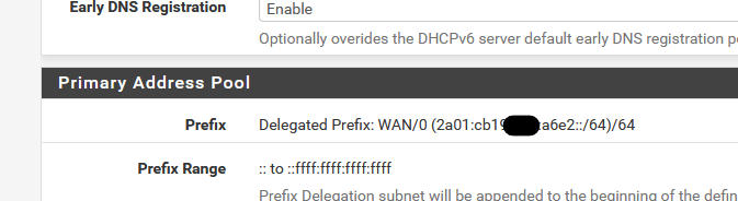

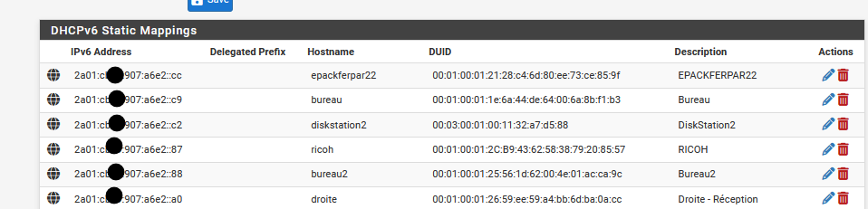

                                It obtained a IPv6 : 2a01:dead:beef:a6e2::c2 for my syno. That could be considered as a /128.
                                and that's correct as 2a01:dead:beef:a6e2::0 -> 2a01:dead:beef:a6e2::ffff:ffff:ffff:ffff - the entire /64 block) where my 'e2' prefix used on my LAN
                                My IPv6 DHCP server pool is way shorter, of course :
                                and I'm using static IPv6 leases for most of my network devices. These leaves are outside of the pool, just above.
                                Static leases as I don't want them to have these kind of addresses : "2a01:dead:beef:a6e2:92ec:77ff:fe29:392c".
                                SLAAC : never used it. I'm a DHCP-man, as it worked well for IPv4, so I tend to believe it works fine for my IPv6 stuff also.
                                Android : never saw or had one ...
                                All my iPhone, iPad, printers, PCs etc etc that are IPv6 capable, work just fine like this.

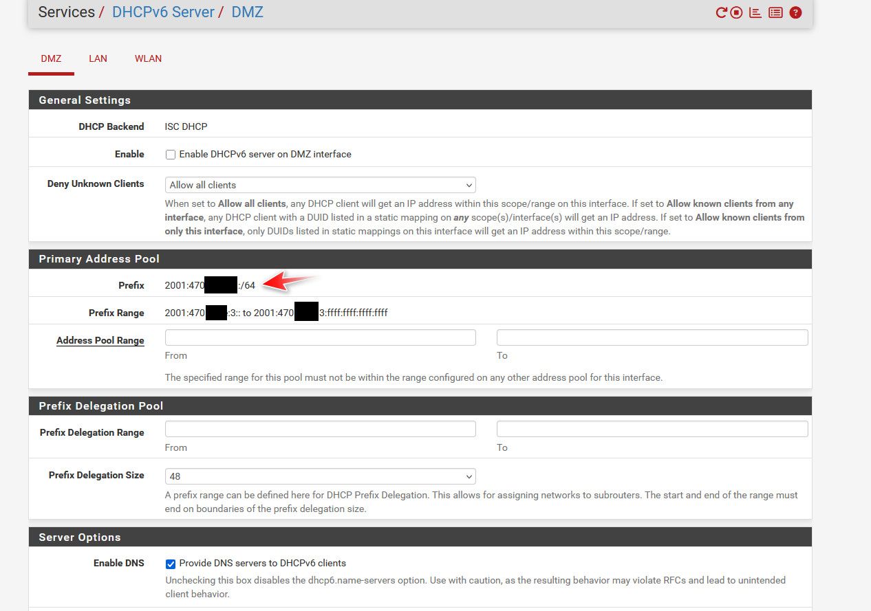

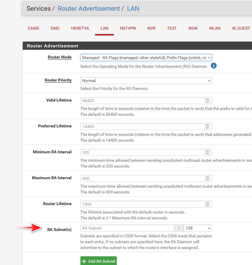

                                A suggestion : maybe you Fedora box is asking for a 'prefix', which would be a /64 ?
                                (but in that case the pfSense LAN DHCPv6 server would have to be set up to delegate these prefixes downstream.)
                                  Do you have this set?
                                  That should be left empty and it would hand out the /64 that is on your interface.
                                    jarmo @johnpoz
                                    @johnpoz
                                    RA Subnet(s) is empty.

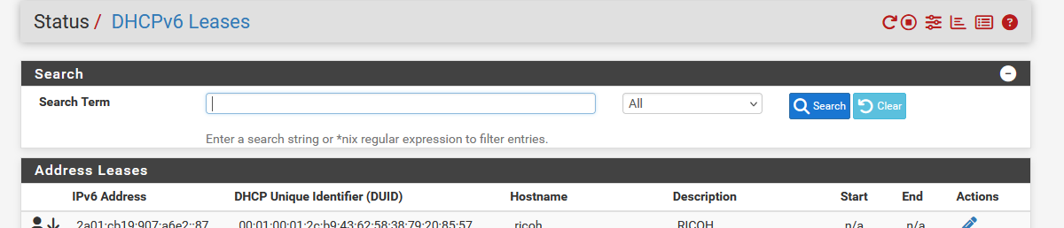

                                        if the pfSense DHCPv6+ server hands out leases, they are listed here :

                                            @Gertjan said in Should my dhcpv6 clients also get a /64 address?:
                                            I know. I can see a /128 ipv6 address in my computer, and the list is empty. Don't know much about ipv6, but doesn't this suggest it is has been handed by another server (ISPs)?
                                            What a mess.
