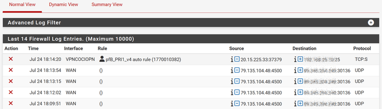

      I don't recall seeing those before ().
      It is not from UPnP ( I think).

        Not seeing those in my firewall logs. Yours do look rather odd.
          Those usually appear if the ruleset has been reloaded since the log line happened and the new ruleset no longer has a rule number that matches.
          The firewall logs match the rule numbers to the currently running ruleset and that can become invalid.
          That's not new it's just not often seen by most users.

            @stephenw10 Yeah, usually I only see those with UPnP-Rules. But these are block-rules which is new to me. I don't have any dynamic rules I can think of (other than UPnP).
              Mmm, anything further down the ruleset can get changed at reload by changing rules higher up.

                Hover over the red X and it will show a nice new popup window with a lot more detail about the entry. You can use the info from that popup to dig deeper in the rules and maybe see what it was.
