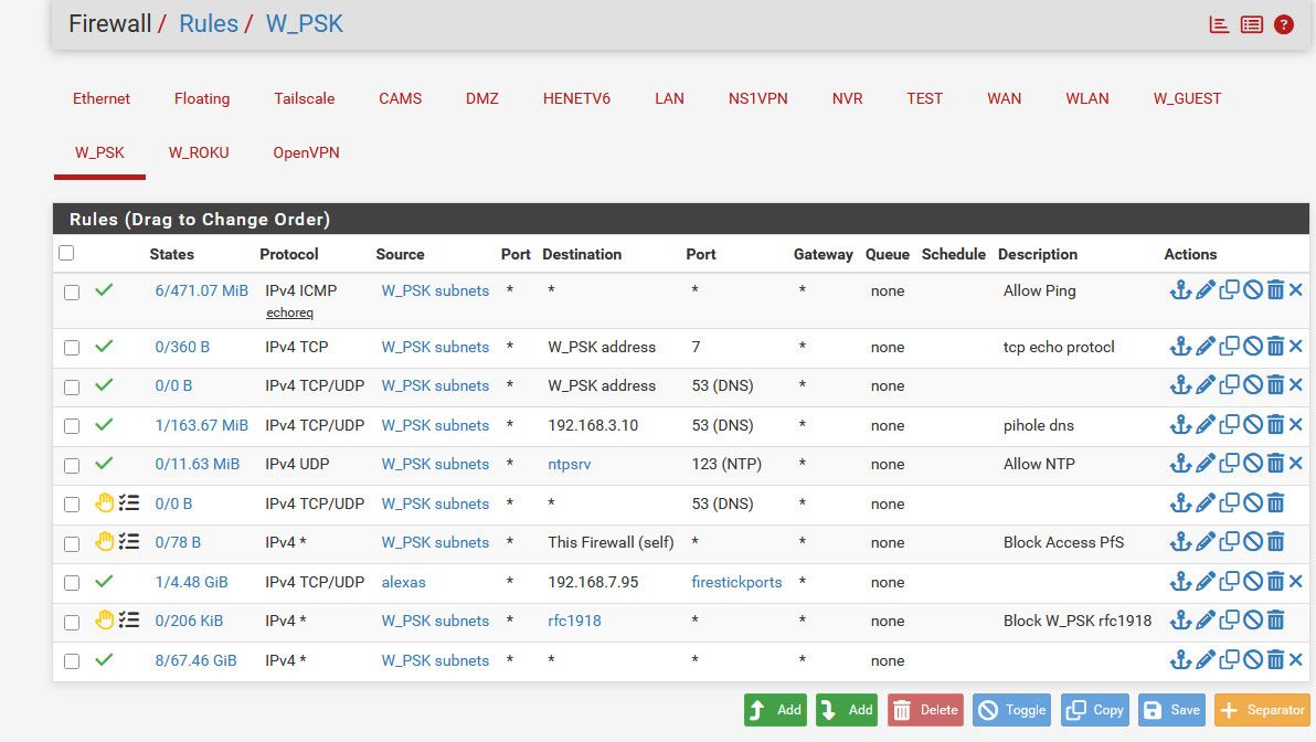

        An actual screenshot of your rules would be easier to read.

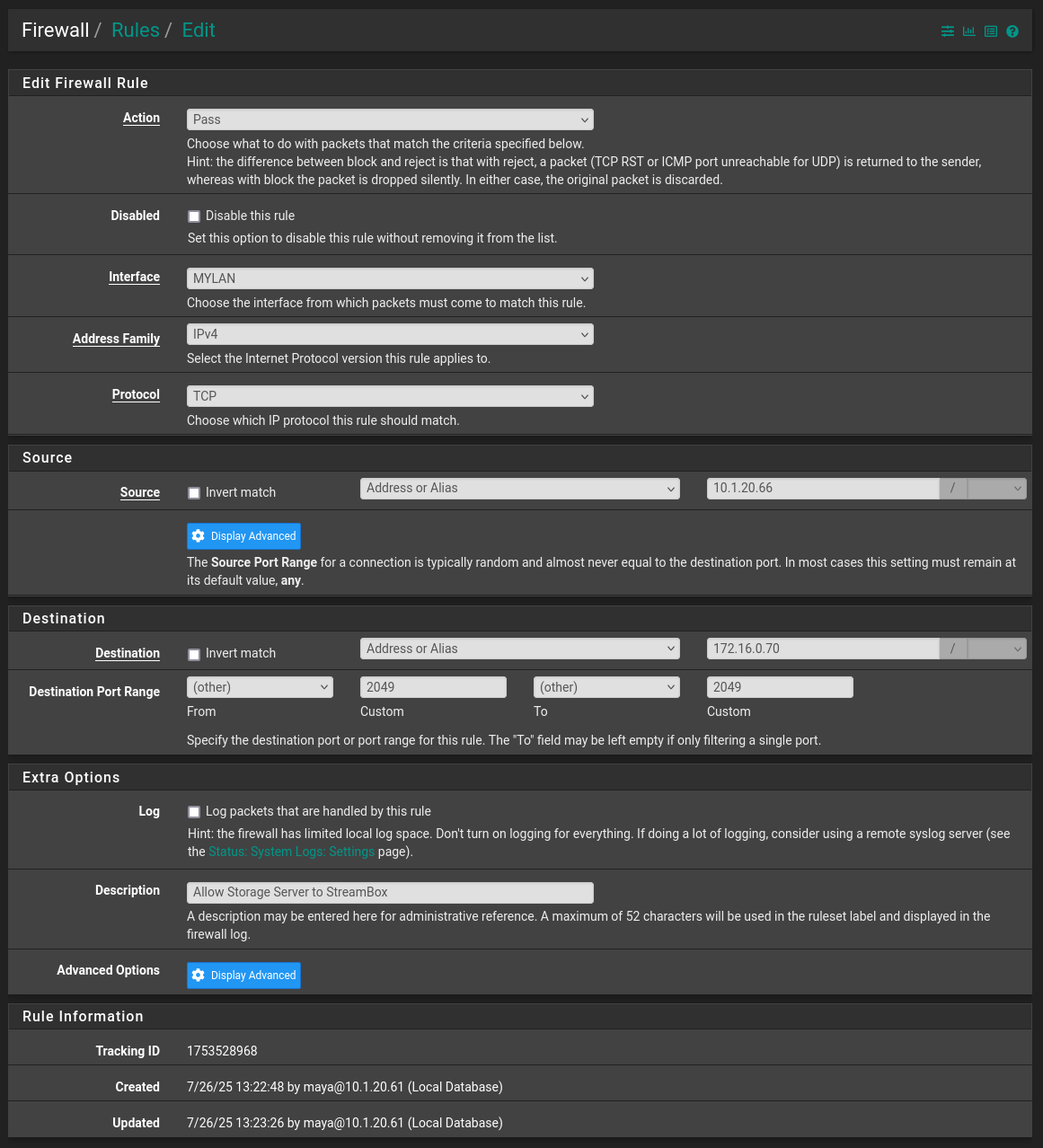

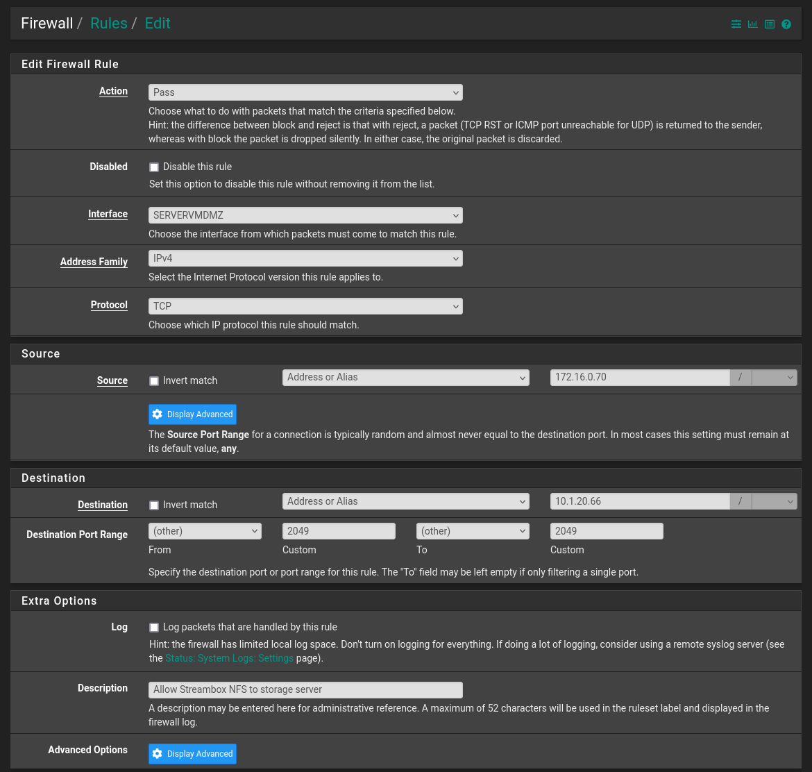

          This is the rule in 1720 (vm)
          Any other rule I should post?
          I added this as a test, but still the same block.

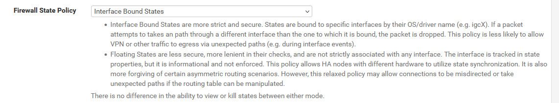

            @Fredish that SA is a syn,ack - which screams asymmetrical traffic. IE the return traffic was seen on different interface than the state was created on when traffic was allowed.
            As to screen, I mean of the rules on the interface.. Like this for example.
              SteveITS Rebel Alliance @Fredish
              @Fredish the above, and you might look into the state policy changes.
              https://docs.netgate.com/pfsense/en/latest/releases/2-8-0.html#general
              Upvote 👍 helpful posts!
              • F Offline
                Fredish @SteveITS
                Hi @SteveITS,
                Thank you for directing me to the solution. I changed it to "Floating States" and it started to work. Now I need to learn more about that and how I should manage it in the future.

                • johnpozJ Online
                  johnpoz LAYER 8 Global Moderator @Fredish
                  @Fredish I don't use floating states and have no issues.
                  I have multiple vlans setup.. If I were to guess you have some sort of asymmetrical flow going on that floating is allowing.. If me I would look to why that is and fix the asymmetrical flow. Unless your doing something that would require the relaxed setting. Like the HA example given in the note.
