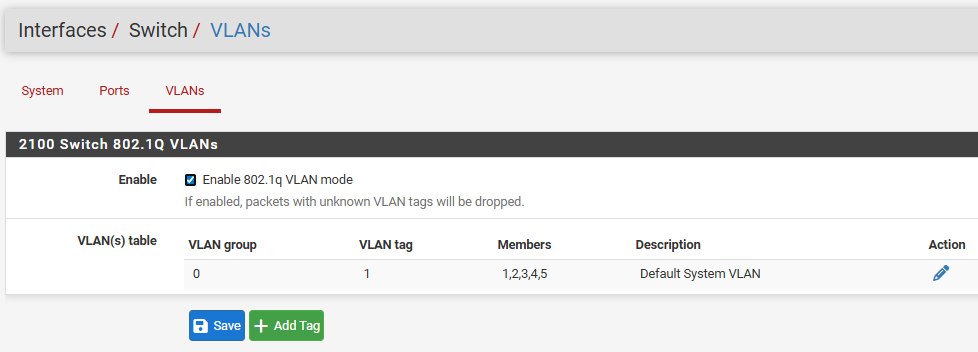

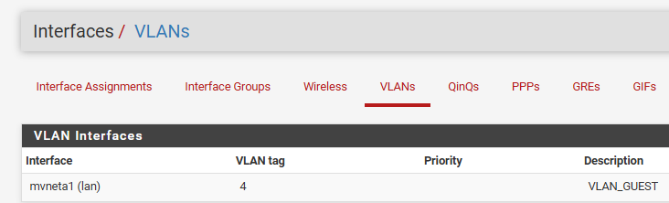

      I'm trying to achieve a simple solution to have a Guest network run in total isolation from my own network. My plan was to set Lan Port 4 up for this task and then run a cable to guest in the basement, where guests using their own router/wifi. But I cannot get my head around this: DO i trunk or not? dot1q? And if I try to change Members in the Vlan on the switch, factory reset is next.
      Adding a couple of pictures, appreciate any tips and assistance!
      Doing this leads to lost connection to GUI, and the easiest wat to get back is Reset to Factory.
        mcury Rebel Alliance @BingoBonzo

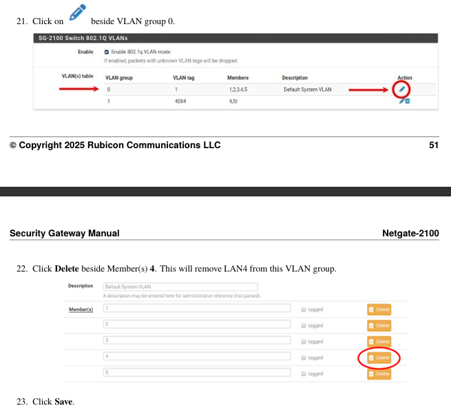

        @BingoBonzo In Interfaces / Switch / VLANs tab, you need to create a TAG:
        VLAN tag 4
        Members port 4 and 5t
        Then, remove port 4 from VLAN group 0 / VLAN 1.

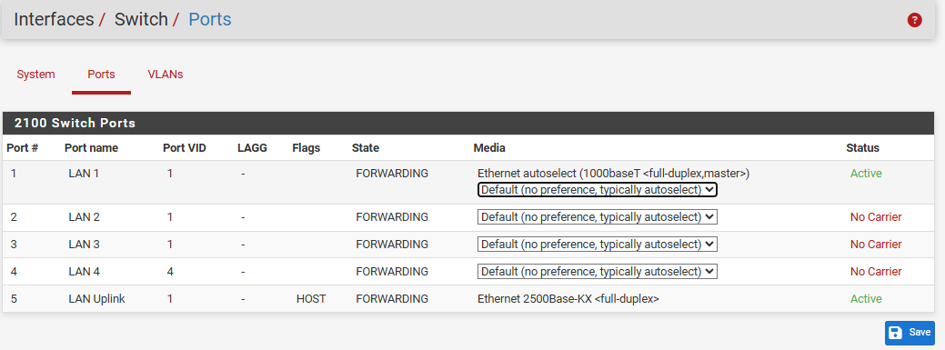

          1. Usually when I set these tags (see my last picture), I loose connection to webgui.
          2. Do I need to Trunk Port 5 in VLAN 4?
          3. I checked ipconfig (before tagging) after my initial setup and it seems that Default Gateway is empty. Can that lead to issues?
            @BingoBonzo
            1. When configuring, use another port.
            2. Yes, port 5 is where all the 4 physical ports connect to the SOC, it is not a physical port, so yes because VLAN 4 will reach it tagged.
            3. Yes that is an issue, without a gateway you won`t have acccess to the Internet, or other VLANs, something is wrong.

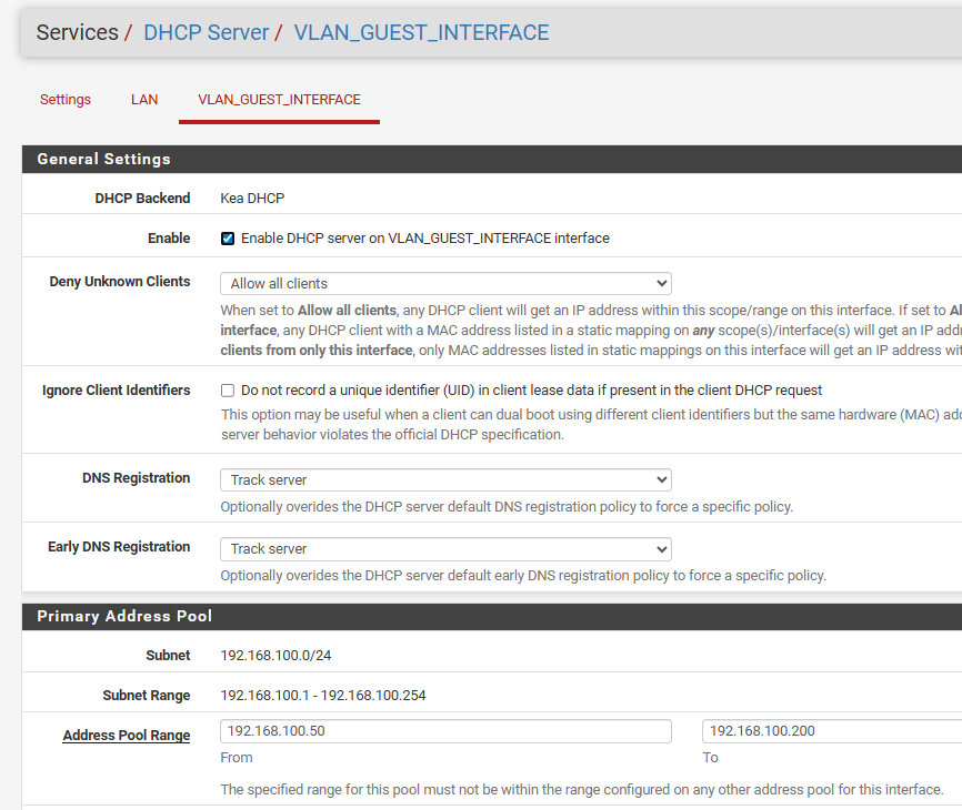

              Thanks a lot, this brought me a long way forward @mcury !
              I did redo the DHCP Server settings, and now the Gateway is defined. I believe the lack of Gateway lead to the issues of loosing connection to GUI.
              Now, I can start configure more rules on the FW + connecting the Netgate directly to my ISP Modem.

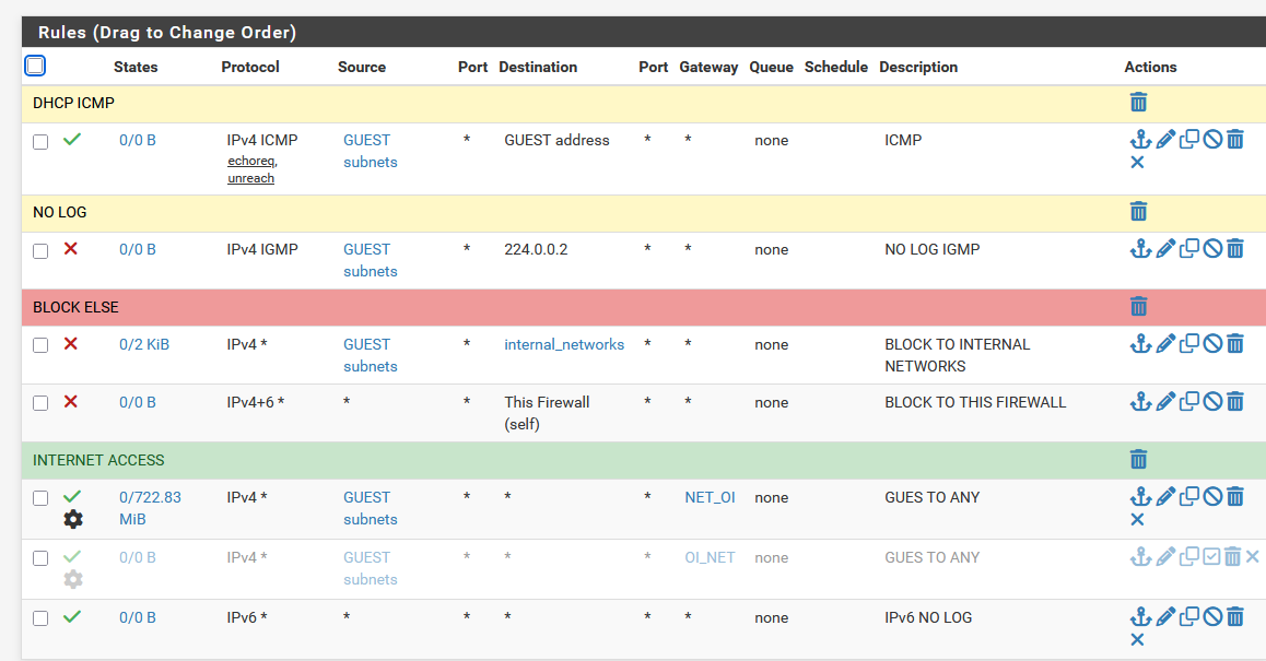

                Based on the description, this would be a GUEST network.
                Here’s an example for you:
                Note: GUEST users are not allowed to use pfSense’s DNS server. Instead, I’m using DHCP to provide a public DNS server for them.
                Internal network alias is an alias that contains all my local networks.
