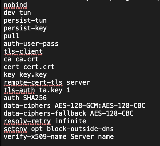

        I am running VPN over TCP. I can try UDP. I can set mssfix and tun-mtu.
        I am using the same cipher, protocol (TCP), and I am not sure how to check auth settings.
        Here is my config file

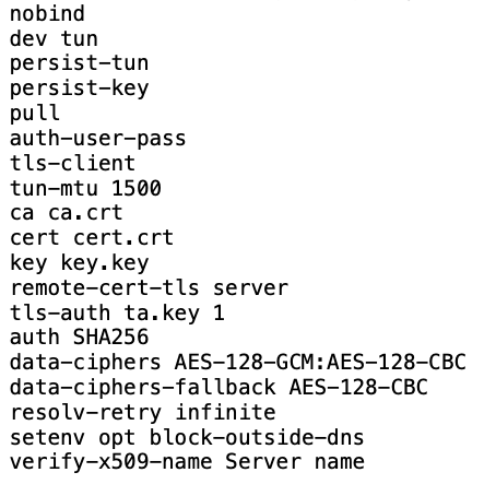

          chrcoluk
          I would leave tun-mtu unset if you dont control both ends of the link and if the supplier has not told you to set it.
          The gist of it is this, if you set it below 1500, you will need working icmp mtu discovery, it also should be set same both ends of link, but if you dont have access to the other end of link you dont know what it is configured to.
          Typically you have a choice of either a lower tun-mtu, or a 1500/default tun-mtu combined with the fragment variable.
          mss you should probably specify for max-mss headers, or set it on the interface settings in pfsense so scrub adds the headers.
          you should always aim to use udp not tcp for openvpn.
          what might be reasonable in your case.
          #tun-mtu (not set)
          fragment 1400
          mssfix 1400 mtu

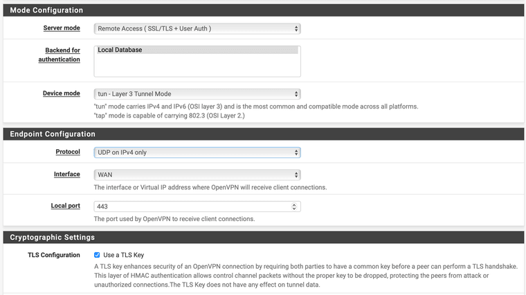

                      UDP using port 443 ok?
                      Had no idea there was ai driven spam now. Thought that was one weird post.
                      Going to change it here to UDP over 443 and download a new client Viscosity bundle. Glad I posted about the TCP error. I learned a bit.
