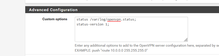

            for example, I use the option
            status /var/log/openvpn.status;
            status-version 1;
            for my own needs.
            When yous aved tehse option, check how OpenVPN sarts up (the logs) and see if it doesn't scream with errors.
            Also check the openvpn config file (the one created with the GUI parameters) for consistency.
            You can find the file here :
            /var/etc/openvpn/server1/ and look for the file "config.ovpn". It's an ordinary text file.
            Don't (bother) edit(ing) this file as it is auto generated by the GUI.
