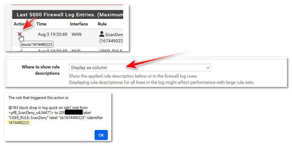

                @revengineer what specific rule blocked it.. If you move your mouse over the X it would give you the rid, or if you click the x you will get more info.
                Or if you in the log settings tell it to show the rule as a column it will tell which rule blocked.. For example on that block its my scan deny rule..
                Its quite possible you got blocked by this rule - because you had no valid IPv6 address?
                block out  inet6 all ridentifier 1000000106 label "Default deny rule IPv6"
                But we need to see the details of which specific rule is blocking your traffic to help figure out what is going on.

                    @johnpoz Thank you for the tips on how to find the associated blocking rule. Unfortunately, there have been so many blocks that all my filter.log.* files only go back several hours but not to yesterday morning. So I will have to wait until the problem reoccurs. I may need to the weekend to play with this.
