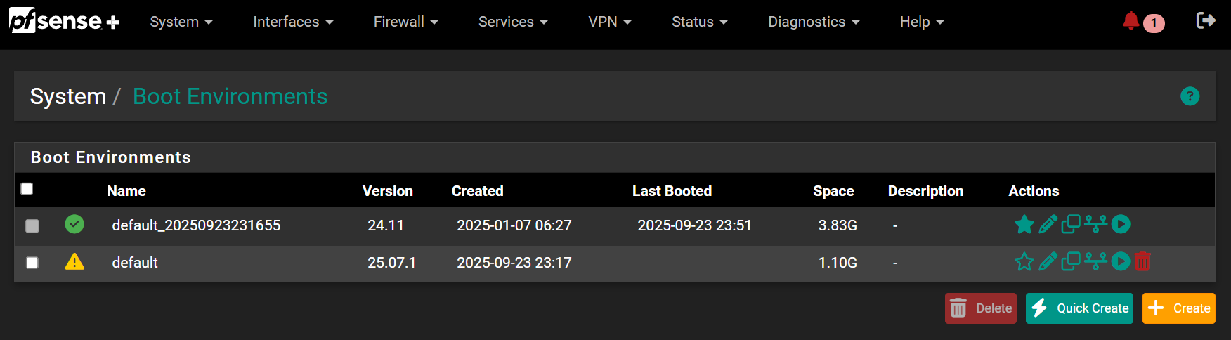

        Hmm, nothing obviously wrong there. Do you see an alert after it reboots into 24.11?
        Check System > Boot Environments. Do you see the new 25.07.1 BE marked as failed?

              @stephenw10 - I would've expected to see some type of kernel panic notice based on this behavior, but no alerts whatsoever. I have the SG2100 console port connected via USB to a RaspberryPi device and logging the console output via screen. Yes, as per the screenshots, it states the BE failed to verify.

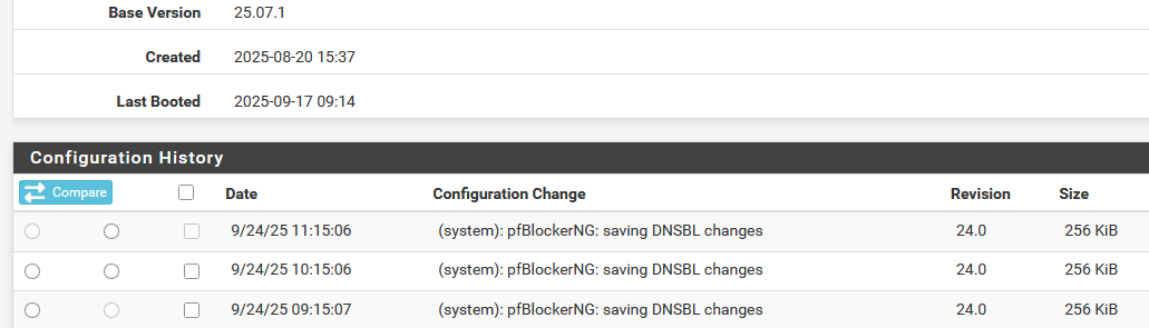

                  mcury Rebel Alliance @SteveITS
                  @SteveITS said in Now Available: pfSense® Plus 25.07-RELEASE:
                  There were a couple bugs at play, pfBlocker updates a timestamp in the file every cron run,
                  25.07.1 has this issue with pfBlockerNG.
                  But Maximum Backups option is working.

                      SteveITS Galactic Empire @mcury
                      @mcury said in Now Available: pfSense® Plus 25.07-RELEASE:
                      I don't have a link handy but I'm pretty sure Netgate posted that's been fixed in a later version? Or there was a patch in that forum somewhere. It's worse if using pfB in HA because the secondary was getting multiple config files because of its cron plus the sync at cron time.
                      I have a note to check config history before starting an update.
                      diag page does time out
                      It will but if you keep reloading after that, and be patient it should eventually load. I think mine timed out after 10 minutes and had deleted most of the files.
                      25.7 fixed the history retention.
                        Redmine #14409
                        DNSBL is also disabled here, so it seems that 25.07.1 didn't bring that fix?
