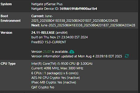

      I am not sure what's going on but the new update is failing for me. The install gets thru the upgrade process to reboot. Upon the reboot it gets stuck at a point for like an hour, it doesnt nothing. I reboot again and it goes right back to 24.11
      Any ideas!!

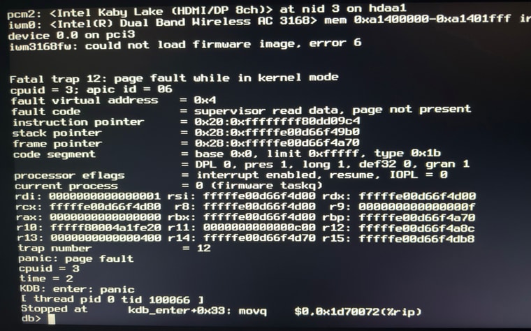

        SteveITS Galactic Empire @sstatjm
        @sstatjm What’s the console show?

          sstatjm
          are you referring to this?
            @sstatjm no, a physical monitor.

              sstatjm
              Oh ok. As in what the error message is or panic
                sstatjm
                That's where my upgrade stops.

                • w0wW Offline
                  w0w @sstatjm
                  @sstatjm
                  https://forum.netgate.com/topic/197485/kernel-panic-when-upgrading-to-2-8-0-beta
                    sstatjm
                    Thanks that worked!! Much appreciated.
