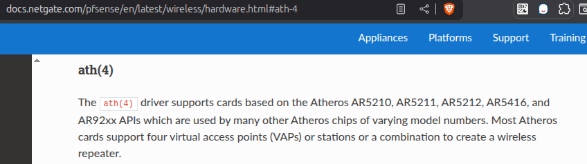

      From the docs I see:
      So I got a USB one from amazon and plugged it in and rebooted and a usbconfig list gives this:
      ugen1.2: <AR9271 802.11n Qualcomm Atheros Communications> at usbus1, cfg=0 md=HOST spd=HIGH (480Mbps) pwr=ON (500mA)
      However, nothing shows up under ifconfig (seems like I should expect to see something like ath0) or in the webconfigs interface assignments or wireless or anything. Do I need to compile something? Im usually pretty good in googling at least where to start on things like this but in this case I can't seem to find any kind of starting point, which seems like probably a bad thing for me here.
      Im travelling to EU and need an allinone solution for when at the AirBNB for all the devices in the apartment, to VPN back to my SG-1100 at home.

                  Ah OK, when I read this:
                  Most Atheros cards support four virtual access points (VAPs) or stations or a combination to create a wireless repeater.
                  Then I thought that means we can HostAP for multiple SSIDs
                    The ath(4) driver doesn't support USB NICs as far as I know.

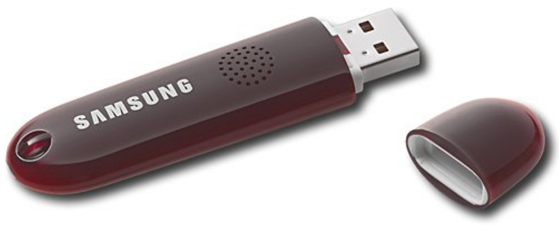

                    • provelsP Offline
                      provels @opticalc
                      @opticalc It's the last post in that thread I linked, Samsung WIS08BG2X.
                      It's going on 18 years old.

                      • opticalcO Offline
                        opticalc @provels
                        @provels said in SG-1100 and a USB based Atheros AR9271:
                        https://man.freebsd.org/cgi/man.cgi?query=rum&sektion=4&manpath=freebsd-release-ports
                        thanks for letting me know!
                        was is on standard intel hardware or a netgate?
                        provelsP 1 Reply Last reply Reply Quote 0
                        • provelsP Offline
                          provels @opticalc
                          @opticalc Intel.
                          Peder
                          MAIN - pfSense+ 25.07.1-RELEASE - Adlink MXE-5401, i7, 16 GB RAM, 64 GB SSD. 500 GB HDD for SyslogNG
                          BACKUP - pfSense+ 23.01-RELEASE - Hyper-V Virtual Machine, Gen 1, 2 v-CPUs, 3 GB RAM, 8GB VHDX (Dynamic)
