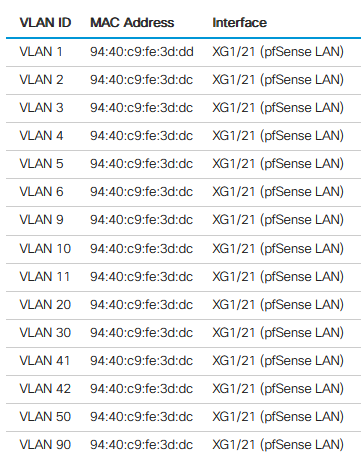

      The switch shows two distinct MAC addresses for bxe1 and bxe1.100:
      VLAN ID MAC Address Interface
      VLAN 1 94:40:c9:fe:3d:dd XG1/21 (pfSense LAN)
      VLAN 100 94:40:c9:fe:3d:dc XG1/21 (pfSense LAN)

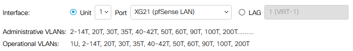

        Screenshots :)

          • T Offline
            tgvoelker @patient0
            @patient0 VLAN 1 is a normal VLAN. 0 means untagged, which means that the packets don't have any VLAN information in it and the switch assignes the Primary VLAN (port in trunk mode)/assigned VLAN (port in access mode) to packets entering the switch port and sets the VLAN number on those packets.
