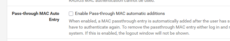

          Or : use "auto MAC pass through" :
          so when the user connects ones, his MAC will get add to the list - so no more login needed (that is, it still must receive the same IP / same lease all the time).
          You, at the end of the week, you throw everybody out manually from the MAC list :
          There is still one thing you need to be aware of : some users (devices) are totally paranoid, and regenerate their device Wifi MAC all the time. In that case they have to re logging all time - not your fault (I've seen this twice now ...).
