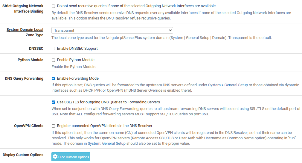

          Interface for Secondary ISP connection has been selected, and here's other configurations.
          I have checked pfBlocker configs, but couldn't find specific settings related DNS..
          Thank you for your time.
            SteveITS Galactic Empire @eeebbune
            @eeebbune Forwarding mode is enabled there. If you have also used your DNS server's IP as your gateway monitoring IP, pfSense will create a static router for the gateway monitoring IP. Try failover with forwarding mode disabled, or use a non-DNS server as your gateway monitoring IP.

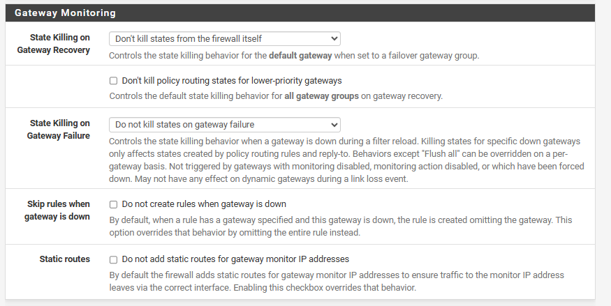

              Gateway of WAN1 (Primary), WAN2 (Secondary) are seeing different IP address such as Google DNS.
              I am wondering if you could also check my 'Gateway Monitoring' configs from Advanced-Miscellaneous.
              If my local DNS keep states, it may explain my issue.
              Hopefully changing 'State killing on Gateway Failure' to be 'Kill states for all gateways which are down' could resolve my problem and make failover smoothly.
              Is there other features I need to make change from the screen shot?
              Thank you very much.
                @eeebbune said in DNS query fails when it failovers:
                If you have, for example, set 8.8.8.8 as the gateway monitoring on WAN1, it will not be reachable if WAN1 is down. Try a different monitoring IP or forward DNS to a different DNS server.
                Those are the defaults so normally fine.
