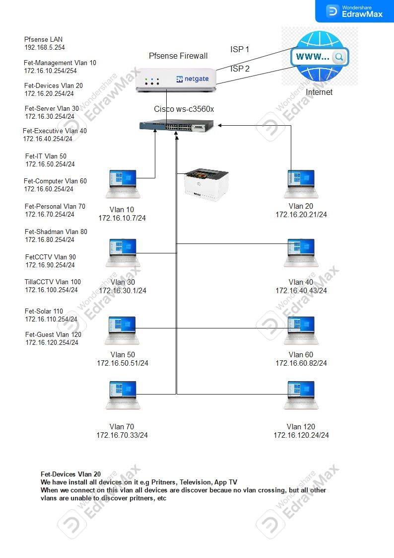

      I'm using pfSense 2.8.0-RELEASE, and I have multiple VLANs under my LAN.
      The problem is that I can’t discover printers or IoT devices across VLANs.
      If I connect to the same VLAN as the printers, everything shows up just fine. But from other VLANs, the printers and devices are not visible.
      I believe pfSense does not allow multicast (like mDNS) between VLANs by default.
      Can anyone with good pfSense knowledge help me set it up so I can discover printers across different VLANs?

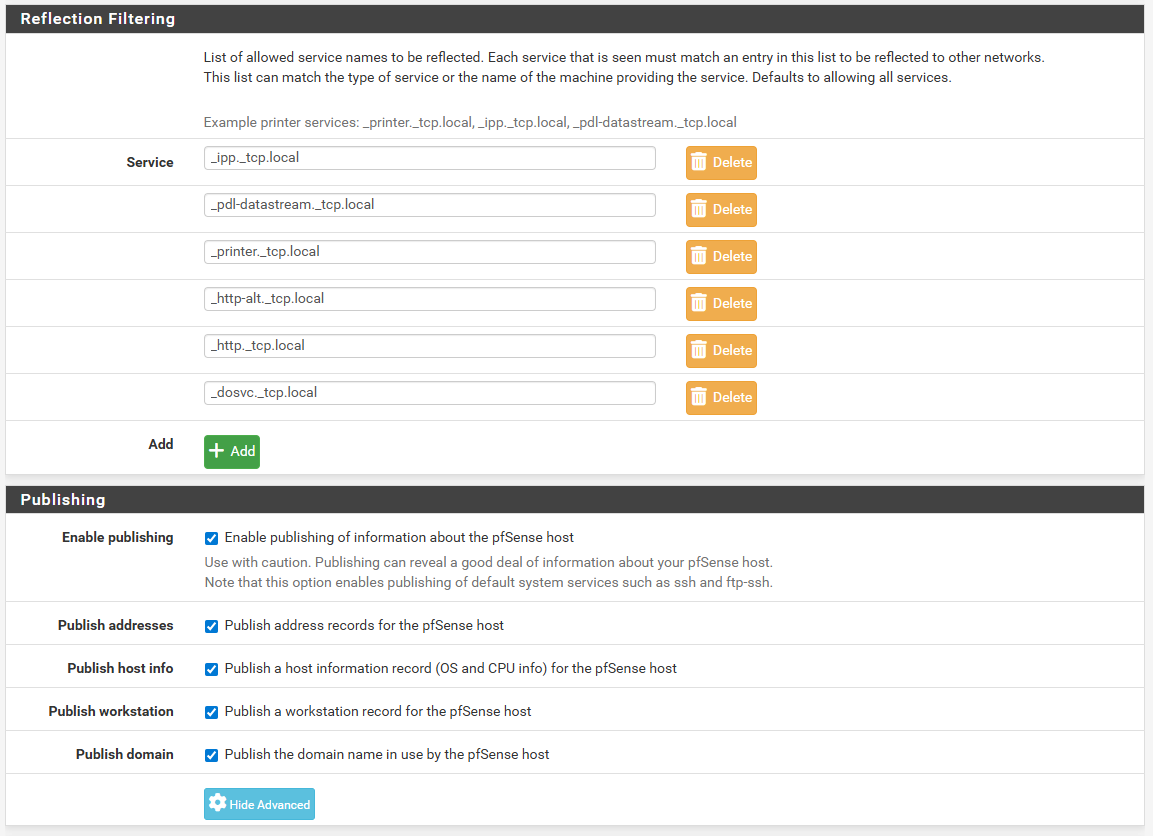

            @ayansaari Please post your Avahi config page (Services / Avahi).

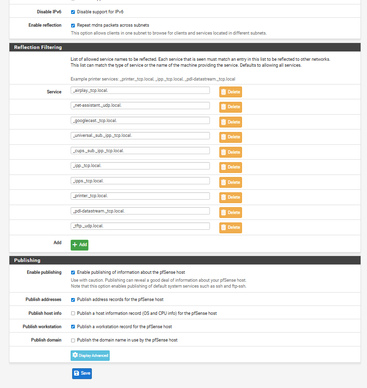

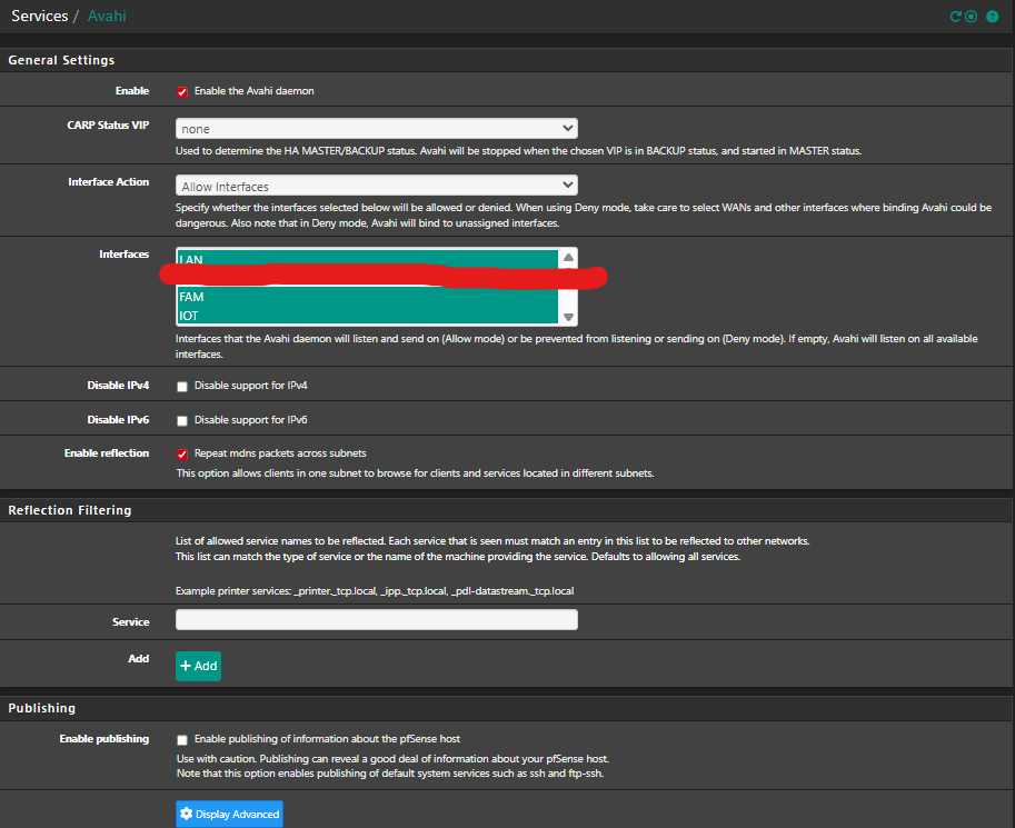

              ayansaari @dennypage
              • dennypageD Offline
                dennypage @ayansaari
                @ayansaari Suggestions I would make:
                • Start by removing all the service entries, which will allow all services to be forwarded. You can add back appropriate restrictions later. When you do, make sure they are the correct ones for your printing protocols.
                • If you don't have one yet, get an mDNS/Bounjour browser. This will be much better than trying to use OS printer discovery tools. For iOS or MacOS I recommend Discovery.app. For Windows I don't have a specific recommendation, but there are a few out there (perhaps someone else has a recommendation to offer?).
                • Disable Publishing in the advanced section. It's not related to your issue, but it almost certainly is not something you want to be doing on your firewall. That's why it's hidden in the Advanced section. 🤕

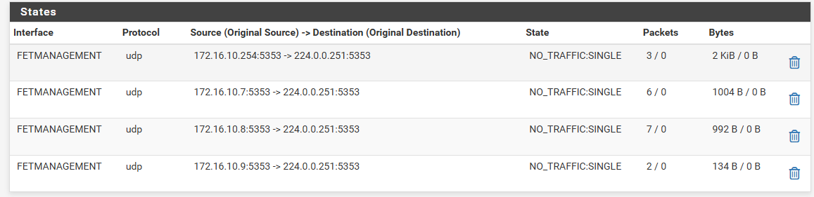

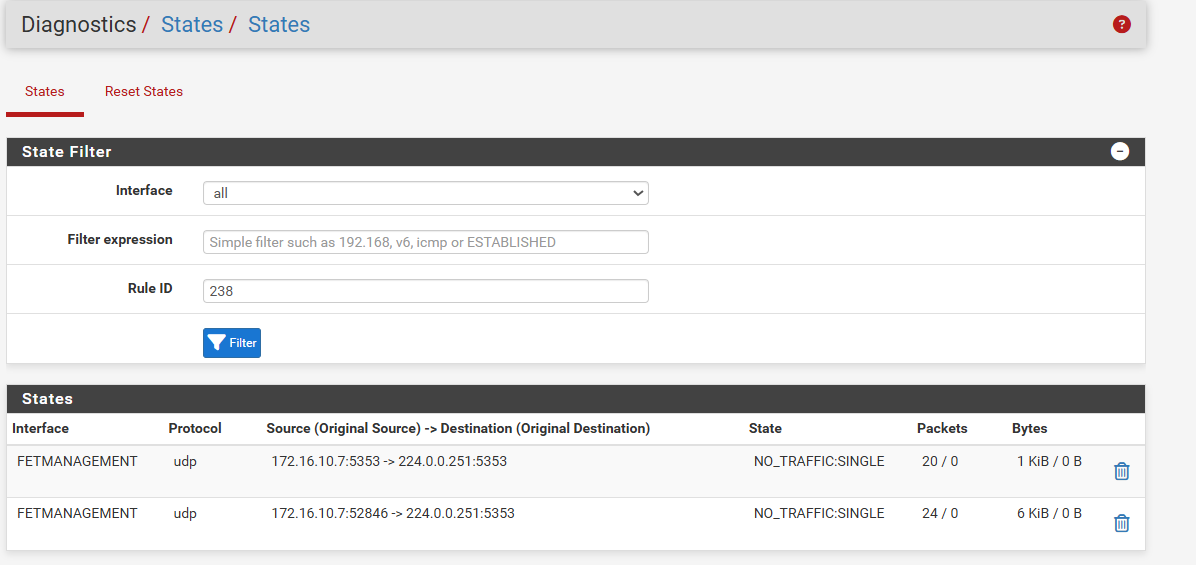

                            FWIW, assuming that your firewall is at address 172.16.10.254, your states information for FETMANAGEMENT shows for that the firewall has received mDNS from hosts .7, .8 and .9, and also sent messages. Did you disable publishing in Avahi as I suggested? Assuming so, messages sent from the firewall would be mDNS information that has been forwarded from another interface.

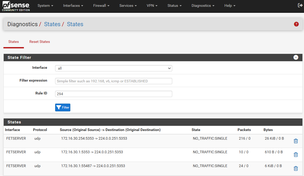

                            That's the only interface shown, so I cannot say anything about the others... Have you looked at all the interfaces to check mDNS activity? Choose Interface "all" and filter on "5353".

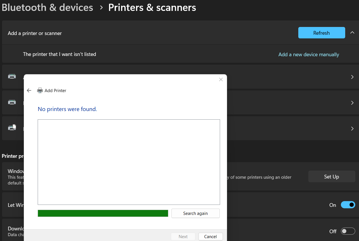

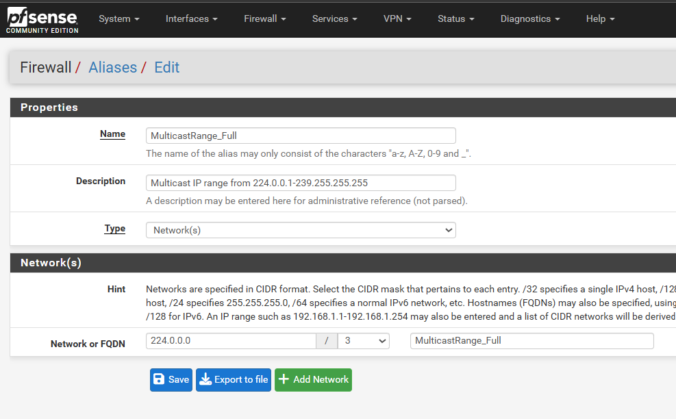

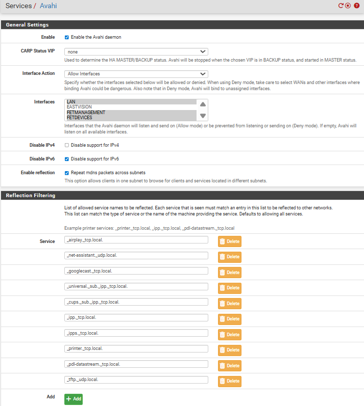

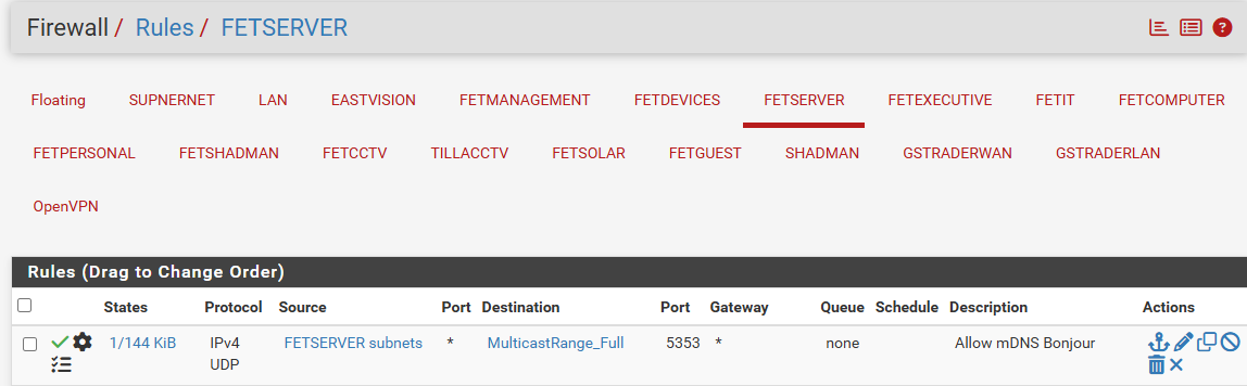

                              • GertjanG Gertjan referenced this topic
                                @ayansaari Two things I told you previously:
                                Please re-read my posts above.

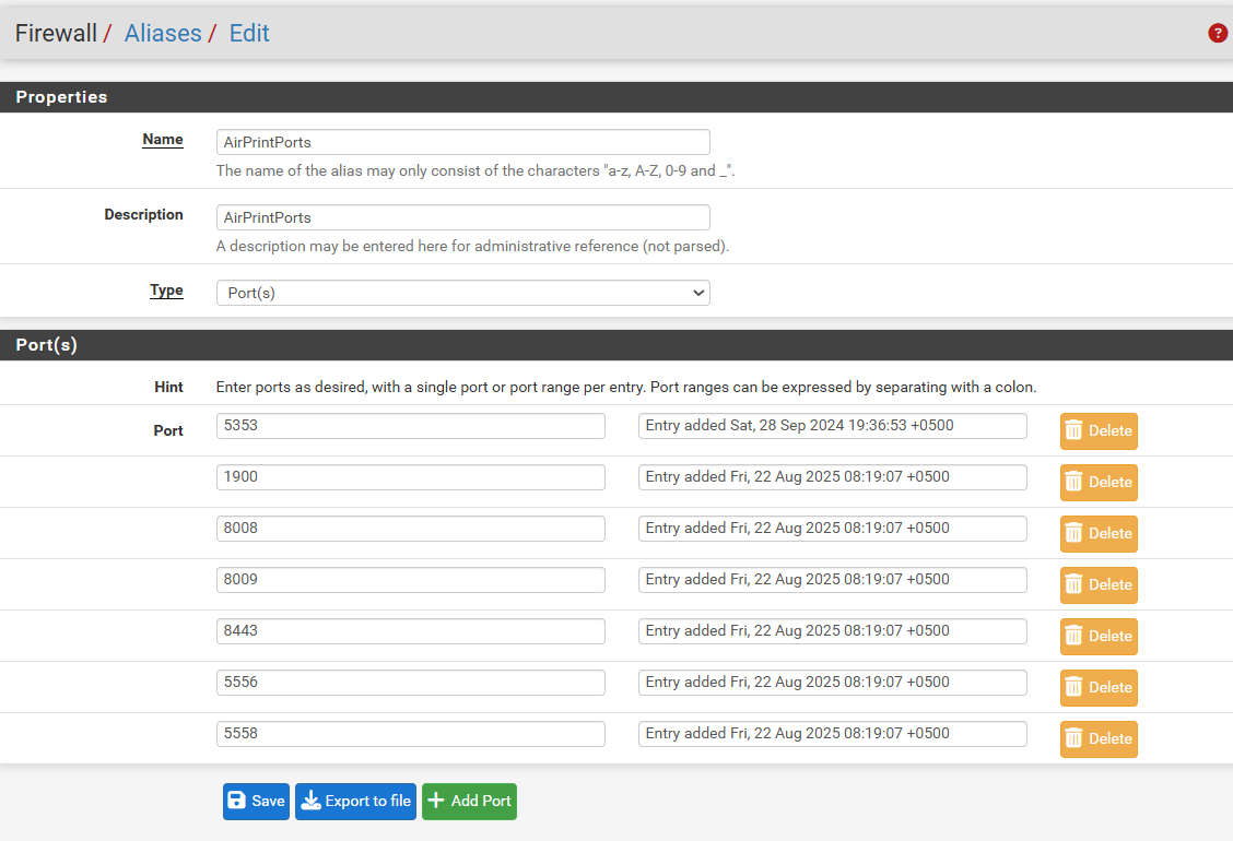

                                As I said previously, firewall rules are not used to forward mDNS. The firewall rule forwarding port 5353 has absolutely no purpose. Avahi does not forward packets from the source network to the destination network -- it sends packets that it creates to the destination containing information gathered from packets it receives in the source network.
                                Also as I said previously, remove every entry you have in the Service list for Avahi Reflection Filtering, and do not add any entries to the Service list until you have successfully tested. And again, disable Avahi Publishing -- having this enabled is a bad idea, especially if you do not understand the basics of mDNS.
                                A 1 Reply Last reply Reply Quote 2
