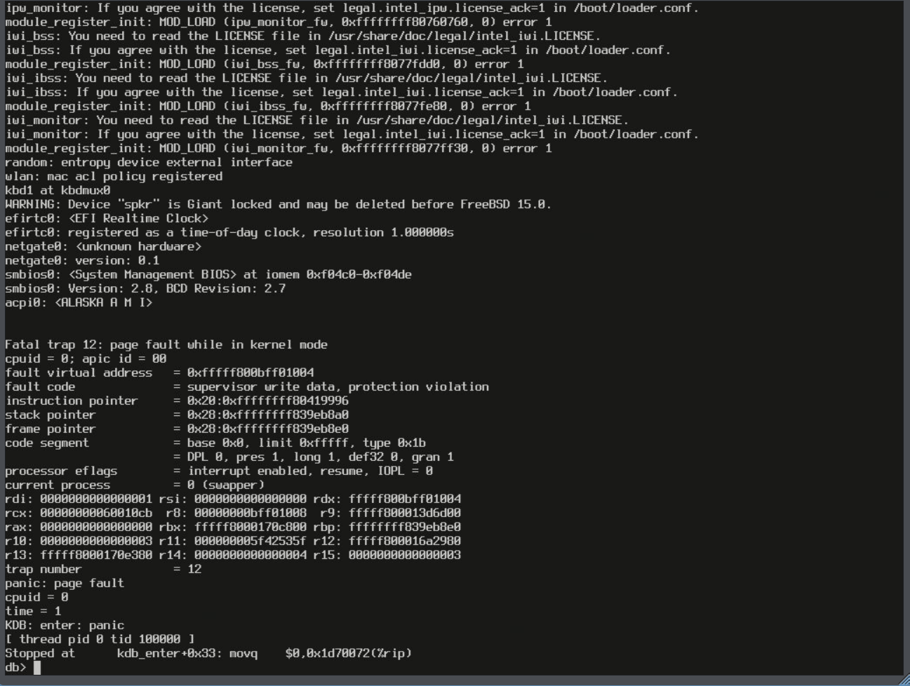

    Upgrading from 25.07 to 25.07.1 causes a fatal trap 12 on boot.

      Hardware is an ASRock Rack E3C226D2I board. I can boot in legacy mode, but not in UEFI, no matter what I do. Boot Environment selection works, but the bootfs option (3) remains the same, it never changes from 25.07.1, and it fails to boot every time.

          Hmm, those should not be removed from loader.conf.local.
          Are you able to get the full output from a UEFI boot leading up to the failure?

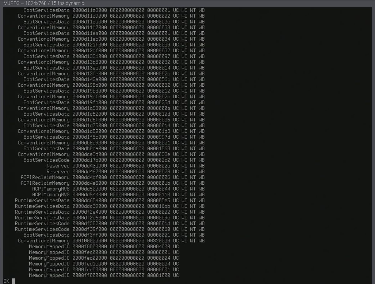

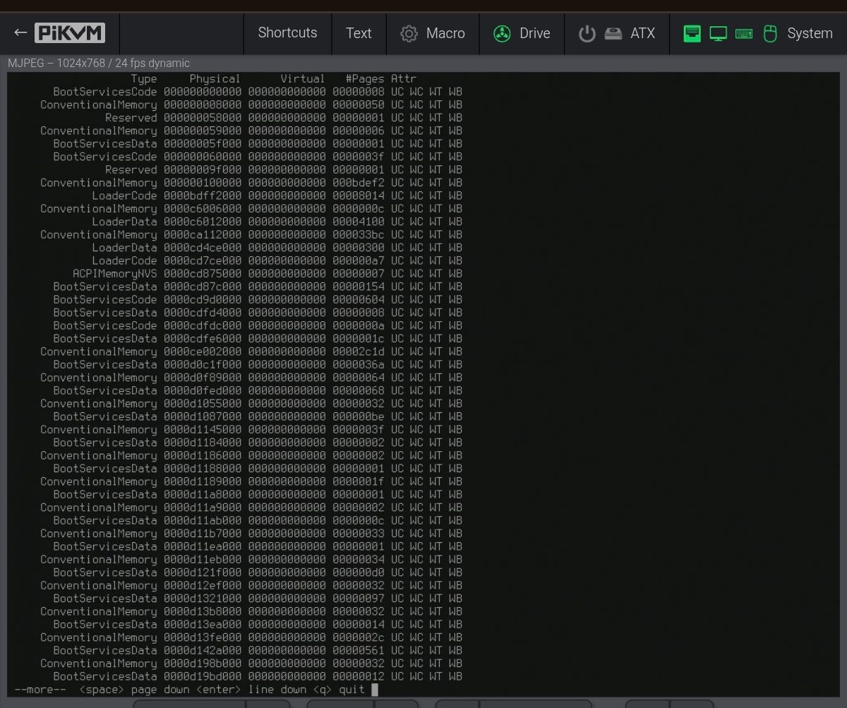

            Are you able to try upgrading from 24.11 to 25.07.1 directly?
              If you can replicate that try running bt at the db> prompt after it crashes to get the backtrace.
              Also try interrupting the loader to reach the OK> prompt and run: memmap
              That will show if there's something hardware specific happening.

                  @stephenw10 said in Upgrading from 25.07 to 25.07.1 causes a fatal trap 12 on boot.:
                  It just hangs there, no input possible.
                  and run: memmap
                  • w0wW Offline
                    I’m not sure here, maybe I still have an old boot environment left, then theoretically it’s possible, but it would require my presence, so it can only be done later after work.
                      Ok thanks. I'll relay that to the devs, make sure it looks rational.
                        If you're able to get the full boot output try doing so whilst booting verbose. So boot -v at the loader prompt. That should give us more.
