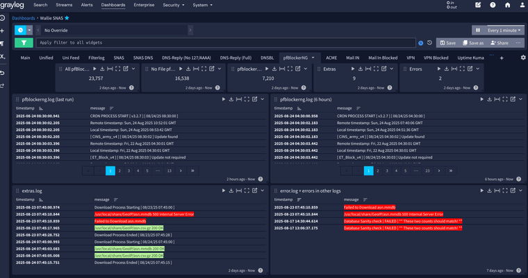

          jrey @keyser
          @keyser
          I so want to answer this, but then at the same time (no I don't) ...
          pfblocker using syslog messaging in real time. no tailing of files, no other packages, just code.
          PS. don't look at the Graylog dashboard menu bar presented - it might lead to more questions 😉 ..
          keyserK 2 Replies Last reply Reply Quote 0

            @jrey said in pfBlockerNG syslog logentries to remote SIEM:
            @keyser
            Huuuh? That seems very very interesting😱 I noticed your name in other posts around the forum where you seemed to be QUITE proficient at coding/developing. Are you by any chance considering involvement in developing and refining the pfBlockerNG package?
            It would be SO great if you are looking into adding native syslog to the pfBlockerNG package - or an easy workaround that does not require additional packages and “temporary” edits in files that does not survive service restarts or pfSense updates.
            Here’s 🤞 that you will fill me/us in on the solution you are using to your Greylog - please, pretty please with sugar on top 😂
