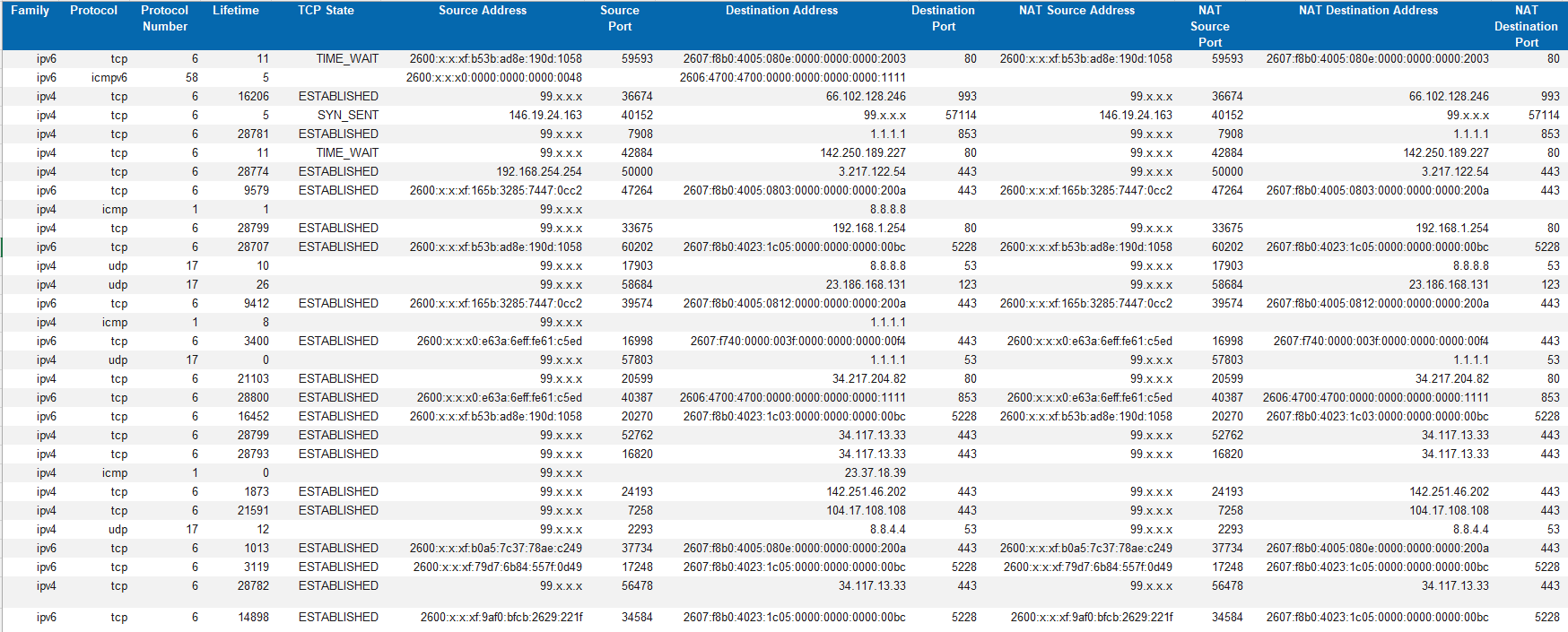

      It's similar, but different. In Passthrough mode, pfSense gets the public v4 IP of the BGW. For v6, the pfSense gets a routeable IP via DHCP for its WAN IP, and any delegated prefixes that it requests. pfSense thinks that it's directly on the WAN with routeable addresses and prefixes.
      The BGW then 1:1 NATs every flow to/from pfSense, keeping the same source/destination address/port on both sides of the NAT. There's a snippet from the BGW's NAT table below. The x's are to obscure my routeable addresses and prefixes.
      Guessing one reason they don't do a true bridge is to enable the BGW to NAT+route in parallel for its non-Passthrough LAN-side clients (none in my case).

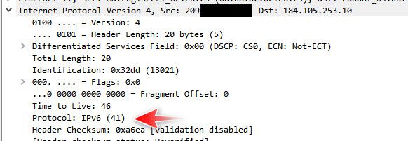

                        You know I don't even think the nmap test is valid.. I picked another tunnel endpoint so not to mess with with current tunnel I have open.. And when I sniff on pfsense wan and do another nmap.. I see nmap send what appears like protocol 41, but get no answer and lists as invalid.. Did it actually go out the wire?? and just not get an answer.. Or did it not really go out the wire and just caught in the packet capture.
                        15:10:57.645055 IP 209.snipped > 184.105.253.10: IP6  [length 0 < 40] (invalid)
                        15:10:57.806265 IP 209.snipped> 184.105.253.10: IP6  [length 0 < 40] (invalid)
                        184.105.253.10 is their dallas pop tserv8.dal1.ipv6.he.net
                        If I sniff the previous IP where I do have a tunnel open... I see responses.
                        So I am not sure there is a way to test if 41 is open with nmap or traceroute..
                        but since @marcg is using the same device and also on att and can open a tunnel - this shows that at least where he is at they are not filtering.. Why would they filter it some locations but not all?
