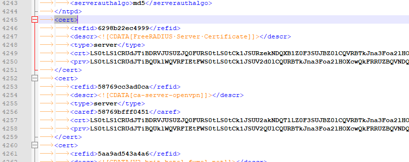

        Open the config.xml file you've backed up. Use a editor like Notepad++.
        Look for the first occurrence of
        <cert>
        which has only one tab in front of it.
        Like here :
        Check that every <cert> ... </cert> block has a <refid>xxxxxxxxx</refid>.
        There are as many <cert> ... </cert> as you have Certificates (this page : System > Certificates > Certificates )
        Your issue was : one of them is missing this <refid> ?
        Btw : you can also check the <ca> ... </ca> section, these also have to have a <refid> also.
        If doubt, paste them all here - you can remove the <cert> ...</cert> and <prv> ... </prv> lines.
