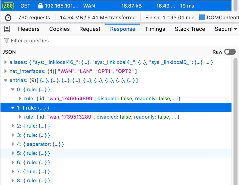

                                A rule insertion can be placed at the end (AppendFirewallRule()) or before/after a specific rule (specified by its id) with InsertFirewallRule(). The id is label given to each rule item when you retrieve the list of rules.
                                The after attribute to the InsertFirewallRule call tells the handler whether you want to put it before or after the provided id.
                                Ignore reference=str value, it is a stale field that needs to be removed because the query string for id is intended for this.
                                • P Offline
                                  philippe richard @ldangpfng
                                  @ldangpfng
                                  Hello,
                                  thank you for your response.
                                  Actually, the ID that needs to be entered is the one of the style "opt1_1757505116", and not the one that appears in the browser's URL when you edit a rule, which looks like "firewall_rules_edit.php?id=7".
                                  Now that I have corrected my mistake, it works.
                                  Thank you again.
                                  • L Offline
                                    ldangpfng @philippe richard
                                    @philippe-richard
                                    use the new UI (by default it listens on port 8443), which will let you see the API calls, similar to the screenshot of the web devtools above, where the id is derived from a unique value of the rule entry. This is unlike the PHP pages which do not have an API and assume one admin accessing the page at any time, so submitting from *_edit.php?id=7 could end up hitting the wrong entry if two people are modifying the rules at the same time.
