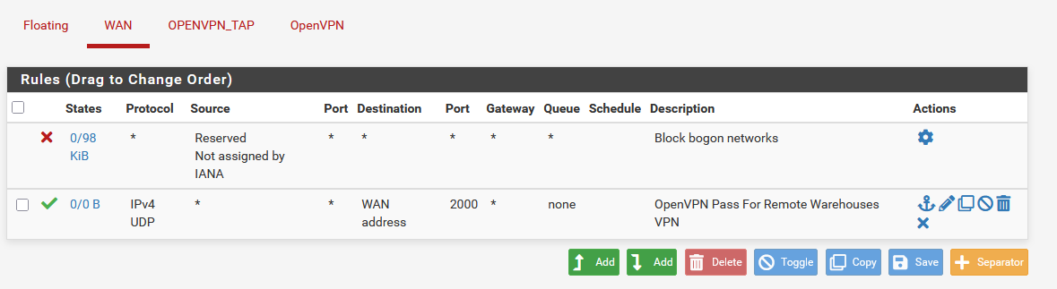

                  Matlock @SteveITS
                  @SteveITS Hi and thank you for your responses.
                  I re-cloned the VM in order to start fresh, changed ONLY the ip from viconfig but the behavior was the same, no access to webgui.
                  Below you can see the firewall rules for the 1 NIC WAN/LAN interface.
                  Waiting for more suggestions...
                    SteveITS Rebel Alliance @Matlock
                    @Matlock well you have no rule allowing access from your PC to pfSense port 443.
                    Iโ€™d ensure the internet canโ€™t access it for sure.
                    Upvote ๐Ÿ‘ helpful posts!
