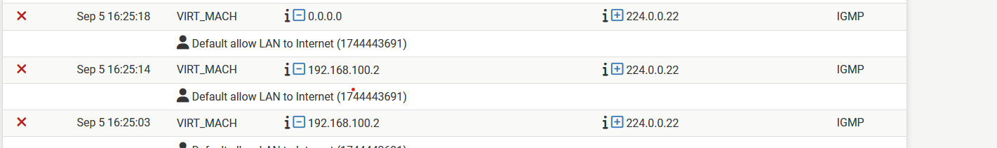

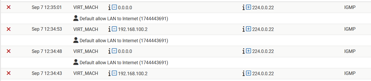

      1. Perhaps related and very very annoying (complained already a couple of times) , is that pass rules without logging do behave like block rules with logging. Which is I keep saying that is really ridiculous.
      And that issue is causing many thousands of alarms and perhaps it is reason of the problem mentioned above.
      below an very often occurring example of the mentioned problem.

          @SteveITS said in Big issues related to Firewall logging.:
          https://docs.netgate.com/pfsense/en/latest/troubleshooting/log-filter-blocked.html#packets-with-ip-options
          Steve,
          I tried a lot but the behavoir is definitively not ok and in my opinion disgusting.
          I tried to stop this logging adding extra rules in front of the rule generating the logging. Nothing stops it!

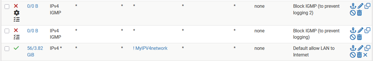

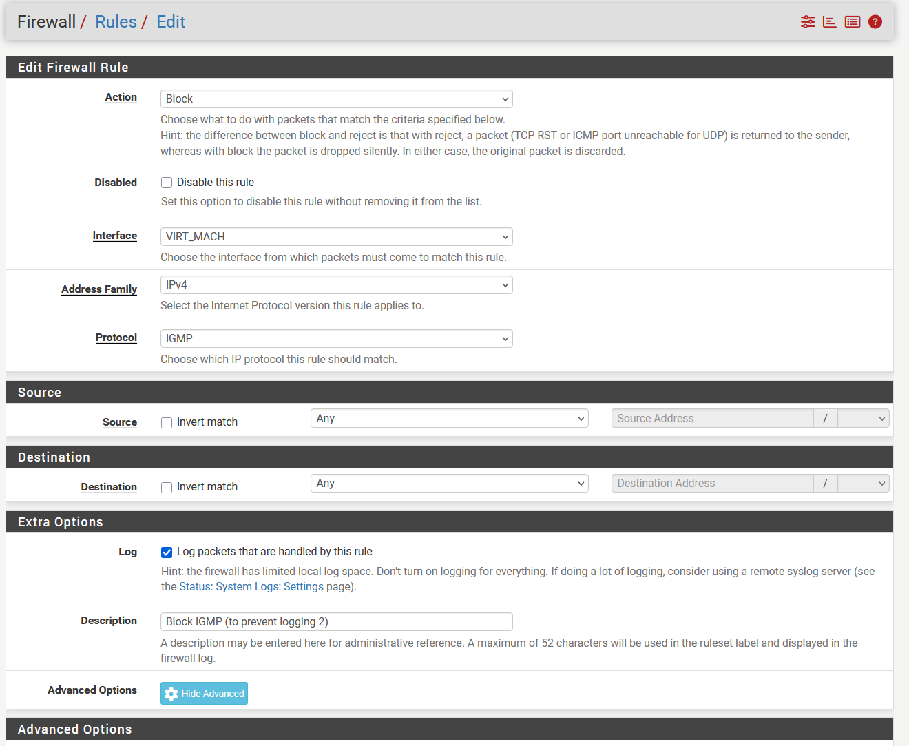

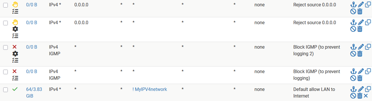

          As you can see three rules:
          1. a rule to block IGMP with options set
          2. the same rule without options set
          3. the >>pass rule without Logging<< generating the logs .....
          IMHO nothing justifies this behavoir !!

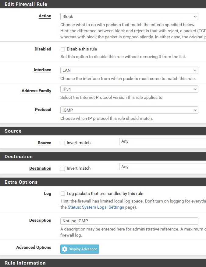

            SteveITS Rebel Alliance @louis2
            @louis2 in your screenshot both IGMP rules have “ Log packets that are handled by this rule” checked.
            It should be protocol IPv4 IGMP, interface LAN, log unchecked, and that’s it.
            Upvote 👍 helpful posts!
            • L Offline
              louis2 @SteveITS
              @SteveITS
              Steve ... you overlooked something ....
              It are not those rules which are causing the logging, it is the rule at the bottom which is causing the logging !!!
              I now even add four rows above that rule trying to stop the logging. All those rules have logging on because I want to see it those rules are triggered.
              They are not as you can also see from the counters

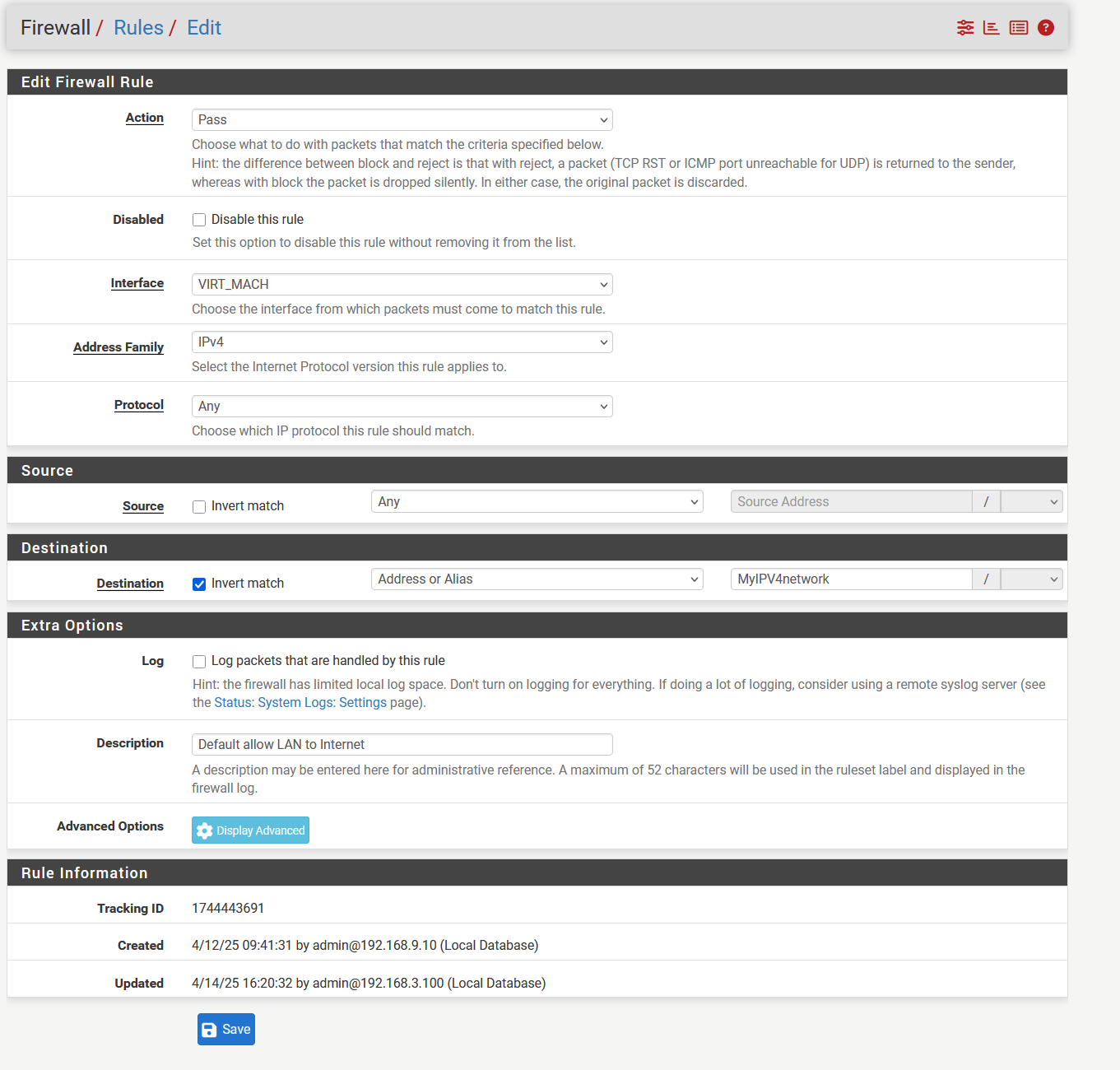

                • L Offline
                  louis2 @SteveITS
                  @SteveITS
                  The 'logging rule'
                  Let me know if you nee more!

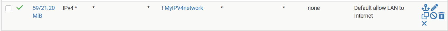

                          @louis2 Try a Status/Filter Reload to ensure they're loading?
                          here are mine:
                          no advanced anything set:

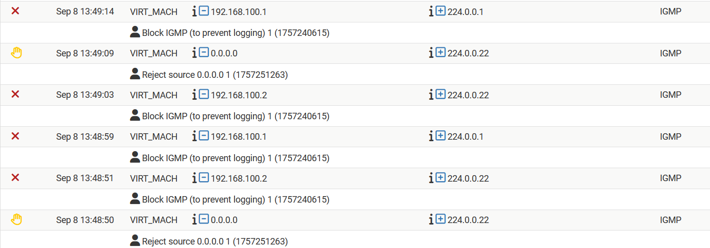

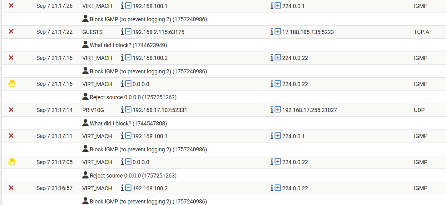

                            Hum ... I did reboot the FW ..... which changed the behavior .... what should not be the case ....
                            The first rule in my 'rule-group' blocks the packet now
                            And a unkown rule generates a 'reject source' message ..
                            The whole thing is bizar in multiple ways .....
                            note: alias MyIPV4network = '192.168.0.0/16'
