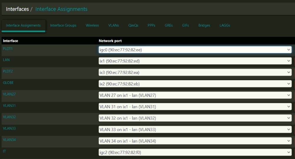

      Good day!
      Netgate 8200 MAX Configuration
      ix1 port → LAN, VLANs: 27, 31, 32, 33, 34, 35
      TP-Link SG3428X (connected via TP-Link DAC Cable)
      Port 25 → Trunk connection to pfSense ix1 port
      Ports 3–6 → Assigned to VLAN 27
      When I connect a laptop to Ports 3–6, it still receives a LAN IP instead of a VLAN 27 IP. What could be the issue?
      Interface Assignment

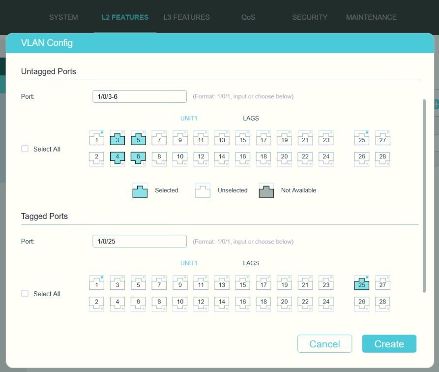

      TP-Link SG3428X - VLAN Config

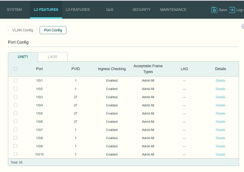

      TP-Link SG3428X - Port Config

        @smsigroupit that does look ok. Port 25 is the trunk, untagged VLAN 1 and tagged VLAN 27. Port 3 to 6 have PVID set to 27.
        I assume the 'VLAN Config' is done for VLAN ID 27 (that top part of the picture is cut of).
        And can you show the VLAN interfaces list and the VLAN 27 interface configuration on pfSense?
          • Yes.

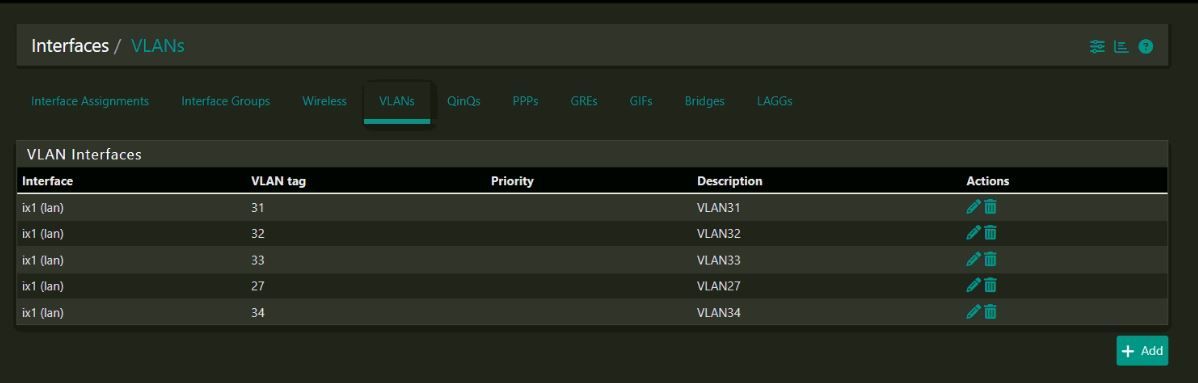

          06a69ec0-72ae-4cde-b914-88be779e74cd-pfsense VLAN interface assignments 01.JPG

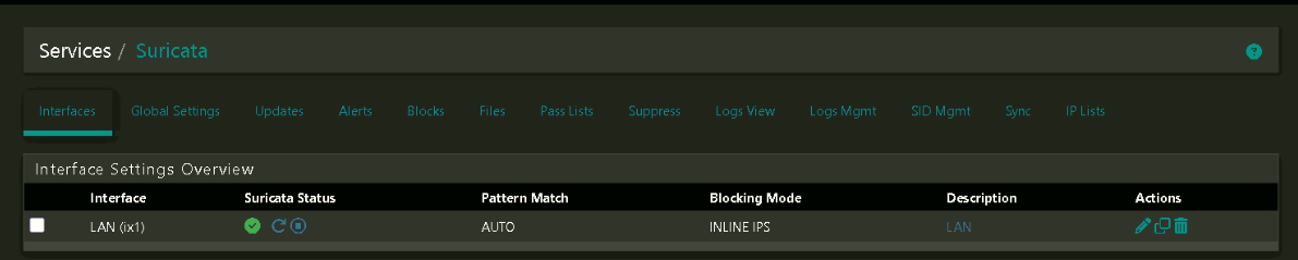

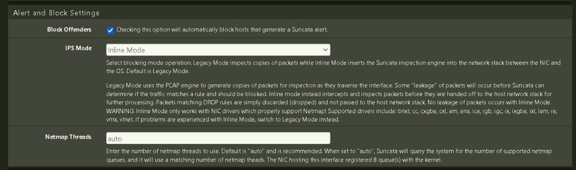

                                        When I disable Suricata, the VLAN works correctly. Which Suricata configuration could be interfering with VLAN functionality?
                                        S patient0P 2 Replies Last reply Reply Quote 0
                                          smsigroupit @smsigroupit
                                          Suricata Config;
                                          • patient0P Offline
                                            patient0 @smsigroupit
                                            @smsigroupit said in Netgate 8200 MAX VLAN & Switch Configuration Issue:
                                            I never used Suricata, someone else has to chime in. A search in the forum for 'suricata vlan' could be a start.
                                            For example Important Info: Inline IPS Mode with Suricata and VLANs, post 4 talks about having to disable hardware features on ix0 to make it work with VLANs.
