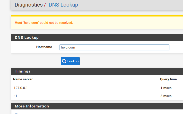

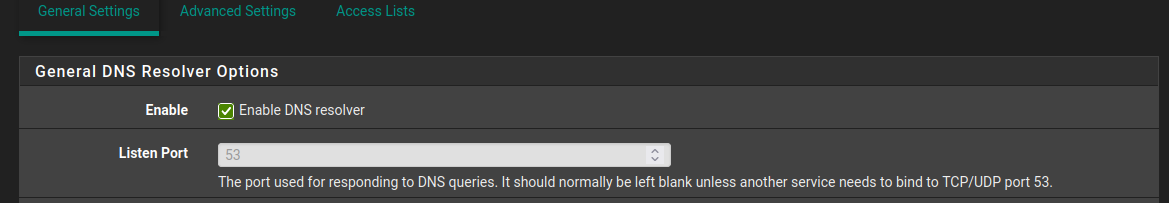

      I have been tasked with ensuring our firewall uses a specific DNS server and only that server. Under the General settings tab, I specified the desired IP and hostname for TLS resolver, and everything appeared to work OK.
      To test, I removed the DNS IP address and TLS hostname, and restarted the firewall. Then used the firewall's Diagnostics->DNS Lookup to test. To my surprise, an IP address was returned. I was expecting it to be not found/not resolved.
      Where is the firewall getting its DNS information from? I presume from the upstream WAN, which if that is the case that is not permitted. Is there a way to prevent that? Or is there some other misconfiguration? Any help is greatly appreciated. These are my settings:
      38922231-ce03-4ff4-9891-96c8609a4c3b-Screenshot From 2025-09-16 14-47-59.png
      /home/mike/Pictures/Screenshots/Screenshot From 2025-09-16 14-47-59.png
      tinfoilmattT GertjanG 2 Replies Last reply Reply Quote 0

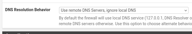

            On your DNS Resolution Behavior , try changing that setting to Use Remote DNS Servers, Ignore Local DNS.

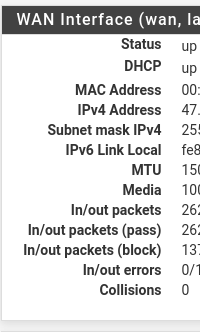

              Is your WAN interface receiving the ISP's DNS servers via DHCPv6 (Status / Interfaces)?
                  No I don't think so

                    • G Offline
                      g289519 @Uglybrian
                      @Uglybrian said in Confused about DNS setup:
                      I made that change, rebooted, DNS still working without any DNS server specified. Thanks for your reply.

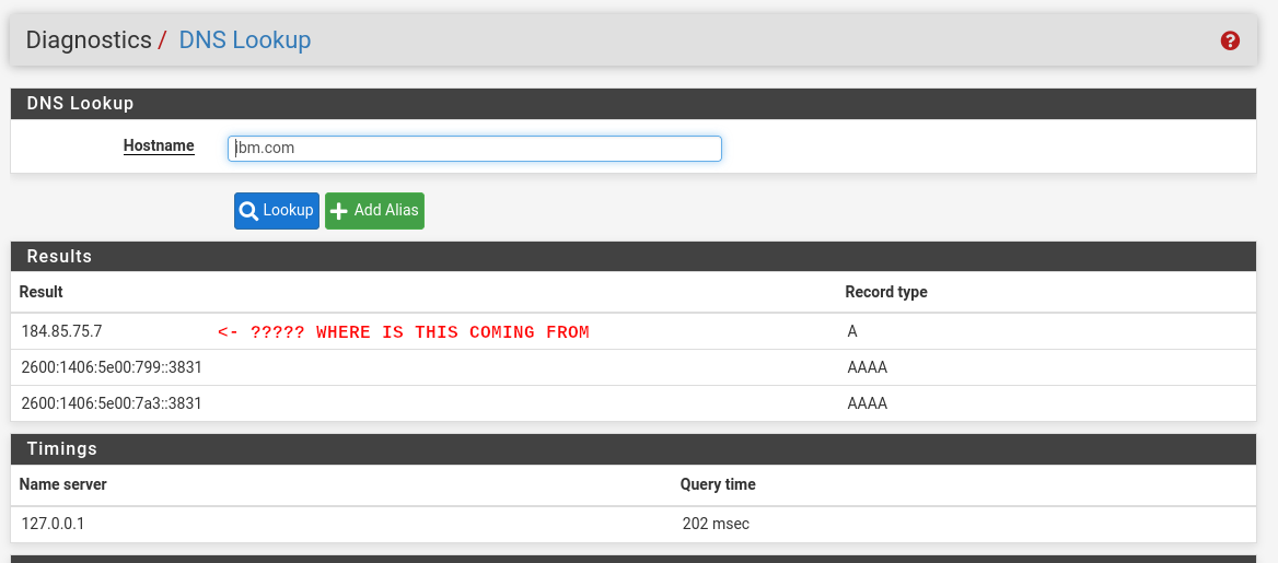

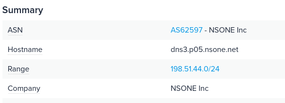

                          @tinfoilmatt I will take a look thank you. I ran a packet trace and came across this:
                          01:09:00.598828 IP 198.51.44.69.53 > 47.224.233.232.57987: UDP, length 92
                          I looked up 198.51.44.69 and it is
                          And that is precisely what is going to get my audit to fail unless I can come up with a good explanation. No outside DNS server allowed per policy.
                          tinfoilmattT 1 Reply Last reply Reply Quote 0

                              Does that DNS answer offer any clues about where it's coming from? It's possible ISP is simply redirecting 53/853 traffic wherever (after sniffing the lookups of course, lol).

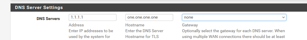

                                  Gertjan @g289519
                                  @g289519 said in Confused about DNS setup:
                                  IMHO, you missed a step.

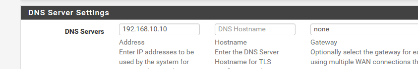

                                  First, you have to indicate a DNS server you want to use : example :
                                  or, if you have a local, on pfSense's LAN or nearby, on it's WAN :
                                  This could be a pi hole, a Windows DNS server or a local company DNS server : a DNS server that is under local or your control.

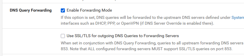

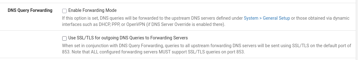

                                  Then, instruct the resolver to forward to this IP :
                                  If this DNS server, like 1.1.1.1, supports TLS you can also enable TLS Forwarding (the second check box).
                                  To make sure all LAN devices use no use your defined DNS server, block all DNS traffic = port 53, UDP and TCP, for IPv4 and IPv6, and only allow LAN devices to contact pfSense (using port 53, UDP and TCP, for IPv4 and IPv6).
                                  If needed, create also a pass rule to allow port 853 TCP to pfSense and afterwards a block rue for 853 TCP, any destination.
                                  And check :
                                  From now on, your LAN devices can only ask pfSense for DNS info, and pfSense, the resolver which now has become a 'dumb' forwarder, will forward the request to the IP you specified. It won't go anywhere else.
                                  If the path to 1.1.1.1 is broken (blocked, shut down, whatever) then your pfSense (and LAN) DNS will fail.
                                  tinfoilmattT G 2 Replies Last reply Reply Quote 0

                                      Gertjan @tinfoilmatt
                                      @tinfoilmatt
                                      Ah ....

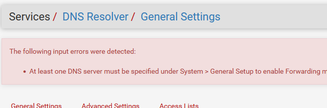

                                      Putting the resolver in forwarding mode without any DNS servers listed on the General will fail :
                                      so exit forwarding mode.
                                      The resolver will then resolve as that is its job.
                                      Stopping it then seems the only good solution (with the LAN(s) firewall rules mentioned earlier).
                                      Leaving unbound (the resolver) running while blocking its outgoing traffic over WAN is ... strange/counter productive.
                                      What seems to works : set up a forwarding IP on the General settings page as shown above.
                                      Now, the resolver can be put in forwarding mode without complaints.
                                      Back again tho the general settings page, remove the DNS IP listens and save that page.
                                      After the save, I checked, the resolver was still running.
                                      But :
                                      and on my PC :
                                      C:\Users\Gauche>nslookup google.com
                                      Serveur :   pfSense.bhf.tld
                                      Address:  2a01:cb19:dead:beef:92ec:77ff:fe29:392c
                                      *** pfSense.bhf.tld ne parvient pas à trouver google.com : Server failed
                                      This seems to look ok - I managed to break DNS.
                                      tinfoilmattT 2 Replies Last reply Reply Quote 1
