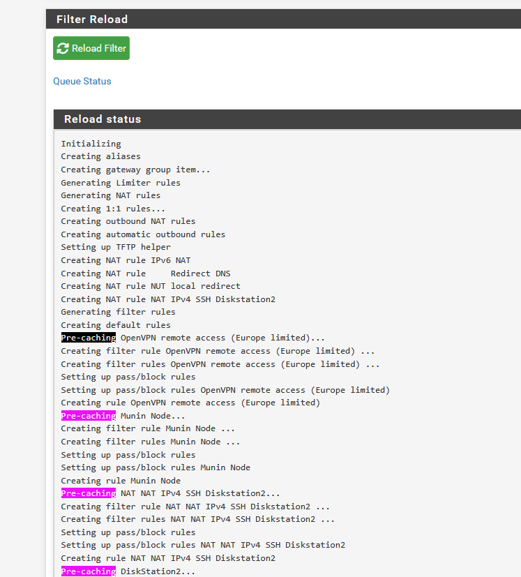

            @SteveITS you might be on to something here. The filter reload states no errors, but it stops at:
            Pre-caching BLOCK ANY
            While when I reload the filter on any other PF box, it ends with:
            Running plugins
            Done
            I'll try to find out what there is about this rule first and keep you posted.
            And to be complete: The tables act as expected before and after removal.
              Dakpan @SteveITS
              @SteveITS lets post the first addon right away:
              The Filter Reload page stopped on a rule with this value in the description:
              BLOCK ANY | No internet via this device
              Apparently the refresh script crashed on the pipe character, I renamed the description to:
              BLOCK ANY - No internet via this device and the Filter Reload page reached the end line Done
              For now it is to soon to tell if this character messed up the filter or just the Filter Reload output.
              To be continued...

                      Gertjan @Dakpan
                      @Dakpan said in Alias edits causing firewall rule black holes:
                      but it stops at:
                      I see a lot of these Pre-caching
                      If your reload stops (breaks ?) at the first then changes are great that the firewall get only partially reloaded ... and that would explain strange filter results (is think I would call this a critical salutation I guess).
                      That said, I 'Filter reload' yesterday and didn't saw any "Pre-caching ...".
                      My thoughts : you have firewall rule that 'breaks' things ?

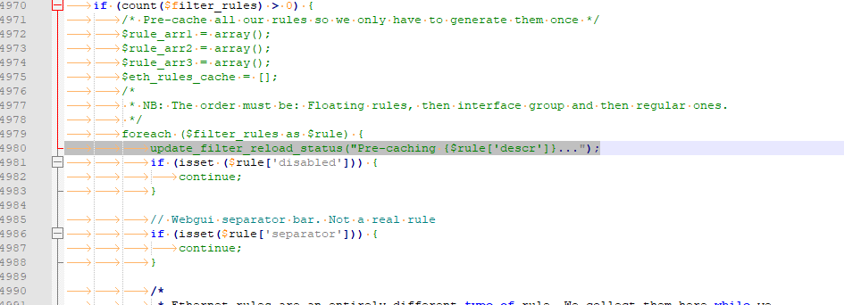

                      Btw : while I could find :
                      in my /etc/inc/filter.inc (I'm using 25.07.1)
                      If you have an issue, it happens around that place.
                      The same file on github :
                      pfsense/src/etc/inc/filter.inc
                      is way different ?!?!! (a lot of work in progress)
                      The github == the source, has ... a lot of recent modifications in it ... ๐Ÿ˜Š
