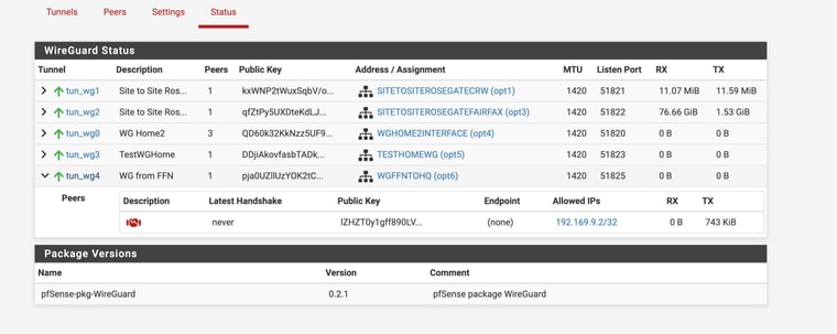

      I am back to the setup again - and still trying to get past the same issue that I had initially (whhere I can't seem to get a hanshake)

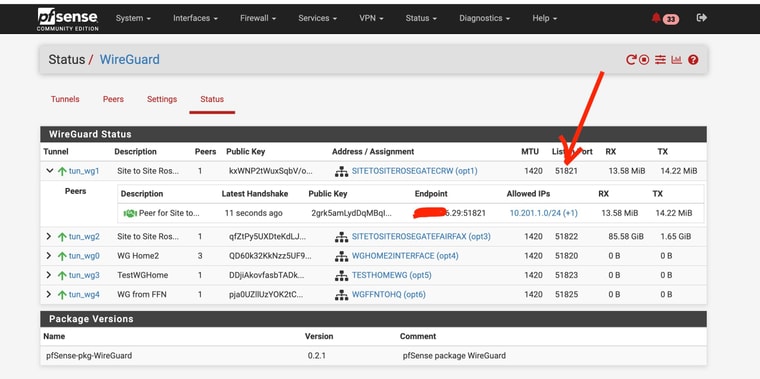

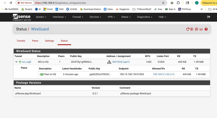

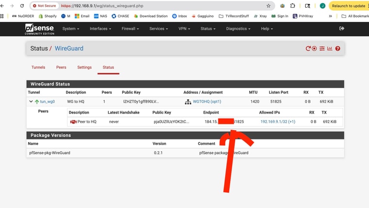

      I have a screenshot of the status page of the device that is behind CGNAT that should be initiating the tunnel
      I relaize that there are many things like the WAN rule allowing 51825 in , etc
      But is there a good way to troubleshoot WG connections that won't do a "handshake". (now that I know it should happpen going out from the CGNAT device)
      1st screen is the remote CGNAT device status
      2nd is the one with public IP
      I can send screenshots of Rules or anything just to get me past the 15 to 20 hrs I've spent on this.
      As you might can see -- I have been succesful in setting up WG connections before - both site to site and client to server

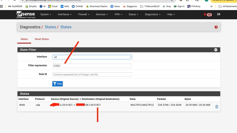

        Are you now able to ping from the client to the server outside the tunnel?

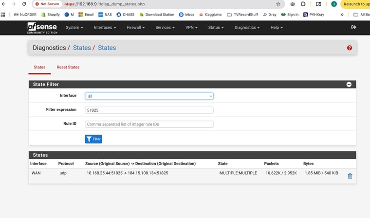

        I would check the states at both ends and filter by :51825. Make sure you're seeing WG opening states at both sides. And that they have two way traffic on them.

          As far as the States - I sent screen shots form the running site to site on port 51821
          AND I ssent screenshots from the non working connection with the client behind CGNAT 51825
          Looks there is some partial traffic but not 2 -way traffic!

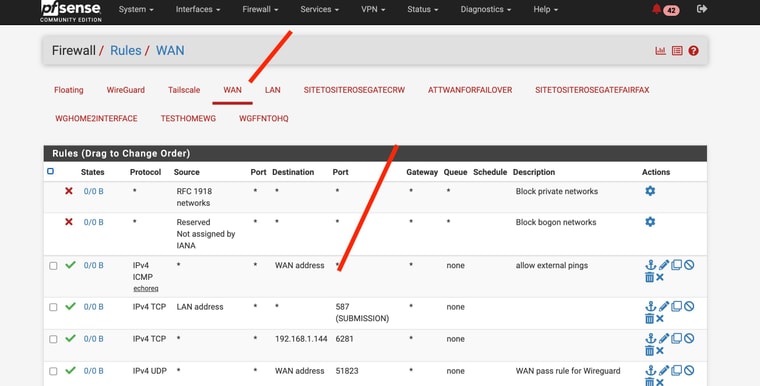

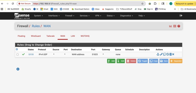

          NOT SURE about the ping thing -- I have seemingly enabled ping to pass but I can't seem to ping my firewall from any device or any internet source BUT I have running services that are easily accesible from outside - that are coming in via https and haproxy
            SteveITS Galactic Empire @ahole4sure
            @ahole4sure ICMP to the public WAN IP from "any"/Internet would be allowed on the WAN interface which doesn't have that rule in your screenshot (may not be the right router).
            ICMP to the public WAN IP from LAN would be a rule on the LAN interface, though that has a default allow all rule.
            ICMP from within the VPN would be a rule on the Wireguard interface.
            ICMP/ping is not required for other services to work.

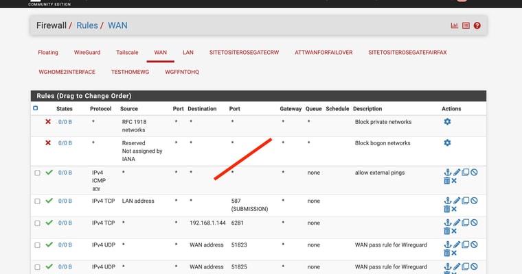

              Ok so some weird info --
              I continued to not be able to ping - even with the rule (I think the screenshot you were referring to was my other router that I had not made that rule yet)
              That made no sense -- so
              I just temporarily disabled packet filtering all together -- result
              1. I was then able to ping my main router
              2. the previously "non-connecting" tunnel from the router behind CGNAT made the connection
              I then renabled packet filtering
              • became unable to ping my main router - depspite rule being in place
              • the WG tunnel remained connected!
              Seems like whatever is responsible for my "firewall" is not working correctly. I had rebooted last night and that didn't cause the incoming from CGNAT 51825 traffic to start -- but disabling the filtering did

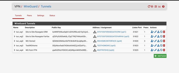

              ?? - any suggestionsImage 9-24-25 at 3.27 PM.jpeg Image 9-24-25 at 3.26 PM.jpeg Image 9-24-25 at 3.17 PM.jpeg Image 9-24-25 at 12.32 PM.jpeg

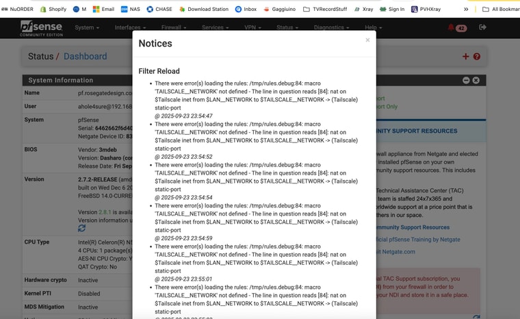

                @ahole4sure What are the 42 alerts at the top? ;)
                The 0/0 in the Status column means no matching connections at least since counting started.
                Try a Diagnostics>Filter Reload.
                https://docs.netgate.com/pfsense/en/latest/troubleshooting/firewall.html#new-rules-are-not-applied

                  ahole4sure @SteveITS
                  @SteveITS
                  I'll try the filer reload thing
                  Thanks
                  The alerts are an error that kept coming up after I restored a backup - with some mismatched interface assignments - etc
                  Do you have any suggestions on how to get rid of the error?
                  Can I get rid of the issue at an ssh level ??
                  If I recall right it is a rule on an interface or network that doesn't even exist and is not shown in the GUIImage 9-24-25 at 6.05 PM.jpeg
                    The tailscale interface should not be assigned.
