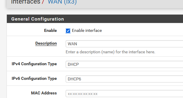

      I had my IPv6 working before and one day I realised my internet is acting weird on certain addresses and devices. Last 2 days, I've seen that all of my IPv6 traffic is being blocked by pfSense and I haven't changed any setting before the issue occured.
      I have found that turning off IPv6 connectivity on my WAN also fixes my internet acting weird.

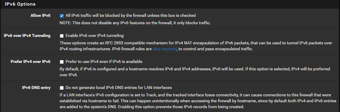

      Advanced > Networking > Allow IPv6 is checked.
      Rules are correct and it allows all IPv6 traffic.
      I can't even ping Google. I can get a IPv6 prefix and devices get IPv6 addresses.
      I can ping LAN devices over their temporary IPv6 address but outbound is completely blocked.

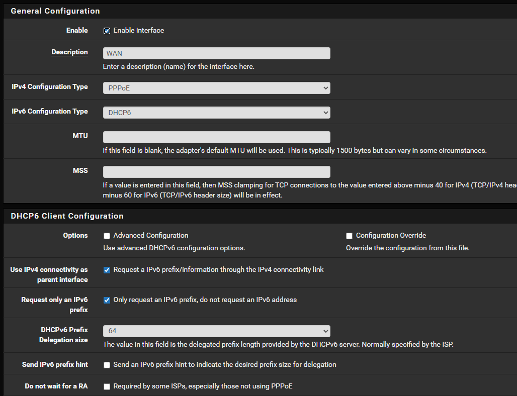

        How is your WAN IPv6 set up ?
        Like :

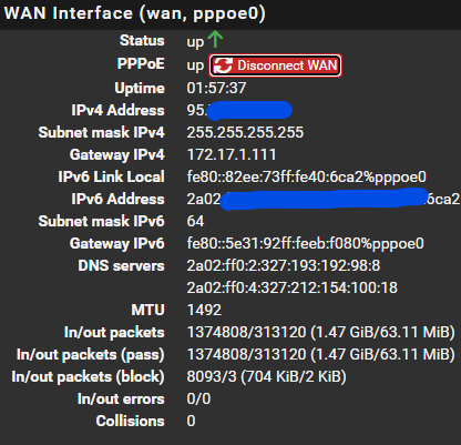

        Check : Status > Interfaces
        Did you WAN got an IPv6/128 to work with ?

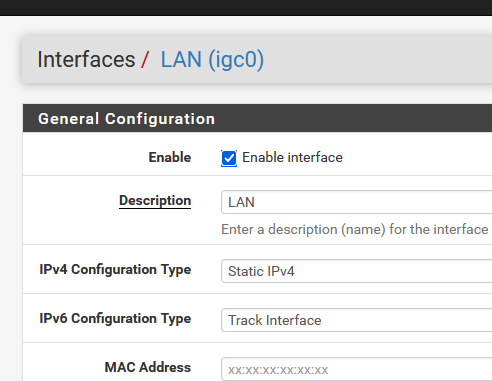

        and way more important : did you get a /64 "prefix" that you've assigned to LAN (using tracking) ?

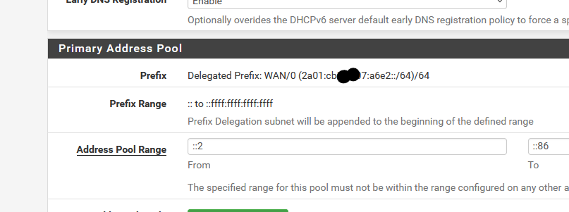

        Did you set up the DHCPv6 server on LAN, and does it show this IPV6 prefix assigned to you by the upstream ISP router or ISP "upstream" ?

          That's my WAN:
          Yes, i get IPv6. Here's the status page:

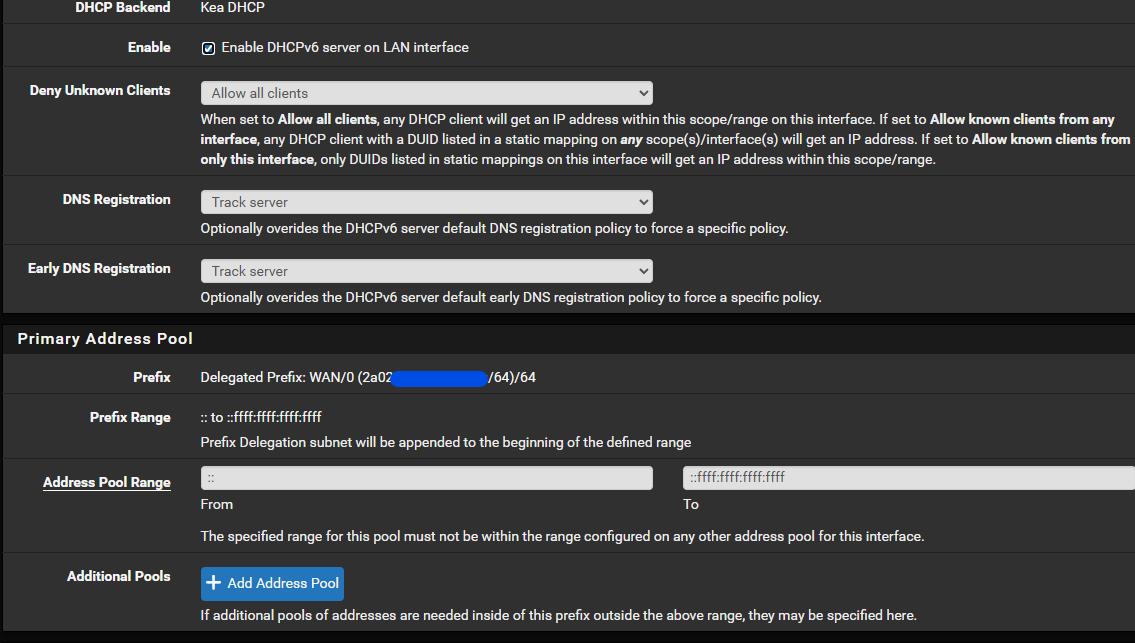

          Yes, I set up DHCPv6. It shows the prefix.

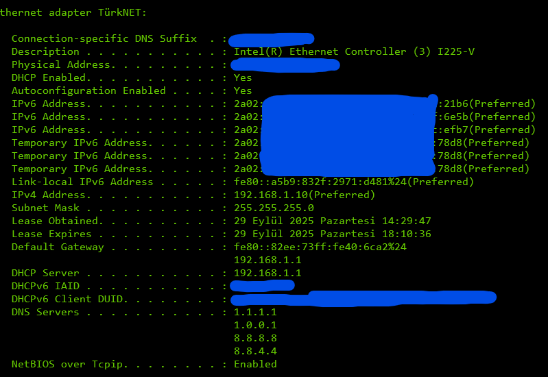

          And yes, also my device gets an IP with that prefix:

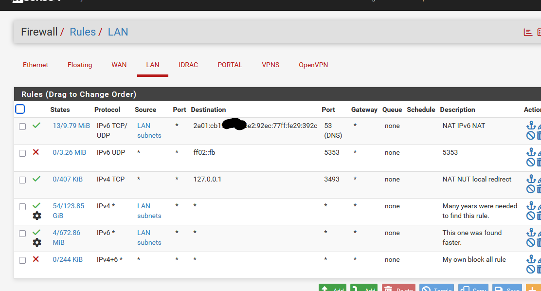

            Consider my first 3 LAN rules as "don't care", look at my 4 & 5 rules :
            The last rules is my own 'block all'.

              I have these 2 rules as well, you can see on the first post.

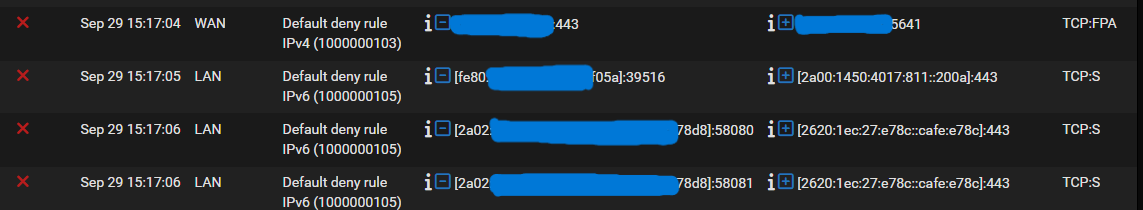

              On logs it says it is being blocked by a default deny rule but i have no clue what and where it is.

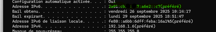

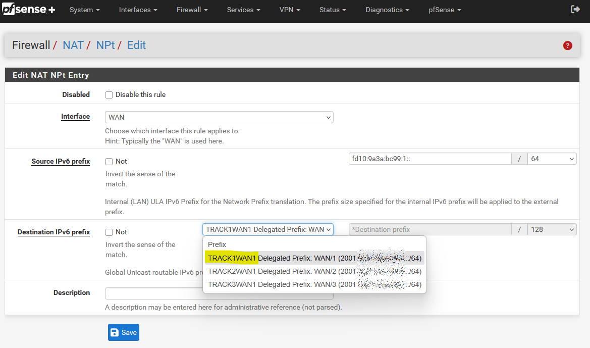

                Show them completely or do you have static IPv6. That Windows is showing three preferred "IPv6-Addresses" alone shows that here is a problem. Often though the problem is with pfSense itself and you might not be able to fix it. There were already two prefix-changes from your ISP but your Windows doesn't know about those and that is most probably on pfSense.
                If the problem is persistent for you, you could deploy ULA on your LAN and then do NPt (tracked from an unused VLAN). That has the benefit that for Windows, the prefix never changes because it only knows about the ULA.
                In my example, the ULA-prefix is from my LAN and the tracked prefix is from a VLAN named "TRACK1WAN1".

                  No, my IPv6 is not static. They came out when I restarted my WAN multiple times while tryna fix it today. And one seems "Deprecated" right now.

                        "ipconfig /all" will show a list:
                        Ethernet adapter Connection Name:
                        IPv6 Address. . . . . . . . . . . : 2603:300a:***:34b(Preferred)
                          Temporary IPv6 Address. . . . . . : 2603:300a:***:8b18(Preferred)
                        I've seen my PC have 10-15 or so, and yes if it changes the old ones have to die off or be removed so Windows will start using the newer ones.
                        netsh interface ipv6 delete address interface="Connection Name" IPV6HERE

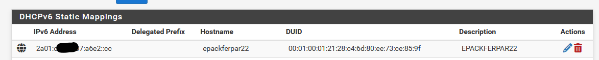

                            If you use / stick with DHCPv6 (server) you can use this :
                            to make a 'static DHCPv6 lease" :
                            and from then on, that PC will only get the (one) ::cc IPv6, with the current prefix prepended.

                                    @crazypotato142 Check the IPv6-addresses closely, are they really using the same prefix or do they differ. It must be the same prefix as pfSense LAN has.
                                    In Windows use ipconfig /release6 and then ipconfig /renew6 and watch out for problems.

                                      @Bob.Dig They are like this right now:
                                      Photos deleted for privacy
                                      Note: I can't ping an IPv6 address over pFsense interface either.
                                      • Bob.DigB Offline
                                        Bob.Dig LAYER 8 @crazypotato142
                                        @crazypotato142 The first address already looks wrong. At least the prefix is the same.
                                        crazypotato142C 1 Reply Last reply Reply Quote 0
