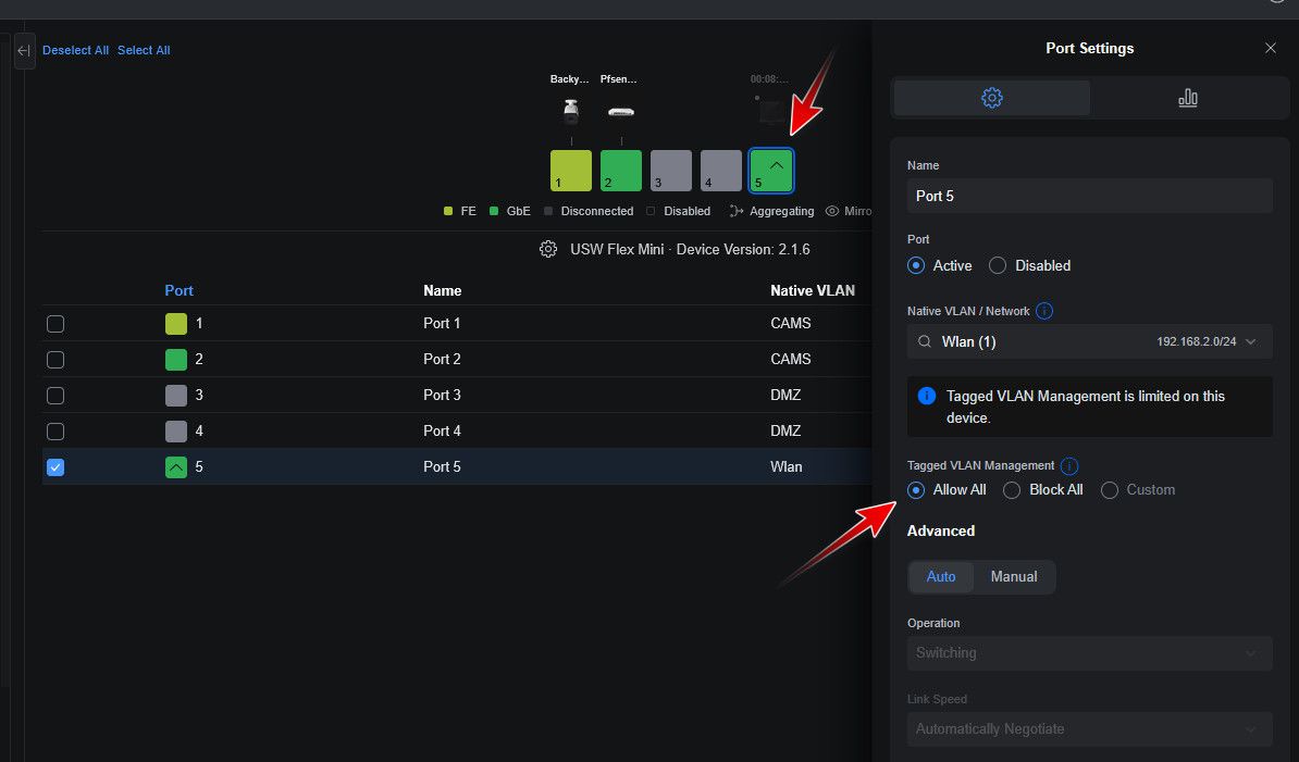

          example - here is a little flex mini have on my network
          So port 5 allows all tagged traffic, where my vlan 2 is native and untagged. Then the other ports are in just other vlans as native, tagged traffic is no allowed
          So what switch do you have from unifi? You would need to setup the controller, adopt the switch and then setup what you want. Creating the vlans in the controller, etc.
          I was not aware of switches from unifi you could control without the controller software?
          Other switches allow you to control which specific tagged vlans can be allowed on a port. But the mini its all or none

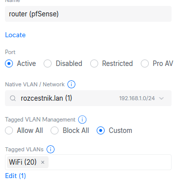

                  • O Offline
                    Octopuss @Octopuss
                    Ok it doesn't work anymore all of a sudden. I am totally cluless now.
                    I didn't change any settings.
                    This is the port that pfSense is connected on, and this is basically how I set all the ports that had anything related to the wifi subnet connected to them, and it worked. Now it doesn't. Restarting both the switches and pfSense box didn't change it.
