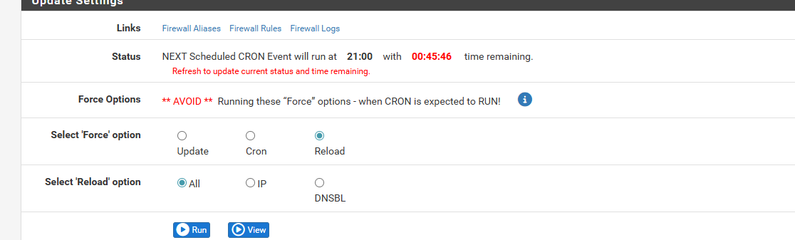

      I can't force reload, I only select reload all without effect

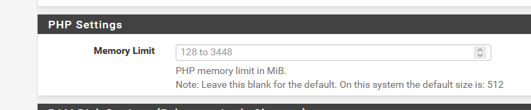

          You raised the internal PHP work memory to the max possible :
          I typically use this list to put a system (the PHP subsystem, its limited RAM buffer) to the max for a while.

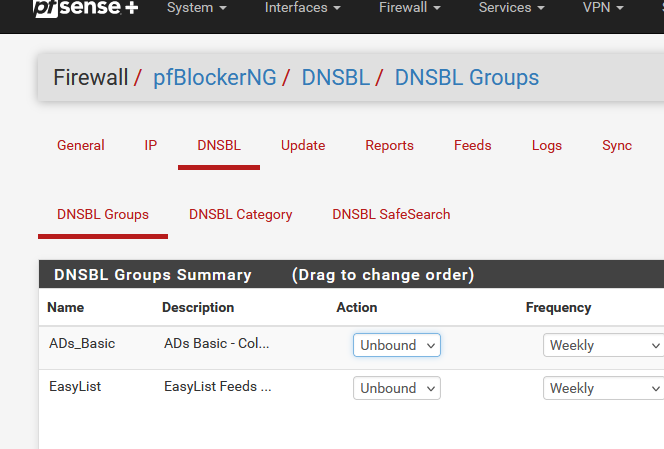

                      My DNSBL page :

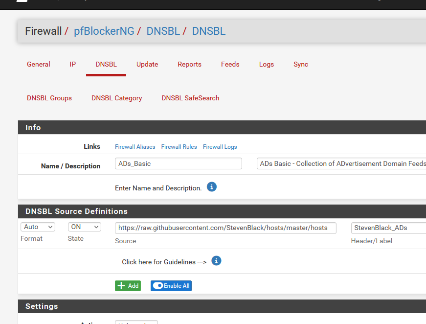

                      I'll take "ADs_Basic" as an example, let's open it up :
                      Now I have a file name : https://raw.githubusercontent.com/StevenBlack/hosts/master/hosts
                      Have a look at that file : https://raw.githubusercontent.com/StevenBlack/hosts/master/hosts

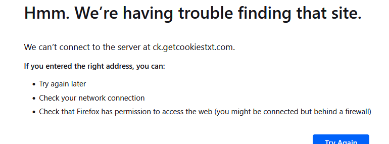

                      The answer was ... 0.0.0.0
                      Your browser would do the same thing : It will first do an identical DNS request for "ck.getcookiestxt.com" and receive 0.0.0.0 as an answer. It won't even try to connect to 0.0.0.0, and just show the situation :
                      so all is fine.

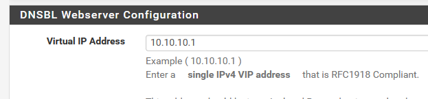

                      The browser gets the IP of the host name first, as above.
                      When you use "DNSBL Webserver/VIP" method, it is not 0.0.0.0 (the Null answer) that gets returned, but :
                      as 10.10.10.1 it will be.
                      Good news ! This one answers the request !! It's the "DNSBL Webserver/VIP" after all.

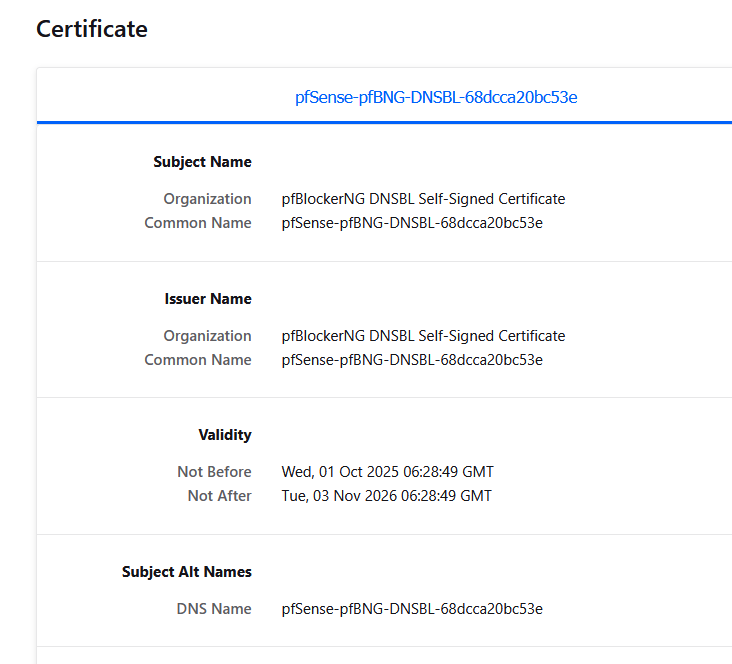

                      As the browser is using https it will receive a certificate from this web server.
                      This certificate says it is :
                      The browser goes full 😲 😰 😠 👽 mode as it wants the certificate that says "I am ck.getcookiestxt.com", not "I am pfSense-pfBNG-DNSBL-68dcca20bc53e". You'll see another browser fail message.
