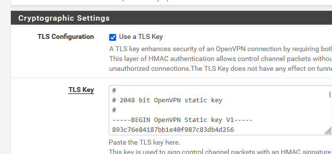

      So about to deploy and OpenVPN Setup on PFSense 2.8.0. Everything is working great in my tests and the configuration I have seems to be correct. I have set my users up by sending out the OpenVPN client profile using the OpenVPN Client Export utility and they are in the process of installing this now.
      I have this set up using a Certificate signed by a Certificate broker and third-Party CA. I have imported the CA, the Intermediate CA, and the user certificate files into PFSense. I have the OpenVPN server setting enabled "Use a TLS Key" and had PFSense generate a client key. The Open VPN client export utility exports a profile file that includes two CA certificates (assuming the CA and Intermediate CA I imported into PFSense) embedded in the profile file. All this works fine.
      I'd like some clarity on what this "Use TLS" Setting is doing. I think its essentially generating a client certificate and key from the third-party CA certificates I imported into PFSense, and then including these CA certs and key into the clien profile. When a client connects it then uses this "pre-shared key" to validate both the client and that the server the client is connecting to is the actual server it thinks its connecting to. I additionally am using 2FA with FreeRADIUS to further secure users logging into the service.
      So do I have this correct with regards to what the "Use TLS" setting is doing?
      Additionally, When I change the client certificate I am using, as long as I don't change the CA certificate (and ensuring the CA certs are valid and match up with the new user certificate so the cert chain is intact), I should NOT have to change anything in the OpenVPN client profiles (i.e. change the certificates and key in the file) to have these clients continue working. The key is generated from the CA cert and as long as that does not change, I shouldn't have to do anything with the client profiles when I install a renewed certificate and use it for the OpenVPN server configuration in Open VPN other than import the new certificate and change the OpenVPN server configuration to begin using it. Setting I am talking about:

      Thanks in advance for setting me straight here.

                Still would appreciate an answer on if I keep the same CA will I have to generate a new TLS key for my users if I renew/replace the certificate being used for this VPN.
                  This one :
                  Afaik, that key isn't certificate related.
