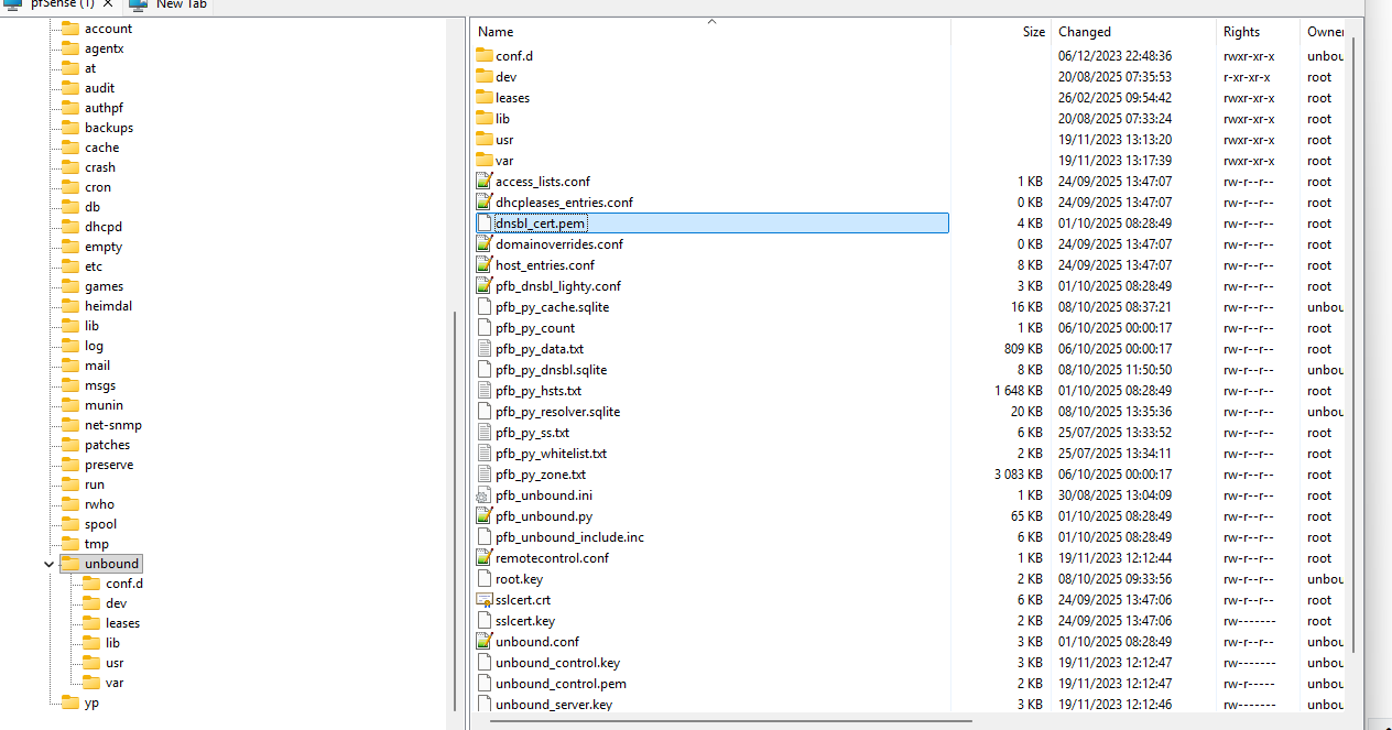

        This is my copy of that 'space' :
        where I highlighted the file that you were missing.
        As you can see, the most important core system folders are also mounted in that special place, as /usr/* /lib/* /dev/* etc

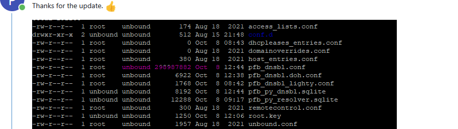

          Thanks for the update. 👍
          Disk space is healthy. it's only used 1%.
          This .pem file is missing in that unbound folder. I have created an empty file and then it's complaint "couldn't read X509 "
          Because it should be a certificate file.
          I am not sure why this file has not created itself.
          I have removed the package and reinstall few times.

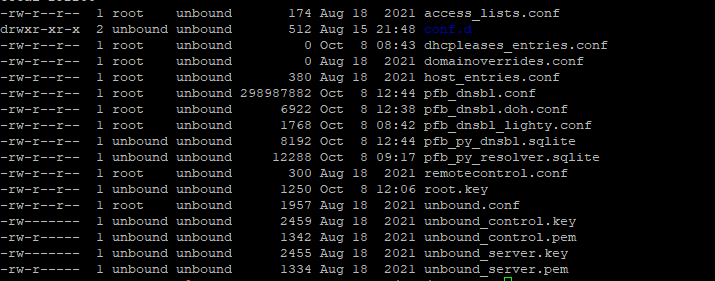

          • P Offline
            popeel-SSH @Gertjan
            @Gertjan

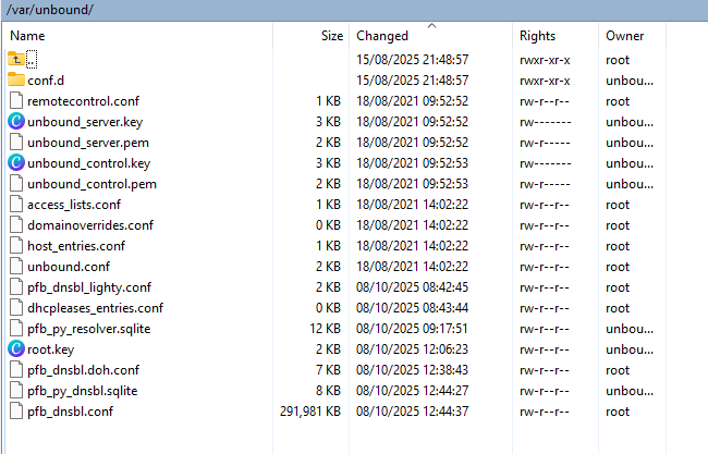

            Looks like I have missed so many files that includes all certificate , SSL files.
              Gertjan @popeel-SSH
              @popeel-SSH
              Yikes ....
              You saw that 298987882 ? That a file size in bytes.
              Or 300 Mbytes or so.

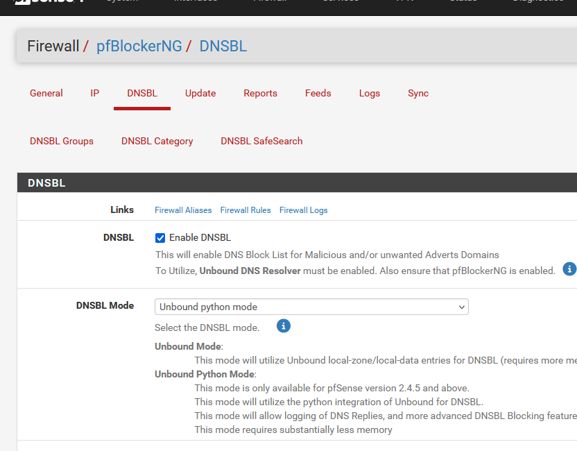

              Please, confirm that you follow the "I use pfBLockerng in '2025' mode" aka 'python mode':
              and if this is the case, delete that huge "pfb_dnsbl.conf" file.
              Hummm, it was created moments ago.
              You are, I guess, still using pfBlockerng with 'unbound' mode.
              Long story short : ..... don't (or at least, be ware of the consequences, like the problem you now have ^^)
              • P Offline
                popeel-SSH @Gertjan
                @Gertjan

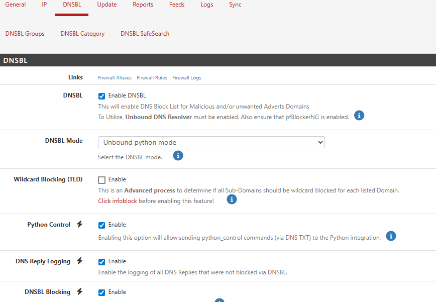

                I used the unbound mode not python.
                I just changed to python mode and force reload all and the issue is still there.

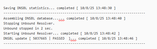

                  During the reload : this part :
                  Saving DNSBL statistics... completed [ 10/8/25 14:30:26 ]
                  Reloading Unbound Resolver (DNSBL python).
                  Stopping Unbound Resolver.
                  Unbound stopped in 2 sec.
                  Additional mounts (DNSBL python):
                    No changes required.
                  Starting Unbound Resolver... completed [ 10/8/25 14:30:28 ]
                  Resolver cache restored [ 10/8/25 14:30:29 ]
                  DNSBL update [ 79112 | PASSED  ]... completed
                  what does your reload log say ?

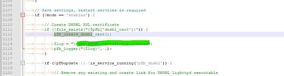

                        Look at : /usr/local/pkg/pfblockerng/pfblockerng.inc line 181 : that where the file is created.
                        That will happen when you (re) install pfBlockerng.
                        So, give that a try ?

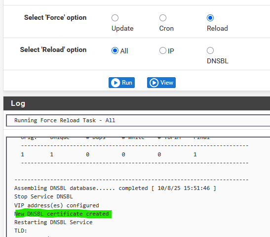

                            My turn :
                            I deleted /var/unbound/dnsbl_cert.pem
                            Now, like you :
                            [25.07.1-RELEASE][root@pfSense.bhf.tld]/var/unbound: ll /var/unbound/dnsbl_cert.pem
                            ls: /var/unbound/dnsbl_cert.pem: No such file or directory
                            I did a full reload (and scrolled trough the resulting log) :
                            You see what happened (green ^^).
                            And the file was there again :
                            -rw-r--r--  1 root unbound 3359 Oct  8 15:51 /var/unbound/dnsbl_cert.pem
                            For some reasons, your 'pfSense' can't create a cert ? Or it can create the cert, but can't save it at the /var/unbound/ destination..... Hummm.

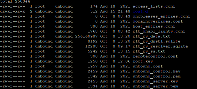

                                    I have reinstall the firewall from the fresh and installed pfBlocker with minimal settings, and it is functioning properly.
                                    After that, I performed a factory reset on the firewall, restore our config.xml, and installed pfBlocker NG with the same minimal settings, but I encountered the same error, and the certificate was not created.
                                    Not sure what is in my config should stop this ??

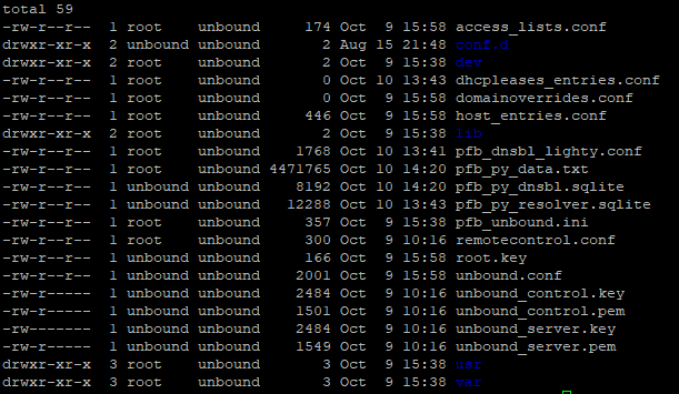

                                    These are the files in my /var/unbound
                                      Gertjan @popeel-SSH
                                      This :
                                      @popeel-SSH said in pfblocker pfb_dnsbl service not starting:
                                      is a null operation.
                                      Your "pfSense" as installed, is always the same.
                                      When you discard your own setup, and go to the default setup, and re assign interface, and make it work again (LAN+WAN), and then import your previous config file, your back at square zero.
