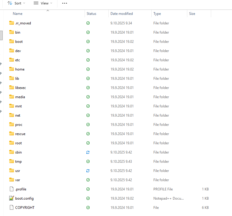

      There is something wrong in ISO image download. I need ISO file to virtual machine, but gz -package has inside only a folder called netgate-installer-amd64.iso, not ISO file that can be mounted.
      I think this case is installation related issue.

        The current ISO installs the installer.
        Run - boot into - the installer. From there on you're guided to the final install, a bit as before. See the official Netgate pfSense documentation.
        The actual files (most current!) will get downloaded and put into place at that moment.

          I just need the ISO file, not set of files in folder.

            @Clouseau you can just burn the file without extracting:

                @ivo.a.v.tavares what are you babbling about? Write the ISO file to either an USB stick, burn it to a CD ROm or mount the ISO file in something like Proxmox and install pfSense?
                  Mmm, not able to replicate that. The ISO file is gzipped. You can extract it and upload it to a hypervisor to install a VM.
                  If you're seeing the ISO contents it looks like your OS has "helpfully" mounted the file which is probably not what you want.

                    @stephenw10 I unzip the installer gz file and see the same. So how to fix? Talking Win 11. I expect to see a iso file too.

                        Can you provide a hand holding how-to to get the current version to work? I get tons of errors when trying to extract the net installer gz file both on Win 11 and Fedora 43. That would save the trouble of update-go-round from 2.7.0 perhaps.

                          @Shack Etcher can burn the .gz file directly, no need to extract it.

                              Nevermind, I futzed around until I found Trend Micro Unarchiver One on my box and it extracted the net installer ISO. I will write it to a DVD and try it.
