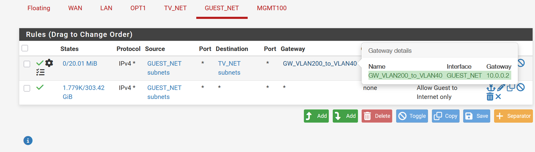

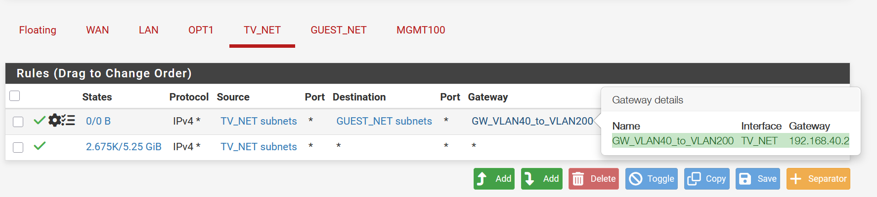

      Hi All.
      We are integrating with a Phillips casting server that needs a static route between the guest network and the tv network.
      Due to the pfsense being aware of the route in the routing table, i canot to standard static routes. As such, I have created the route using gateways, and firewal rules.
      We are getting casting registration ok, and the tv side casting server is seeing the traffic.
      The problem is the reply back to the guest is being blocked.
      For some reason, even though I have an allow rule, the pfsense is over riding it and auto creating a deny rule. See attached.
      Can someone please advise if there is a setting, or something else I am missing to allow this rule. Screenshot 2025-10-09 182319.png Screenshot 2025-10-09 200007 3.png Screenshot 2025-10-09 200007 4.png
      W johnpozJ 2 Replies Last reply Reply Quote 0

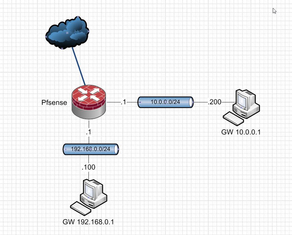

          johnpoz LAYER 8 Global Moderator @wifi-will
          @wifi-will why would you be policy routing to get between networks both attached to pfsense?
          If 2 networks are both attached to pfsense, there is no need for a policy route like that.
          A little drawing of how your networks are attached could be helpful in figuring out what you have wrong.
          I assume your guest_net is 10.0.0.0/? and your tv_net is 192.168.40/?
          If 10.x wants to talk to 192.168.x you just need a rule on guest net to allow it - there is no need a gateway set on the rule.
          example: Basic network with pfsense having these 2 networks on it
          Where pfsense IP on each network is .1 in each network. And then clients on said networks with their own IPs in said network, and they point back to pfsense .1 address in their respective networks as their gateway.
          There is no need to add any routers or gateways on pfsense for this to work. The only thing required is the firewall rules on pfsense allows traffic that you want to allow

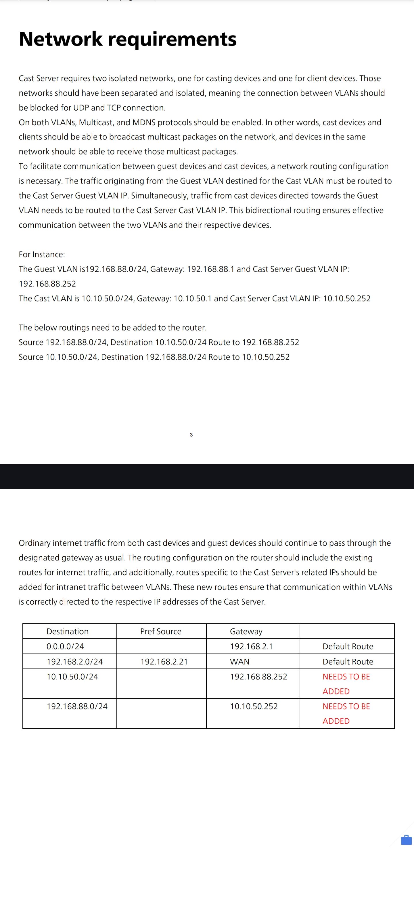

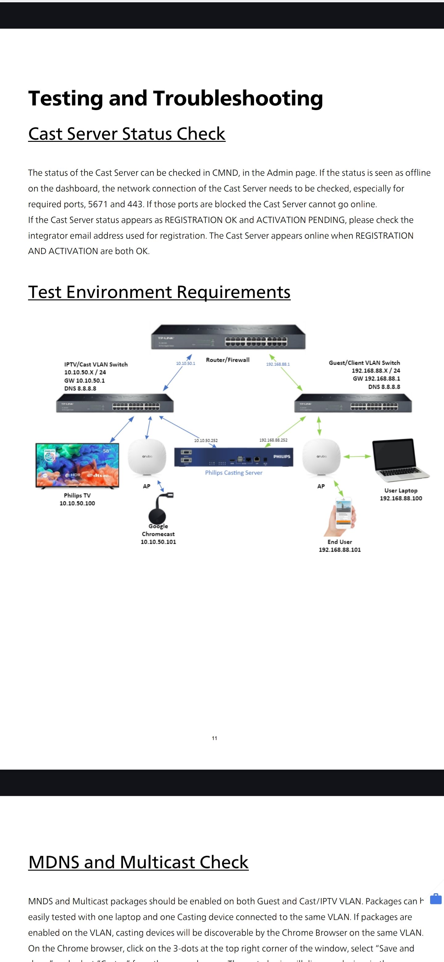

            @johnpoz the casting server has a nic in each subnet. The casting server handles communication between the two with any traffic destined for the TV subnet form the guest, having to be routed by the casting server gateway. And visa versa from TV to guest. 1000002156.jpg 1000002157.jpg
              @wifi-will I would have to spend some time looking over that - but what I can tell you right from the hip is multiconnections like that can be problematic when it comes to asymmetrical traffic.
              But from a quick glance - I don't see why you would create gateways on pfsense and policy route. That makes no sense - and quick breeze over - it states 2 isolated networks.

                @johnpoz seem other vendors have no issue just creating static routes between the network. Unfortunately pfsense doesn't allow it because the route is already know. But we still need a rule from TV to Guest via the server as the gateway.
                  SteveITS Galactic Empire @wifi-will
                  @wifi-will A static route is necessary when you're routing to a network behind another router that pfSense has no way of knowing it exists. In your picture a static route isn't needed because pfSense controls both networks.
