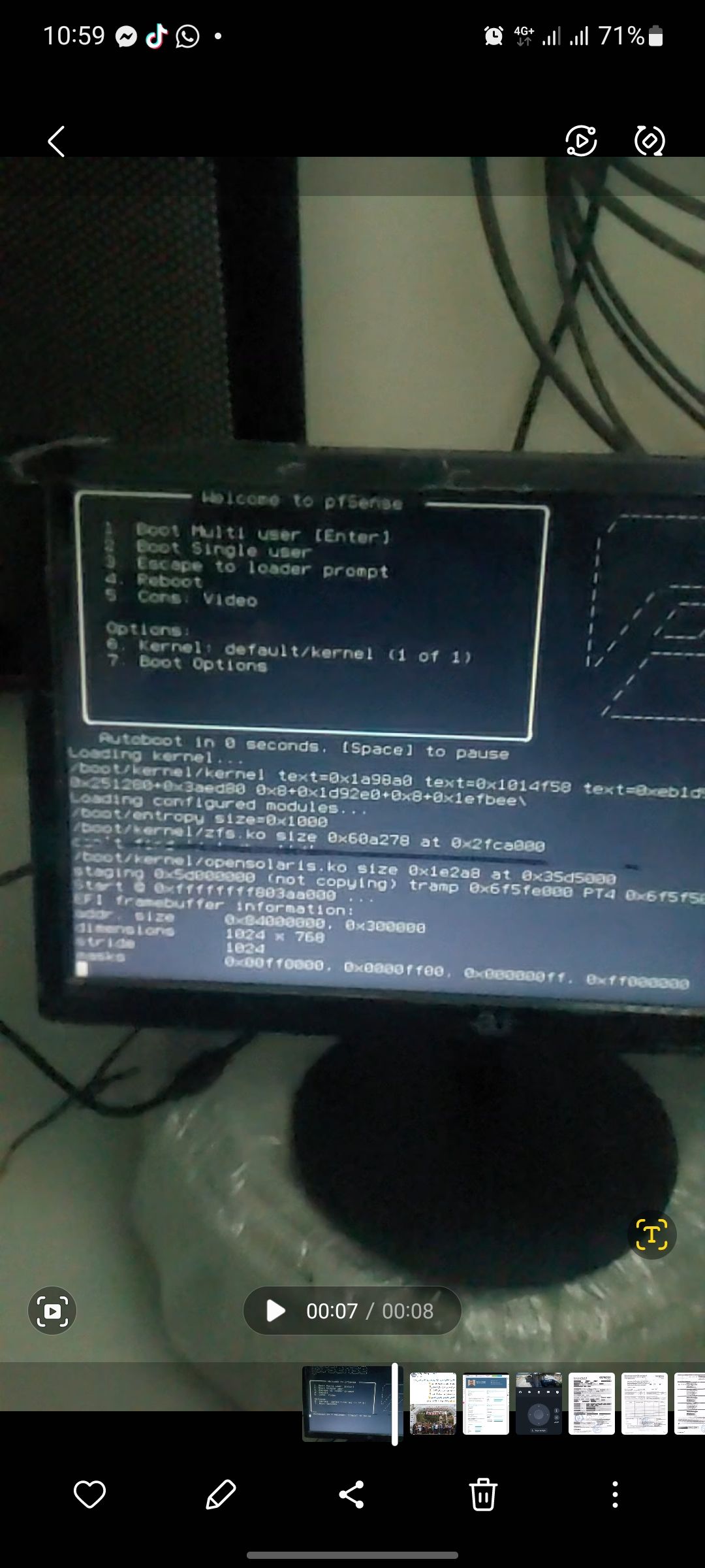

      @stephenw10 said in Fresh install of version 2.8 fails to boot:
      Hmm, odd. Most of those Chinese boxes use a pretty generic BIOS with a lot of exposed options.
      You never said whether you installed MBR or GPT? Or what the installer selects there by default.
      Another thing you can check is boot the installer then drop to the rescue shell and run: sysctl machdep.bootmethod
      That will show you how it's booting when it boots from USB.
      You could also try that from any booted SSD, including OPN. If it's booting differently there that's almost certainly the problem.
      As I mentioned no MBR, legacy, options to select that I could see. AND it worked perfectly before a few months ago and I guaranty I did not play around with bios settings.
      I installed whatever your default is on the installer. Like always.
      I'll try the other thing in a couple of days.
      I completely understand the mbr vs gpt choices. As I said, the loader usb stick always booted perfectly after being built by Rufus using defaults. I used YOUR INSTALLER defaults now and a few months ago when it worked perfectly. With that information you should be able to back into the answer for your question. I'm not going to play gotcha.
      I plan to load OPN in a day or two on the same ssd to see if they have a boot problem. If no problem, then it's the pfSense installer. If there's a problem, I'll try another ssd. If there's still a problem then it's the PC. If not a problem with the new ssd, I will again try 2.8.1. If still a problem then it's the installer and how it writes boot tracks.
      Then fix the 2.8 error that hides the 2.8.1 available upgrade. Then fix the occasional endless plugin installer problem that happens after the 2.8.1 upgrade.
        As I said the installer itself with boot either. But it uses the detected boot type to select the default filesystem for the install. That is an option in the installer, it's always present. You may need to set it manually if your hardware/BIOS boots USB differently to the SSD.
        As as fallback you can always install 2.7.2 from the legacy installer and then upgrade.

            If there's some bug here I'd love to squash it but I've got nothing to work with so far. I can only guess why it's not booting for you without logs or screenshots. ๐Ÿ˜•
            The closest to what you've described I can replicate is trying to boot using an incompatible method but, I agree, I have no idea why that would have changed in a few months.

                  I reinstalled the pfSense ssd back into the offending Chinese box. It continued to fail to boot reliably. Weirdly, it booted into pfSense now every other time or so - no consistent fail or success.
                  Then I loaded OPNsense from the same thumb drive that earlier held the pfSense installer as a trial to see if it worked perfectly like the OPNsense ssd I just took out.
                  Then, after it loaded and ran perfectly I rebooted it several times to see if it stayed on point and didn't flake out into that weird shell.
                  It just keeps running.

                    Hmm. Inconsistent booting from the same device without changing anything is even more weird. Hard to imagine what could cause that. Some slight timing variation perhaps. But from an SSD that's unexpected.

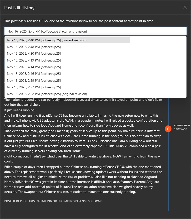

                    • tinfoilmattT Offline
                      tinfoilmatt @coffeecup25
                      @coffeecup25 FYI...
                        coffeecup25 @tinfoilmatt
                        @tinfoilmatt said in Fresh install of version 2.8 fails to boot:
                        @coffeecup25 FYI...
                        Aren't you the clever one. So smart.
                        FYI, I'm a terrible typist. And I never get all of my ideas out the first draft. That's that the edit button is for.
                        Am I supposed to be embarrassed or are you supposed to look smart. Neither is true.
                        Does your discovery somehow prove something about the issue at hand in your mind? pfSense still did not load right.
                        And I'm not using it any longer. OPNsense has no issues like the ones I described and it appears more stable given some of the issues that mut be considered during a common, ordinary upgrade. My main router is OPNsense and so is my spare. And the disk holding the last attempt at pfSense was reformatted.
