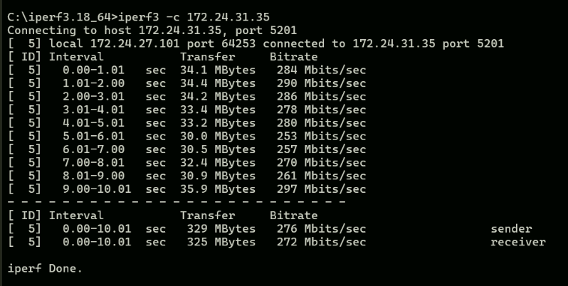

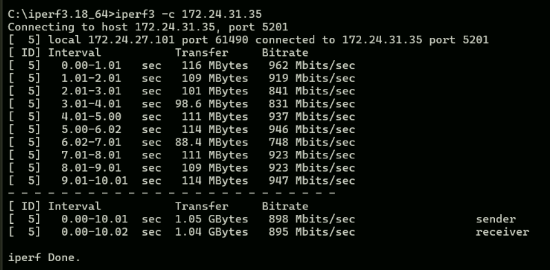

      Good day!
      Device: Netgate 8200 MAX
      Interface: LAN/VLAN (ix1)
      With Suricata in inline mode, throughput falls from ~1 Gbps to ~300 Mbps.
      With Suricata in legacy mode, throughput remains ~1 Gbps.
      What might be causing this?
      iperf results;

          Thank you for the reply.
          Switching Suricata’s Run Mode to Workers resolved the throughput drop. Really appreciate the help!
