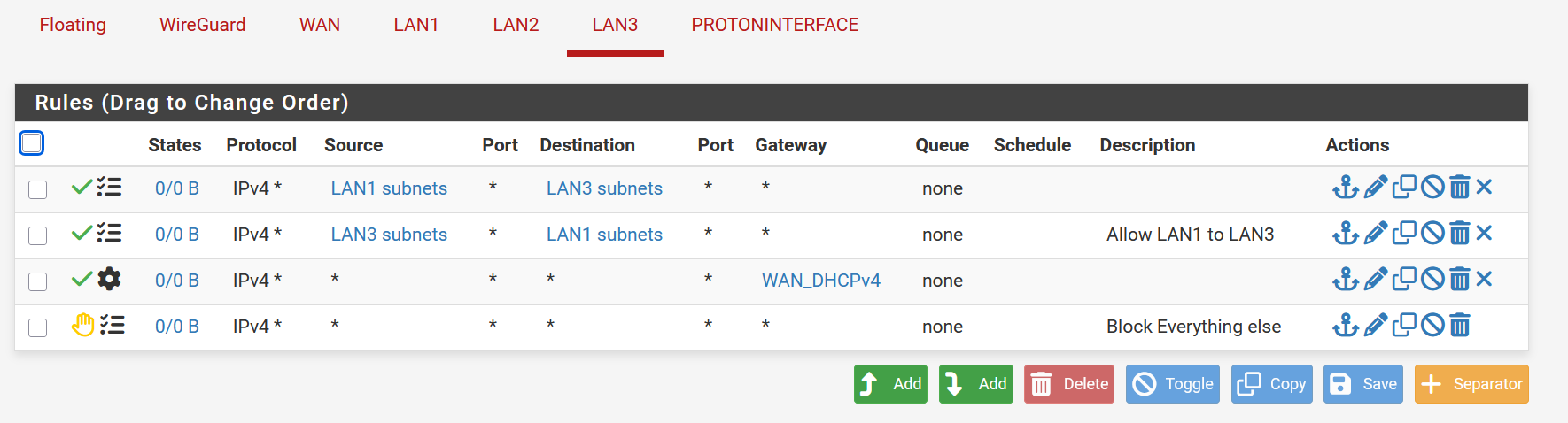

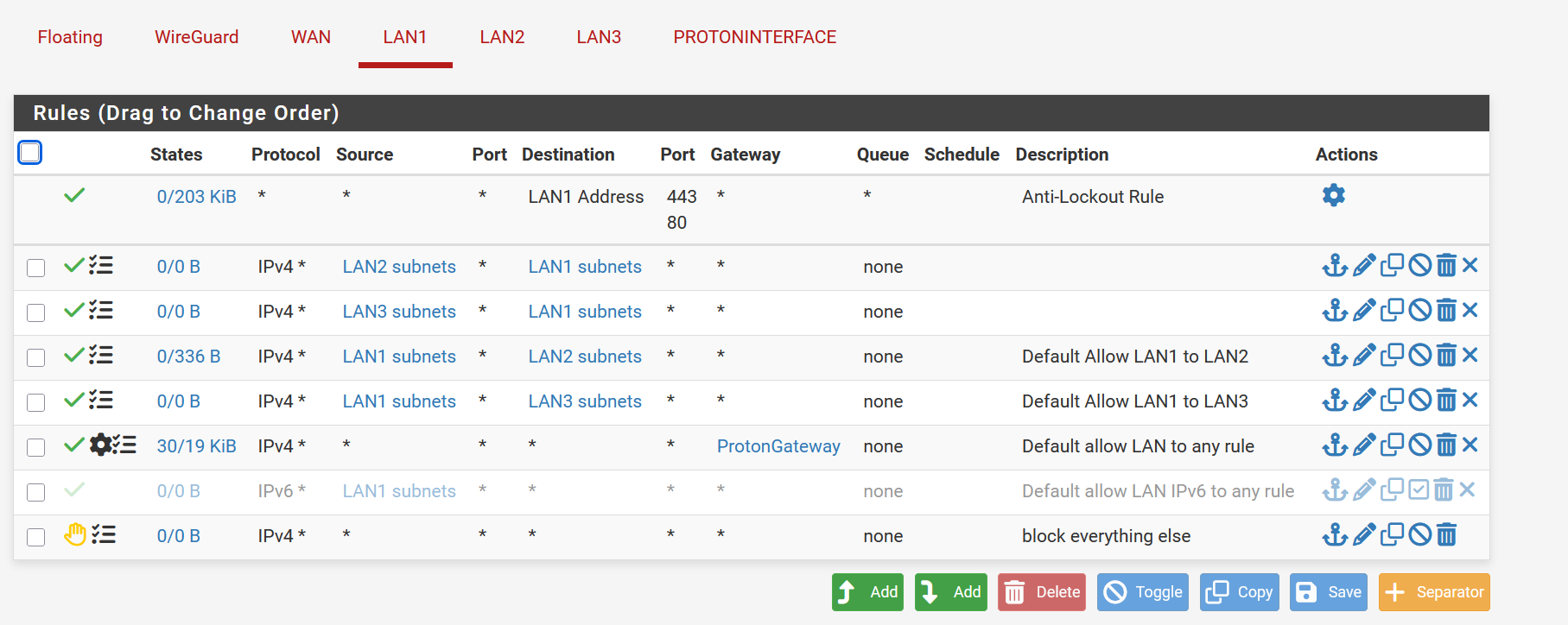

          Did you change your rules. On your rule sets for Destination you need to put LAN1 Address or what ever port addresses you want to go to.
          You can see under your current rules that no states are being made. So those rules ere not being utilized for what for want to accomplish.

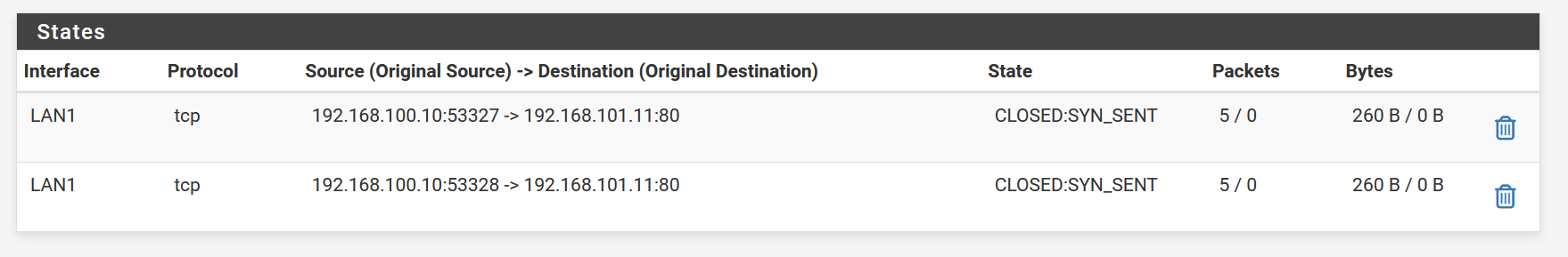

                    I made a screenshot when I finished testing.
                    I tried now to see if I can access the home server on LAN2 because I have internet access there.
                    The rules are useful, they are passing traffic, but I get CLOSED:SYN_SENT state. I have no idea why is that so.

                      • U Offline
                        Uglybrian
                        CLOSED:SYN_SENT- means nothing is replying.

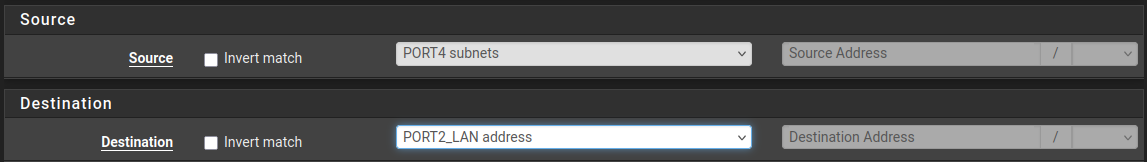

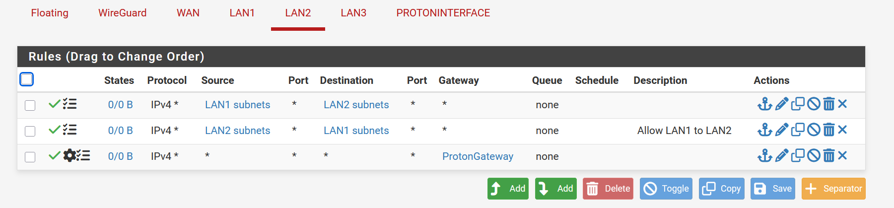

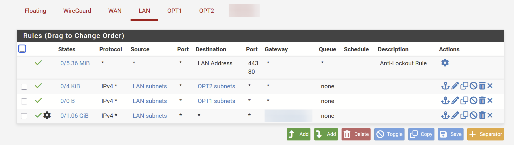

                          As you said, following rule(s) were necessary to access devices on OPT1 and OPT2 respectively.
