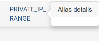

      Hello Professionals,
      Can anyone had experienced this issue before?
      My new Netgate4200 firewall doesn't show me the details of Alias. Rules what I made are working great though.
      I have tried update OS, but still same problem.
      Could it be bug? or some kind of hardware issue..?
      Thank you for your time.

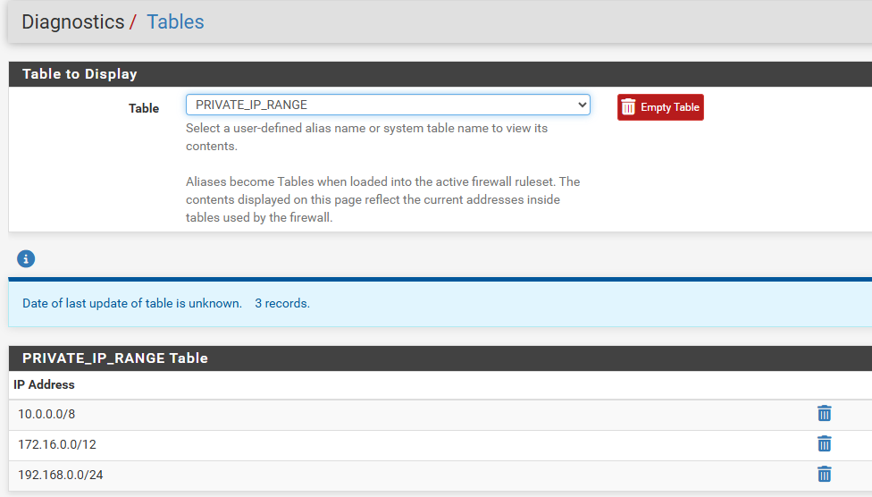

        SteveITS Rebel Alliance @eeebbune
        @eeebbune check Diagnostics>Tables.

          • E Offline
            eeebbune @SteveITS
            @SteveITS Hello SteveITS,
            I got correct results from tables. Would it be related any advanced settings such as table size..?

              eeebbune @patient0
              @patient0 Hello,
              I tried Chrome, Edge, Opera and issue was same even after I cleaned up my web cache too.
              I attached alias - PRIVATE_IP_RANGE, but all of my alias has same issue.
              I can't see all Alias details what I created.
              Is there anything I can try..?
              Thank you,
