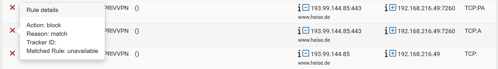

      Lately I see those a lot. Is this an expected log entry with 25.07.1?
      It is not related to UPnP. And It is not after a restart, no rule has changed.
      Edit: Thinking about it more, it could be related to "Use sticky connections"... does this make sense?
      • stephenw10S Online
        Hmm, not really something I'd expect to see. That traffic is simply out of state TCP stuff so it would normally be blocked by the default IPv4 block rule.
        Do you have a custom block rule on that interface?
            How old are those logs?
            The most likely think is that the ruleset did change since those were created so it's failing to lookup the rule that triggered it.
            You might be able to see it if you switch the log view to 'raw'.
