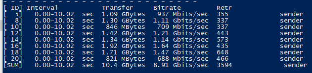

                            Did a quick test in my work lab today.
                            • Host is ESXI on a 40-core DELL with 192GB memory & 10TB SSD.
                            • PfSense 2.7.2 running in ESXI with 10G interfaces. WAN Public IP connects to an external Juniper MX80 router.
                            • Another interface on the MX80 has our speedtest server with iperf3 running under Ubuntu.
                            • Client PC is windows10 VM with 12 CPU & 32GB memory.
                            So iperf3 traffic goes as follows, and achieves about 8-9Gbps.
                            Client-VM <--> PfSense <--> MX80 <--> iperf3_Server.
                            Downstream Test.
                            [ ID] Interval Transfer Bitrate Retr
                            [ 5] 0.00-10.01 sec 1.43 GBytes 1.23 Gbits/sec 1279 sender
                            [ 5] 0.00-10.00 sec 1.43 GBytes 1.23 Gbits/sec receiver
                            [ 7] 0.00-10.01 sec 1.74 GBytes 1.49 Gbits/sec 408 sender
                            [ 7] 0.00-10.00 sec 1.74 GBytes 1.49 Gbits/sec receiver
                            [ 9] 0.00-10.01 sec 1.77 GBytes 1.52 Gbits/sec 604 sender
                            [ 9] 0.00-10.00 sec 1.77 GBytes 1.52 Gbits/sec receiver
                            [ 11] 0.00-10.01 sec 1.01 GBytes 868 Mbits/sec 480 sender
                            [ 11] 0.00-10.00 sec 1.01 GBytes 866 Mbits/sec receiver
                            [ 13] 0.00-10.01 sec 1.78 GBytes 1.52 Gbits/sec 777 sender
                            [ 13] 0.00-10.00 sec 1.77 GBytes 1.52 Gbits/sec receiver
                            [ 15] 0.00-10.01 sec 881 MBytes 739 Mbits/sec 838 sender
                            [ 15] 0.00-10.00 sec 879 MBytes 738 Mbits/sec receiver
                            [ 17] 0.00-10.01 sec 1010 MBytes 847 Mbits/sec 522 sender
                            [ 17] 0.00-10.00 sec 1007 MBytes 845 Mbits/sec receiver
                            [ 19] 0.00-10.01 sec 908 MBytes 761 Mbits/sec 1038 sender
                            [ 19] 0.00-10.00 sec 904 MBytes 759 Mbits/sec receiver
                            [SUM] 0.00-10.01 sec 10.5 GBytes 8.98 Gbits/sec 5946 sender
                            [SUM] 0.00-10.00 sec 10.4 GBytes 8.97 Gbits/sec receiver
                            Upstream (without -R) only gets about 4-5Gbps, so not sure about that.
                            Note: this was a quick & dirty test with no optimisation of the ESXI 10G virtual NIC's etc, and no packages, limiters, etc on PfSense. Will upgrade to 2.8.x and see what happens.

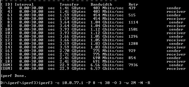

                            • P Offline
                              pwood999
                              Upgraded to 2.8.1 but no real difference. with GUI logged in I'm getting about 4.5-4.7Gbps Upstream, but with GUI logged out it increases to 5.1Gbps.
                              DS is the same at just over 9Gbps.

                                    @Laxarus I suspect it's a limitation on the iperf server. I tried WinVM to PfSense and get around 7.5-8.5G both ways.
                                    PFsense client to the server seems limited on upstream to about 6Gbps. Not sure why yet, because we definitely got 8.5Gbps symmetric over XGS-PON using the same server. [UPDATE] just tried another Ubuntu VM with direct connection to the Juniper MX80 and that gets 8.7-9.4Gbps both ways with iperf3.
                                    When I'm next in the Lab, I plan to connect our Excentis ByteBlower to the PfSense and try that. Much better traffic generator than iperf3, and I can then try UDP / TCP at various DS & US rates individually & simultaneous. It also allows me to set the packet payload to ensure no fragmentation

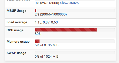

                                      Another thing I noticed when running iperf for 30 seconds, is the PfSense CPU ramps up in stages. It goes to 27% after about 5secs, and then 45% 5 secs later, and finally about 80% for the remainder of the run.
                                      Try adding this option "--get-server-output" and check the retries on the packet flows. That will reduce the effective data payload bitrate.
