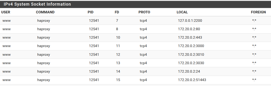

          it looks like this:
          172.20.0.2 is the WAN IP, sure. The various ports belong to various HAproxy-Frontends.
