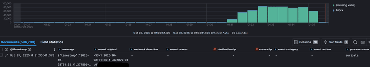

          Unfortunately BSD Syslog truncates messages to 760 Bytes. so this will not always work. Also when testing I did not get Suricata to log JSON into syslog.
          • B Offline
            b3rt @Greyhat
            @Greyhat
            I think it's useful to work with what we've got and figure something out for the (i hope) edge cases later.
            So for the JSON I figured you can actually use an existing suricata integration by co-opting their pipelines.
