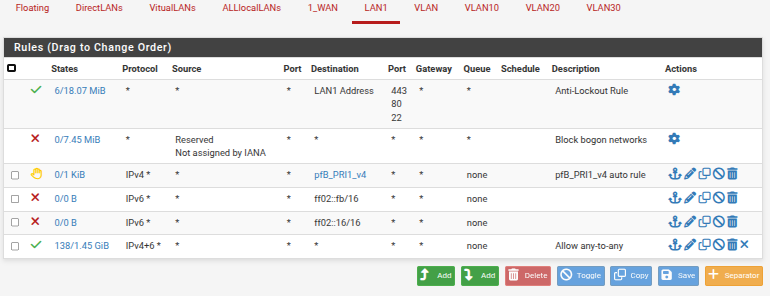

      I have tried to create a 'rule' so 5353 port activity on the LAN1 is not logging,. by not checking the last log box in the create rule form.
      my Rules look as follows:-
      ![alt text](Screenshot from 2025-11-01 16-58-59.png )

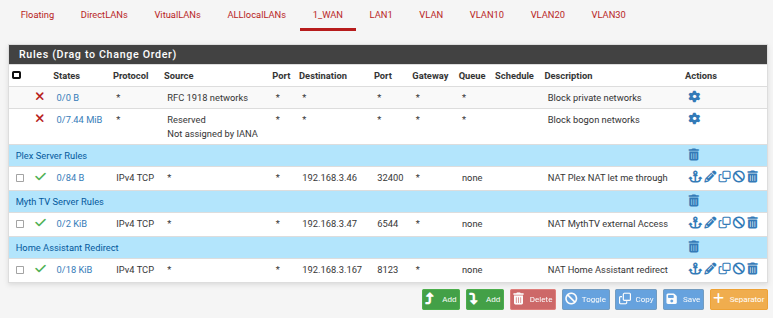

      I'm not sure it is required,. but for complete sharing these are my WAN rules:-
      ![alt text](Screenshot from 2025-11-01 17-03-03.png )

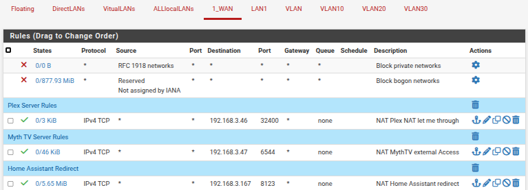

            my WAN rules are now as follows:-
            Screenshot from 2025-11-02 13-54-49.png)

            Now I am still getting
            Nov 2 13:57:40	LAN1	[fe80::22df:b9ff:fe5a:3da8]	[ff02::16]	Options
            Nov 2 13:57:40	LAN1	[fe80::2f6:20ff:fee7:be74]	[ff02::16]	Options
            Nov 2 13:59:05	LAN1	[fe80::d6f5:47ff:fe46:6d0a]:5353	[ff02::fb]:5353	UDP
            Nov 2 13:59:04	LAN1	[fe80::d6f5:47ff:fe56:b44c]:5353	[ff02::fb]:5353	UDP
            I understand my rules are a little open on the LAN side,.. but even though the packets are being analysed, they do not evaluate as 'true',.. I assume ff02::16 and ff02::fb could be simplified to just ff02:: but as I am struggling to get a match,.. I have left as this,.. I appreciate the protocol will need to be UDP,.. but I am not even capturing it as *...

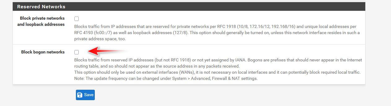

              Go to your interface lan1 and uncheck this

                    Tx Guys,...
                    Found this post which fixed my in-ability to disable bogon..
                    disable bogons
                    Have now turned off bogon,.. and see where we go now... and reverted back to no IPv6
