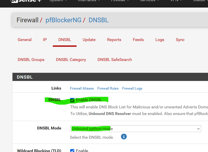

                        Gertjan @netboy
                        @netboy
                        Things you can test :
                        Leave pfBlockerng enabled, but :
                        Remove all IP lists.
                        De activate all DNSBL lists : you can do that by un checking :
                        Btw : You use the "Unbound Python mode", right ?
