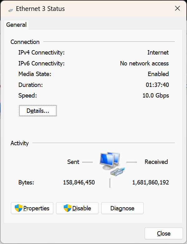

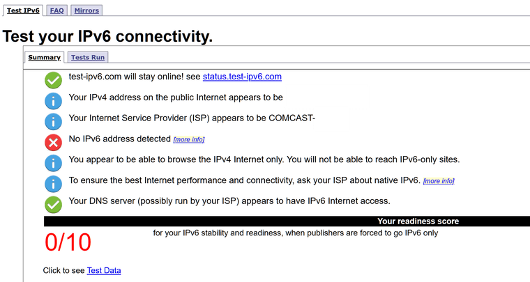

      pfSense+ user here. IPv6 stopped working on all my Windows 10 & 11 clients. I'm not sure exactly when it stopped. It used to work fine. It might have been when I upgraded to 25.07.1, which I did maybe a month ago. I was on a 2024 release before.

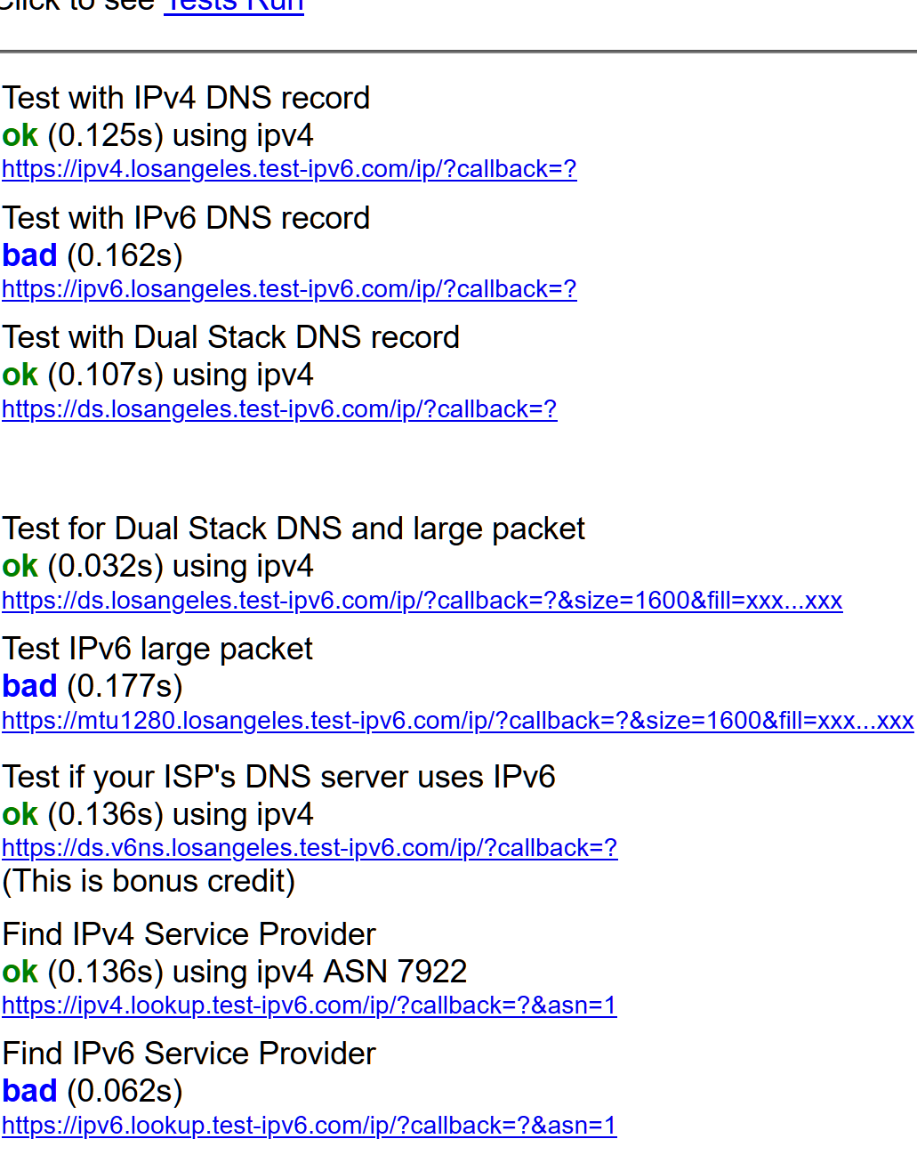

      test-ipv6.com shows the following on one host :
      Adding details :

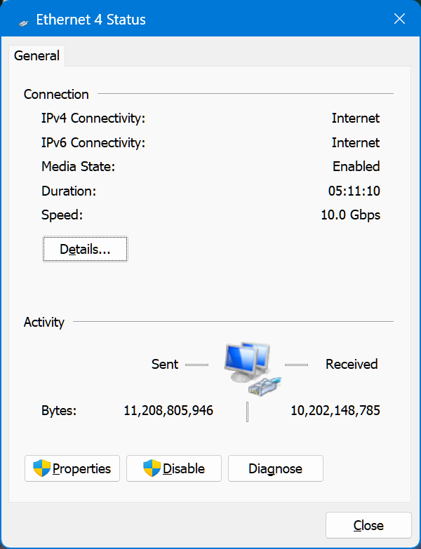

      ipconfig shows :
      Ethernet adapter Ethernet 4:
         Connection-specific DNS Suffix  . : localdomain
         IPv6 Address. . . . . . . . . . . : 2601:646:8200:reda::cted
         IPv6 Address. . . . . . . . . . . : 2601:646:8200:reda:cted:reda:cted:reda
         Temporary IPv6 Address. . . . . . : 2601:646:8200:reda:cted:reda:cted:reda
         Link-local IPv6 Address . . . . . : fe80::e280:2f0d:3e3f:a2%13
         IPv4 Address. . . . . . . . . . . : 192.168.100.109
         Subnet Mask . . . . . . . . . . . : 255.255.252.0
         Default Gateway . . . . . . . . . : 192.168.100.1

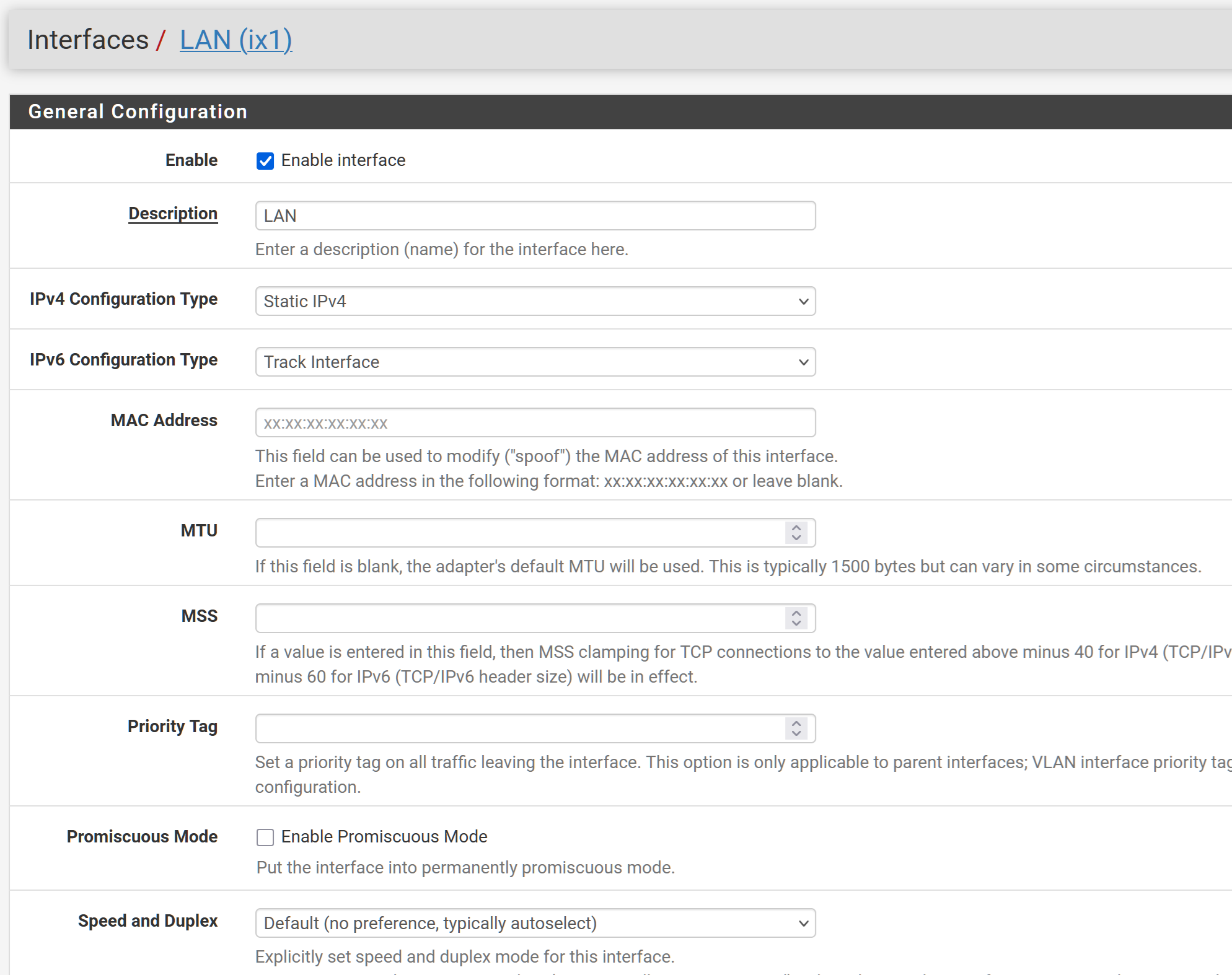

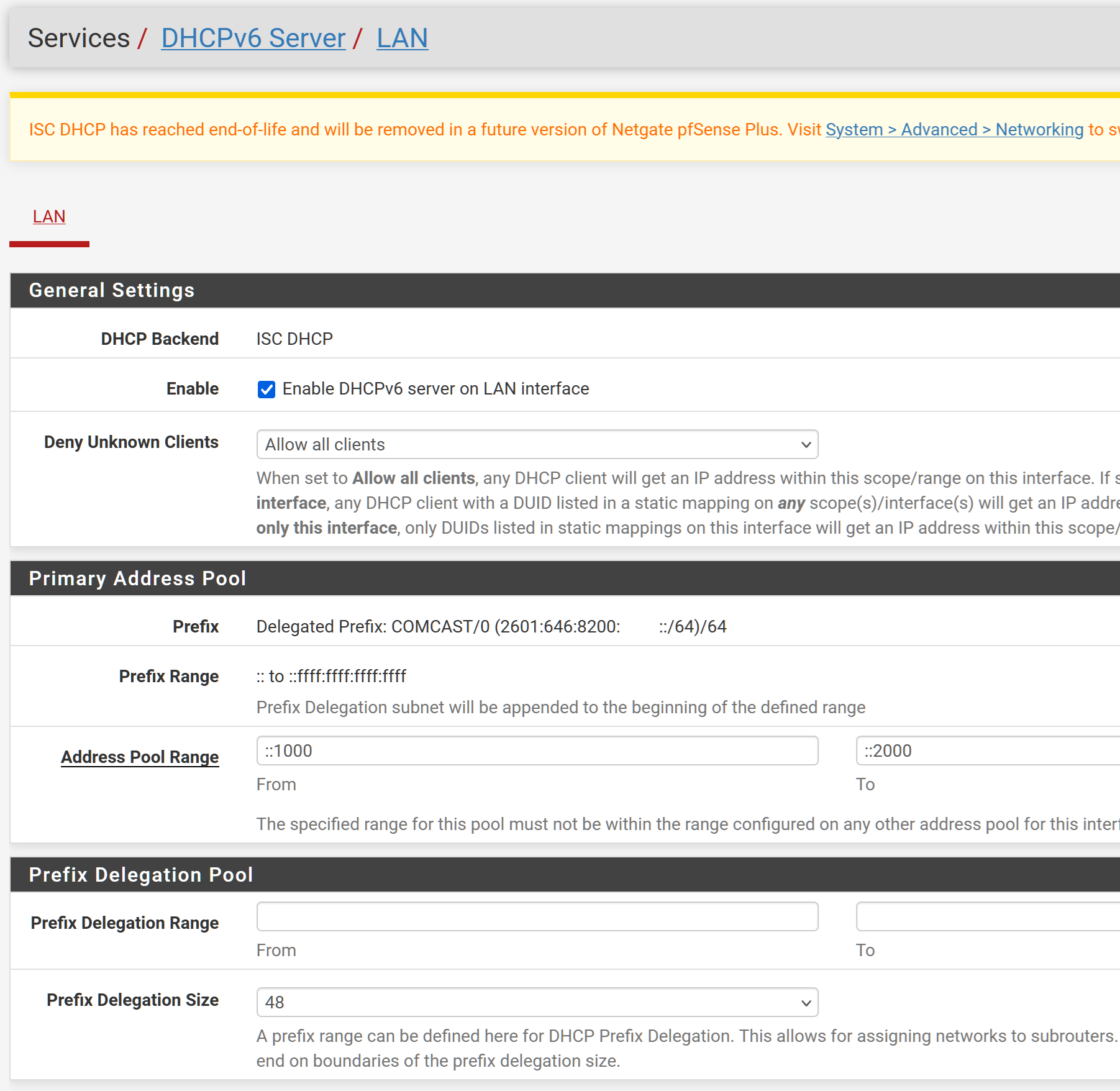

      I have not changed any IPv6 related settings in pfSense recently.

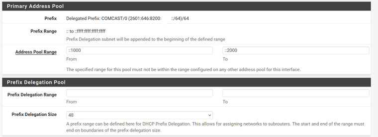

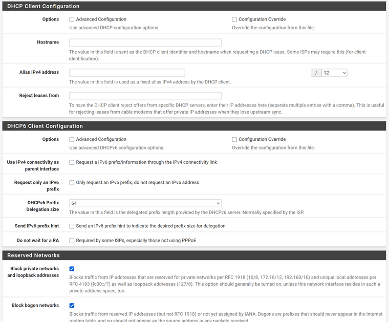

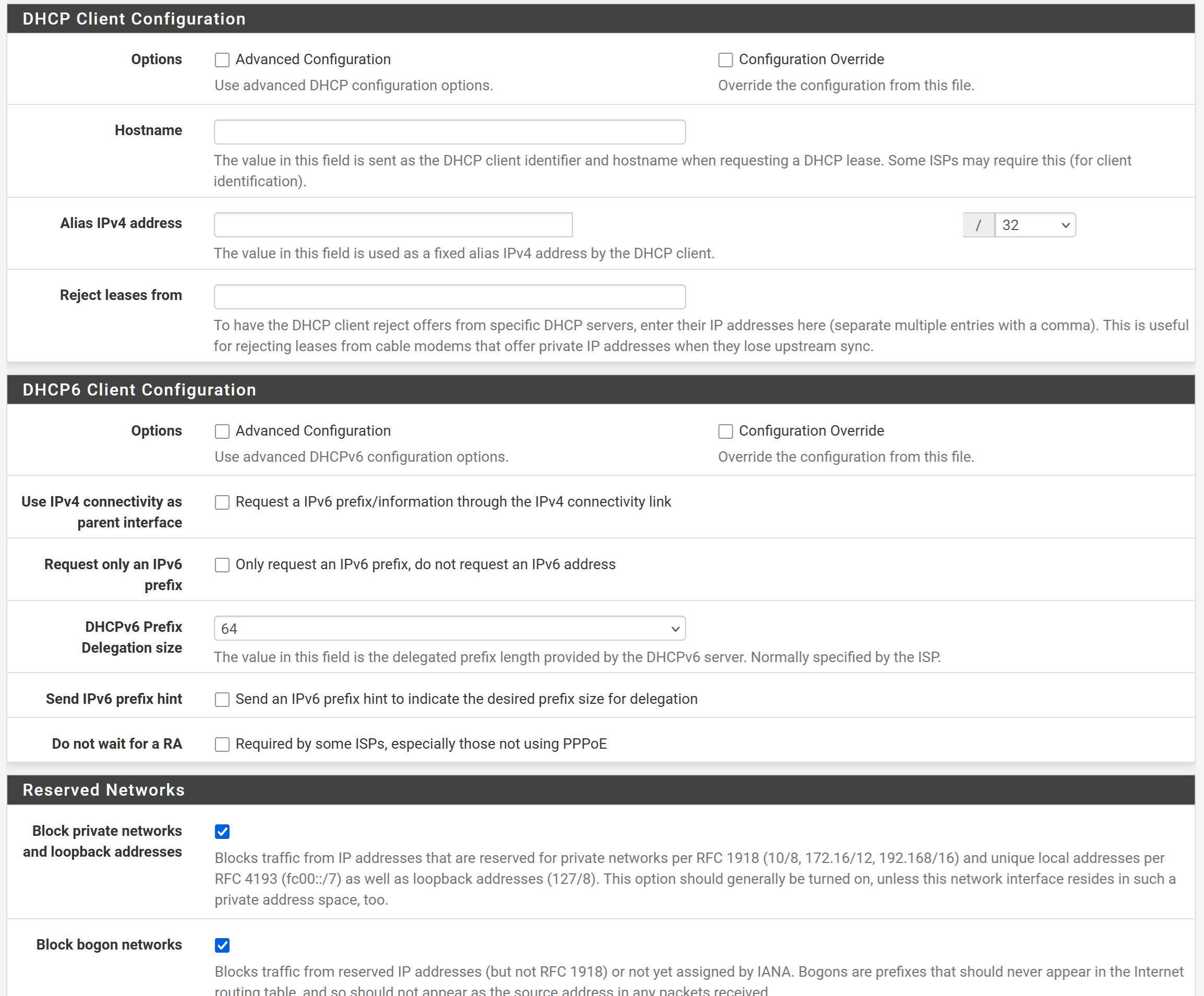

      Everything is pretty straightforward, using DHCPv6.
      Prefix delegation size is set to 64 .
      On the LAN side,

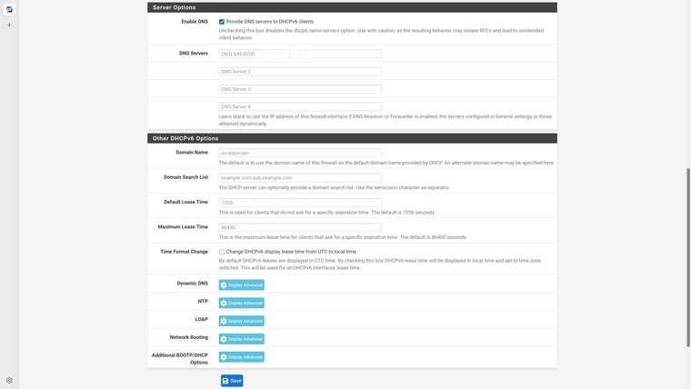

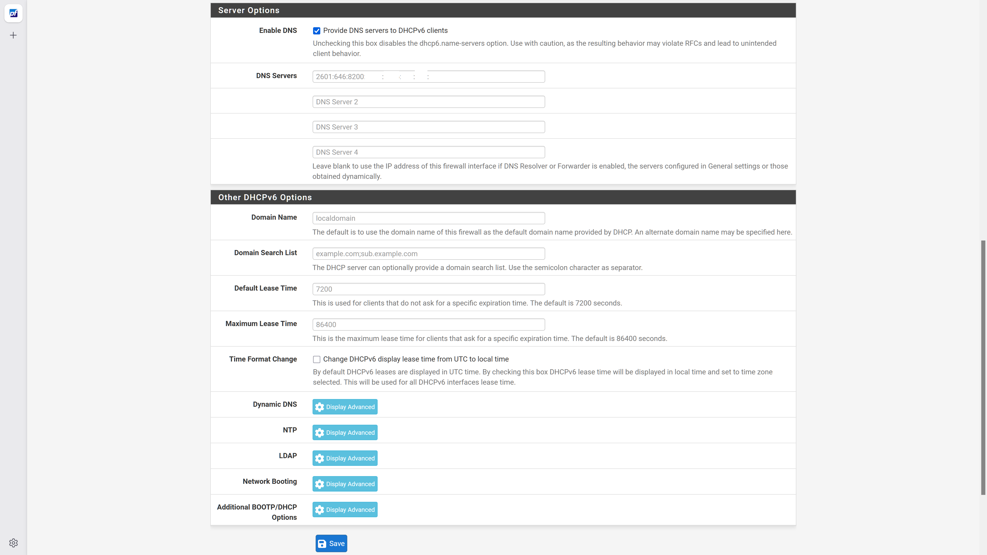

      ISC DHCPv6 server is enabled.
      No unusual server options - just "Enable DNS".

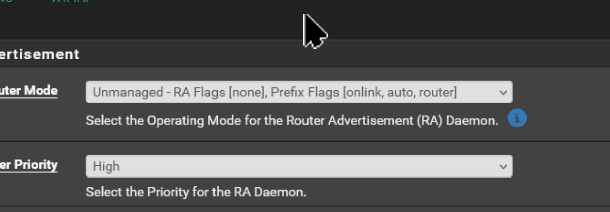

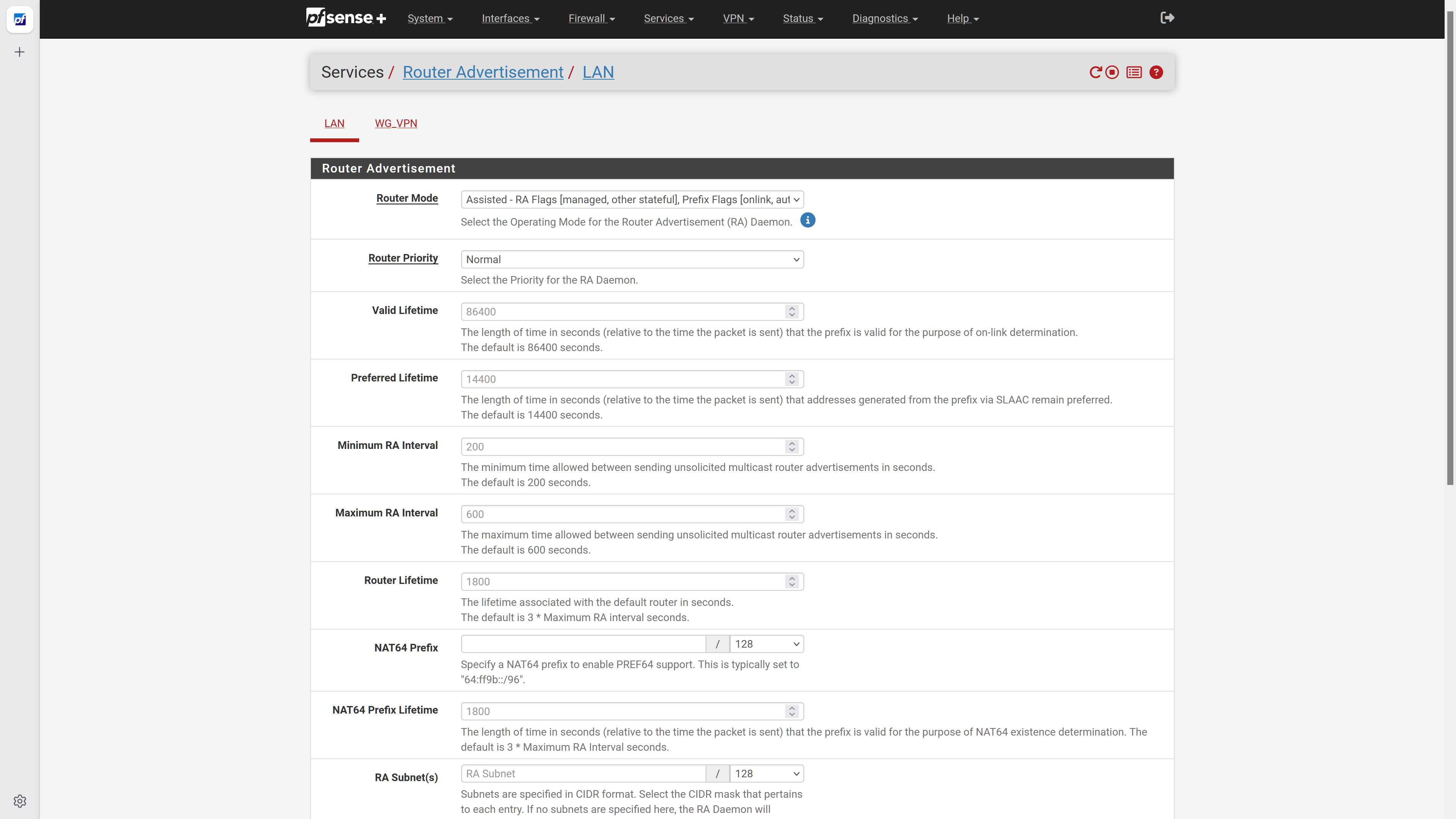

      RA configure is set to Assisted.

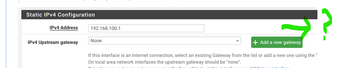

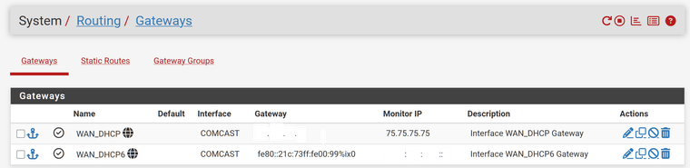

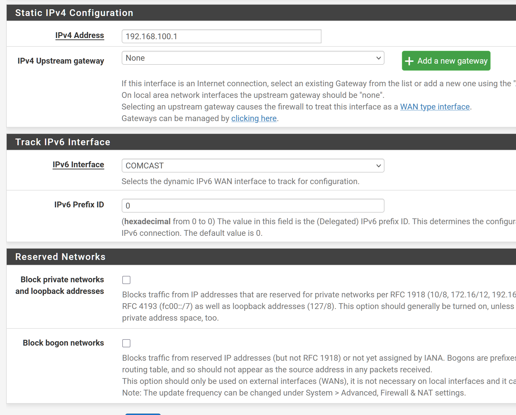

        You might try adding an IPv4 upstream gateway. Otherwise, there's no way to reach the Internet. When you click on the Add button, it will suggest your WAN gateway. Also, do you really have a static IPv4 address?
        UniFi AC-Lite access point
          madbrain @JKnott
          @JKnott

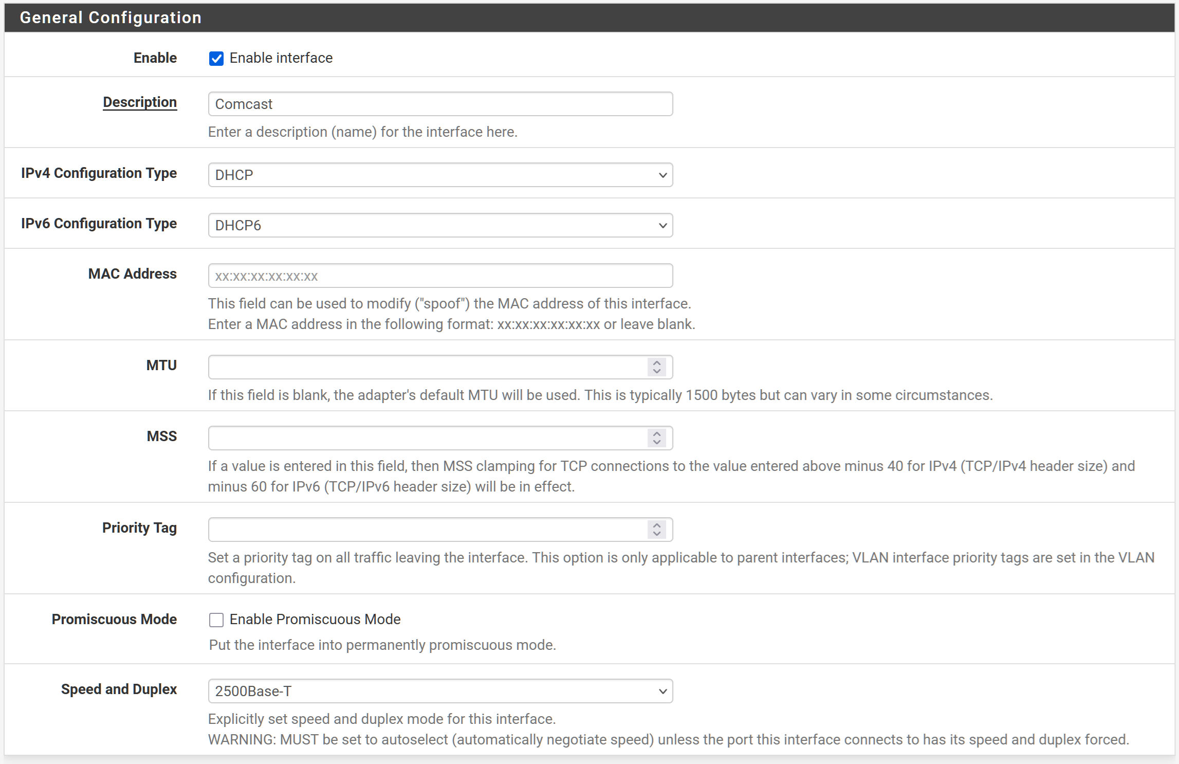

          I am not sure which "Add" button you mean. On which screen ?
          When I go to System / Routing / Gateways, I have 2 of them - one for IPv4, and one for IPv6.
          As far as the static IP address, that is for the LAN interface only. The WAN interface (COMCAST) is using DHCP for both v4 and v6.
          GertjanG JKnottJ 2 Replies Last reply Reply Quote 0

            You use pppoe ? If not, check here.
            The rest : all your IPv6 settings are identical to mine.

              • JKnottJ Offline
                JKnott @madbrain
                @madbrain said in Comcast IPv6 working on Linux clients, but not Windows clients:
                Sorry, my mistake. I thought I was looking at your WAN config.

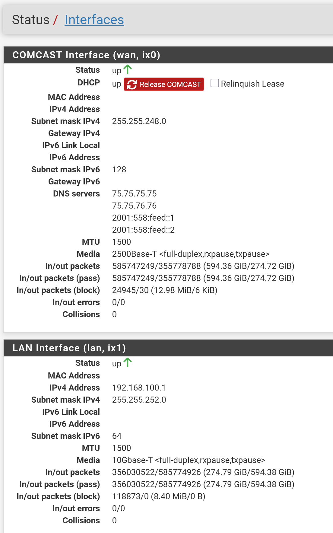

                  Since you have a working IPv6 config with your ISP, could you tell me what the Status / Interfaces screen looks like ? In particular, is there any mention of a Prefix ?
                  Mine has no mention of it. I see that the WAN "Subnet mask IPv6" is 128 .
                  And LAN "Subnet mask IPv6" is 64 .
                  Thanks in advance.

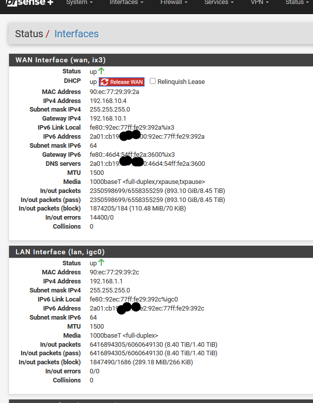

                    Gertjan @madbrain
                    @madbrain
                    Sure :
                    My WAN IPv6 sub net mask is (also) /64.
                    That is, imho, problematic.
                    The WAN interface IP is (also) part of a prefix, a /64 network.
                    As my pfSense is the only device connected to my ISP router, it uses just one IPv6 out of the 2^64 avaible IPv6 addresses (what a waste ^^). My ISP box uses also a IPV6 in that same network - it's the gateway IPv6 of my pfSense : it could have been ;
                    but no, its using
                    ( ok why not)
                    A bit like assigning a LAN IPv4 on your WAN with a /32 : that won't work neither.
                    JKnottJ M 2 Replies Last reply Reply Quote 0
                    • JKnottJ Offline
                      JKnott @Gertjan
                      @Gertjan said in Comcast IPv6 working on Linux clients, but not Windows clients:
                      That's entirely normal. The /128 address is used only to provide an address for the interface. It is not used for traffic passing through pfSense. There's a /64 unique local address for that.
                      BTW, a LAN, any LAN, is normally a /64. Anything else would break things like SLAAC. This also applies to the WAN interface. The exception would be things like point to point links.

                        Good to know what to expect when it's working. However, the fact that you only have a single device connected to pfSense may mean that it isn't a fully working configuration. Is that device a Windows machine using Prefix delegation, or Linux system using SLAAC ? Or something else ?
                        A /128 might work if you have a single client device connected, but not for multiple devices.

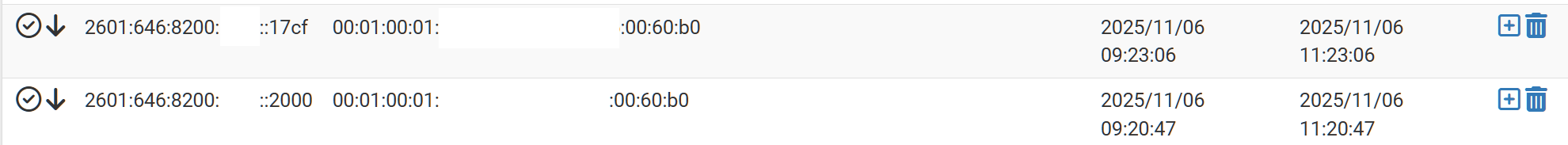

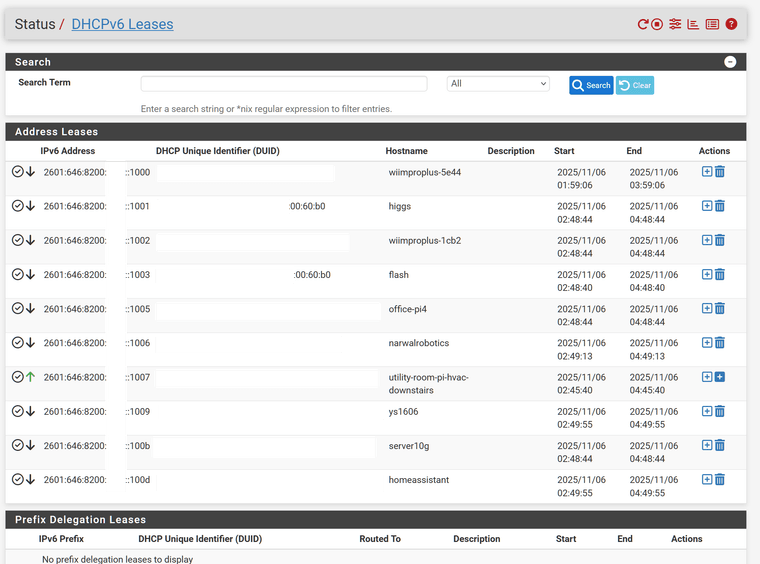

                        Could you please take a look at "Status / DHCP6 leases" ?
                        I have many "Address leases" under that screen. But nothing under "Prefix delegation leases".
                        JKnottJ GertjanG 2 Replies Last reply Reply Quote 0

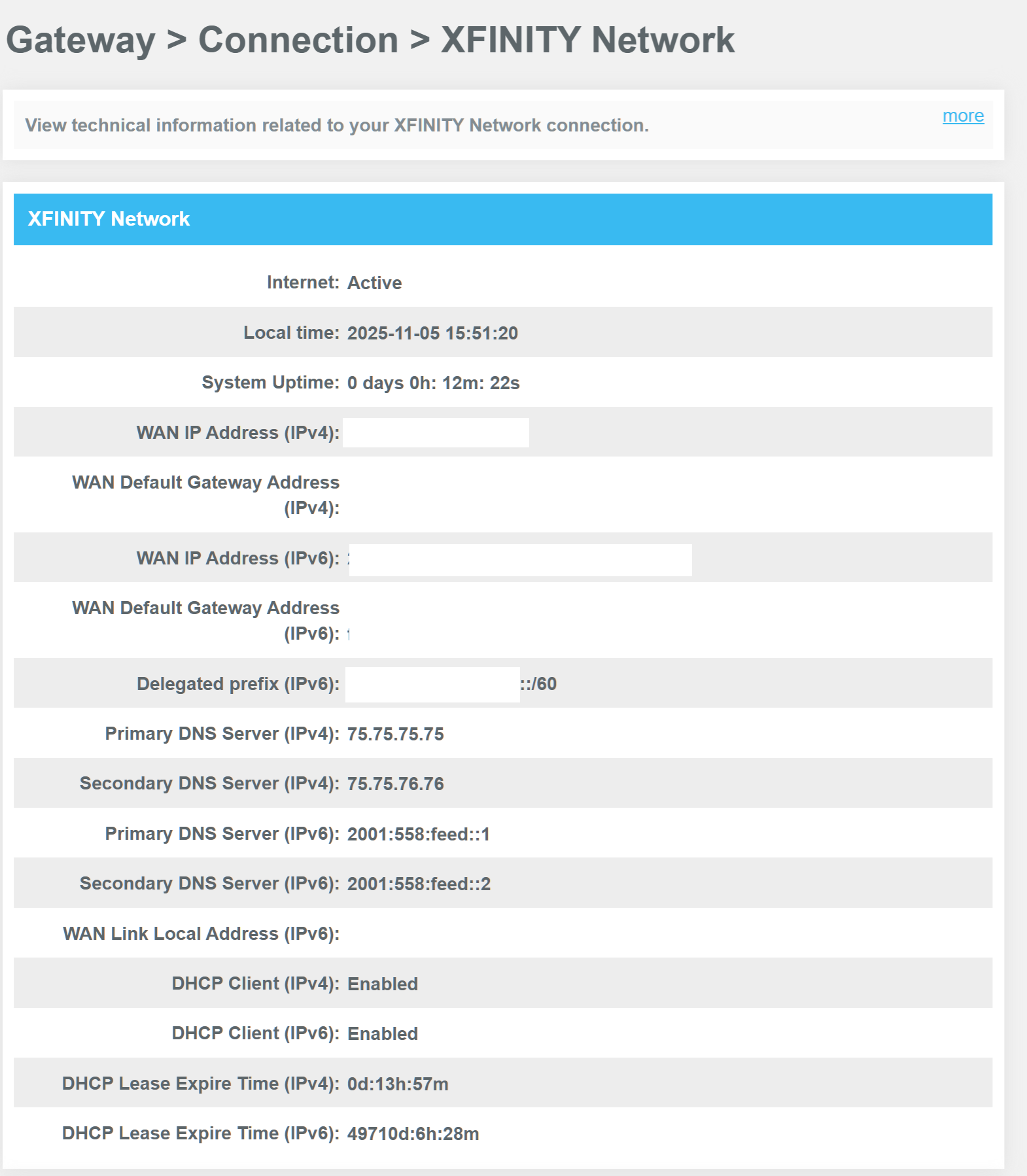

                          1. I spent some time bypassing pfSense altogether yesterday, switching the Comcast XB8 from bridge mode to router mode. I had to change the IPv4 subnet from a /24 to /16 - nothing offered in between by Comcast.
                          The Xfinity network information showed that there was a /60 assigned for IPv6.
                          Even then, I observed the same random behavior with Windows systems - some with working IPv6, some not. But it did not last.
                          I'm going to take another stab at bypassing pfSense. Maybe even factory reset the XB8.

                                Most routers I have used before default to 192.168.1.1, not 192.168.100.1, which is what I have set for pfSense.
                                The XB8 gateway defaults to 10.0.0.1 with a /24. I confirmed that is the default after doing a factory reset. I was also able to change it to a /16, and my LAN functioned fine with IPv6 for all clients, both Windows and Linux. No inconsistent behavior.
                                When setting the XB8 to bridge mode, its web admin UI continues to be accessible at 10.0.0.1 . However, once I switched to using pfSense as router, the problem with Windows clients not having IPv6 occurred again. The weird thing is that it worked fine for one Windows client in the first few minutes after pfSense and router booted up. Then it stopped working shortly after when I repeated the test a few minutes later. While it worked, I looked at status / DHCPv6 leases, and there were no Prefix delegation leases.
                                So, the issue appears to be specific to pfSense. Not sure what setting it could be that's breaking it.
                                Here is what the XB8 admin UI shows for the "Xfinity network" page. It looks like it's using a /60 .

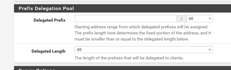

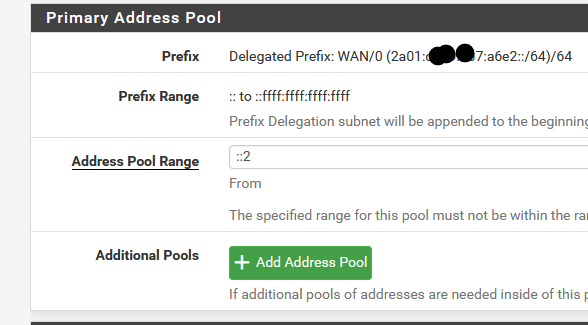

                                          pfSense would lease out 'entire' prefixes if you have a DHCPv6 capable router on a pfSense LAN.
                                          This router would have a IPv6 address on it's WAN side.
                                          And would typically ask for an /64 prefix for every LAN it has. Exactly like pfSense does.
                                          The pfSense DHCPv6 would not only handle IPv6 leases, out of one prefix pool :
                                          It also has to be set up to have a 'pool' of available prefixes, so it can give these /64 to any downstream 'sub routers' :
                                          pfSense handling the delegation of prefixes is ... afaik, a very rare situation.
                                          Are you sure you want to "Prefix delegation leases" with pfSense ?
                                          After rebooting all network equipment, a couple of Windows systems did have working IPv6 initially, about 5 minutes after booting up. Then, subsequently, IPv6 stopped working for them, as reported in my OP.
                                          No need to keep the 'not working' state.
                                          Ask your system why ?!
                                          Type
                                          ipconfig /all
                                          and you can see for yourself :
                                             IPv6 Adress. . . . . . . . . . . . . .: 2a01:cb19:907:a6e2::c7(prefered)
                                          How long does the DHCPv6 last ?
                                          Answer :
                                          netsh interface ipv6 show addresses
                                          For example :
                                          Dhcp       Prefered   5h14m22s   2h25m37s 2a01:cbxx:xx7:a6e2::c7
                                          so my lease stays valid for 314 minutes and 22 seconds. If all goes well, it (Windows) will renew this lease before this lease expires **.

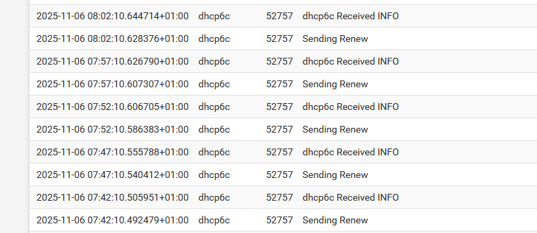

                                          On the pfSense side, the same lease :
                                          Take note : I'm only using DCPv6 for my network LAN network, as all these devices are 'known' to me, these are mostly all IPv6 capable devices. All devices have a 'static DUID DHCPv6' setup.
                                          Something that annoys me for, not sure, months now, maybe a bit more then a year (since kea ?) :
                                          It happens that Windows devices do not, for some reason, renew their IPv6 lease in time. The IPv6 becomes "depreciated" as the lease time expires.
                                          Why the dhcpv6 client daemon doesn't renew in time, I can't tell.
                                          A quick
                                          ipconfig /renew6
                                          on that Microsoft device will deal with it, but still, this is awkward.

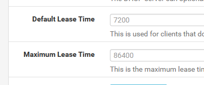

                                          The lease times on the pfSense side :
                                          or 2 hours if the client didn't specify a lease duration.
                                          and 24 hours or 1440 minutes maximum.
                                          If none of this works consistently, it looks like I need to reach out to Comcast.
                                          Who handles the DHCPv6 in front of pfSense ?
                                          The ISP box at your place ?
                                          Further above ?
                                          Do you see this in the pfSense DHCP log :
                                          which tells me the DHCPv6 pfSense WAN IP has a lease time of 10 minutes.
                                          The pfSense DHCPv6 WAN client renews every 300 seconds or 5 minutes.
                                          Afaik, the prefixes are also renewed at that time. And hopefully, they 'stay the same' ^^ - mine always stay the same, as I can see them allocated to pfSense in my ISP router.
                                          M 2 Replies Last reply Reply Quote 1
                                            madbrain @Gertjan
                                            @Gertjan
                                            Thank you very much for this. I had not checked the "Primary address pool" section. This is what it shows.
                                            The UI is slightly different, possibly because I'm on pfSense+. But I believe the settings are the same.
                                            I'm typing this on a Windows machine on which IPv6 is currently working. Your netsh command shows this :
                                            Interface 12: Ethernet 4
                                            Addr Type  DAD State   Valid Life Pref. Life Address
                                            Dhcp       Preferred      1h26m7s      41m7s 2601:646:8200:xxxx::xxxx
                                            Temporary  Preferred    23h56m33s   3h56m33s 2601:646:8200:xxxx:xxxx:xxxx:xxxx
                                            Public     Preferred    23h56m33s   3h56m33s 2601:646:8200:xxxx:xxxx:xxxx:xxxx:xxxx
                                            Other      Preferred     infinite   infinite fe80::xxxx:xxxx:xxxx:xx%xx
                                            I don't have any static mapping for DHCPv6 clients. How did you add them ?
                                            It seems like a ton of work to manually undter a DUID and IPv6 address for each of my devices. I wouldn't know the right value to enter. I'm not even certain how many of the 350 support IPv6 or not. Can this really not be made to work automatically ?
                                            Simultaneously, on another Windows host on the same LAN, test-ipv6 is not working. The netsh command on that box shows :
                                            Interface 18: Ethernet 3
                                            Dhcp       Preferred     1h30m55s     45m55s 2601:646:8200:xxxx::xxxx
                                            Public     Preferred    23h53m23s   3h53m23s 2601:646:8200:xxxx:xxxx:xxxx:xxxx:xxxx
                                            Temporary  Preferred    23h53m23s   3h53m23s 2601:646:8200:xxxx:xxxx:xxxx:xxxx:xxxx
                                            Other      Preferred     infinite   infinite fe80::xxxx:xxxx:xxxx:xxx%xx
                                            I'm not seeing a lot of difference in the format of those addresses between the 2 boxes. The non-working one has a longer "temporary" IPv6 address than the working one.
                                            As far as I know, the interfaces are configured identically on both machines as far as protocol settings.
                                            Working box :
                                            Non-working box :
