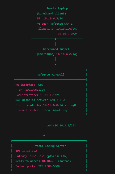

        @andresbraga can show a diagram of your network layout (hand-draw is ok)?

          Here it is the schema of the network:

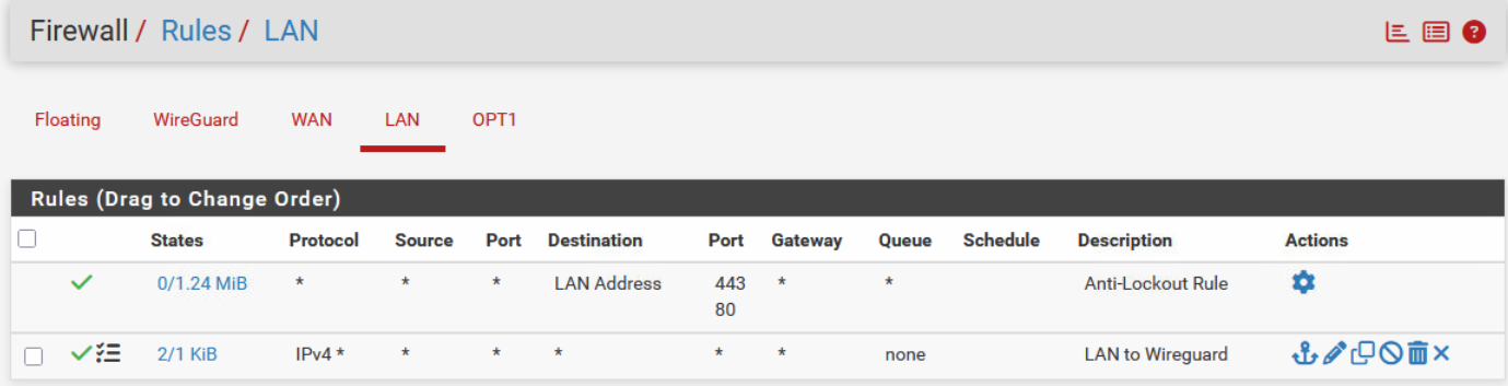

                Thew only rule that I have in LAN is this one:
                But now that you say it makes sense.

                  @andresbraga yep, the rules are (except on floating rules) working for traffic into an interface. 'into' LAN means traffic origination from LAN, for example. 'into' WIREGUARD would refer to traffic originating from the Wireguard interface.
                  Therefore you would need a rule or rules on the WIREGUARD interface for traffic originating from it.
                  Btw: have you cropped the LAN rules? There should be a 'Allow All' rule on the LAN interface (that is created by the installer).

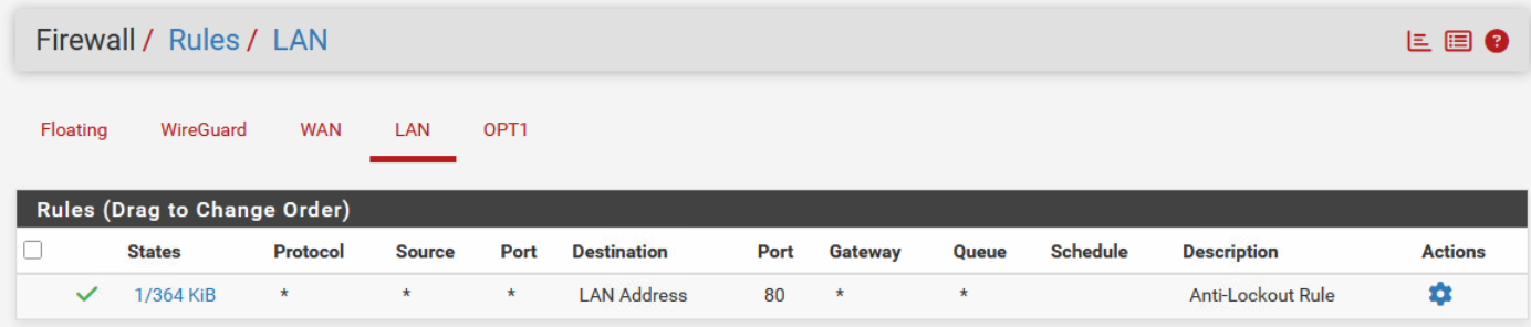

                    andresbraga @patient0
                    Hi again @patient0,
                    No, I didn't. An yeah I deleted all the rules here for this Wireguard tests.

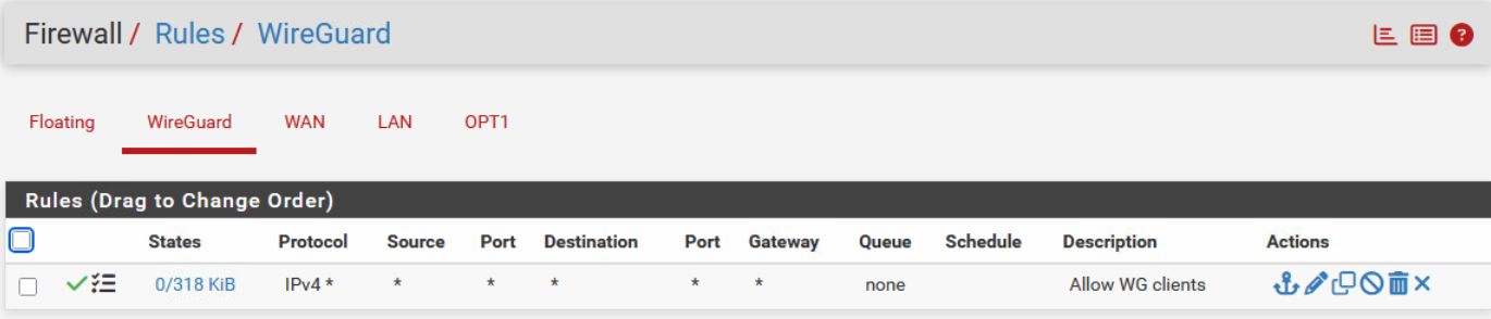

                      andresbraga @andresbraga
                      Also Wireguard, only this rule:
                      • patient0P Offline
                        patient0 @andresbraga
                        @andresbraga that looks good, the same is needed for LAN.

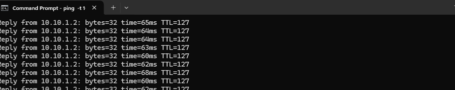

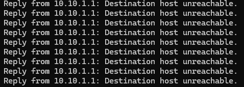

                          Laptop can ping the server in the pfsense network but not the Wireguard
                          Also, Server cannot ping the laptop but can ping the wireguard:
                          Any more suggestions? Thank you,
